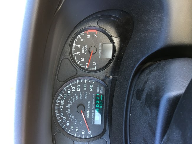

We have replaced the throttle body and the gas peddle and we still can not get the idle to go down under 1100 rpm`s even after going through all the step we were instructed to.

Okay, i did what you said. When i start it it goes up to about 2000 rpm's and drops down to about 900.

Yes but, shouldn't the idle for this car be between 600 and 700?

The idle will be whatever the engine computer wants it to be there is always a possibility of a failing motor in the cluster so the rpm is not reading correctly.

The needles in the dash display are little motors that go bad and do not give a smooth transition and get stuck at certain points.

The Idle is still about 850-900. Is that something that we should really worry about?

Is the check engine light gone ? It's hard to say if you should worry about it if there is no check engine light. At this point you would need a scan tool that can show the specified rpm vs the actual rpm to know if the module is commanding the system to hold the rpm there. We have a Monte Carlo in our shop. I'll compare.
Dec 27, 2016 at 3:33 AM
LOU P
  • 118 POSTS
Ours is right between 900-1000
Dec 27, 2016 at 4:05 AM
LOU P
  • 118 POSTS
After a few minutes of warm up we are at about 750-800
Dec 27, 2016 at 4:08 AM
LOU P
  • 118 POSTS
Honestly without a check engine light I would not worry about it. This one we have hear if you listen to the dash closely the motor for the needle is really loud and probably sticking. So actual rpm may vary. Hope this information helps.
