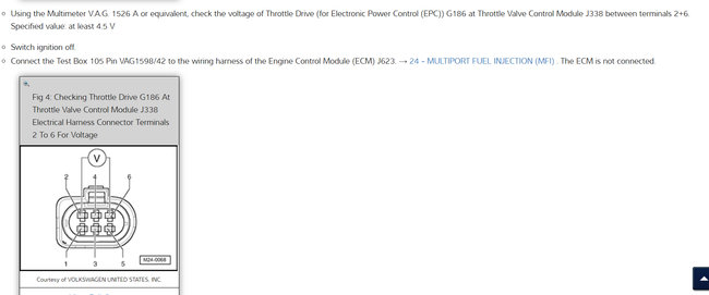

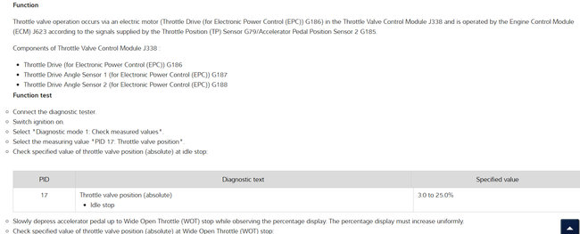

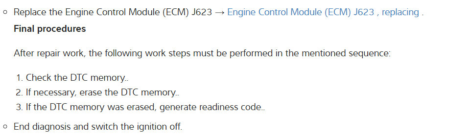

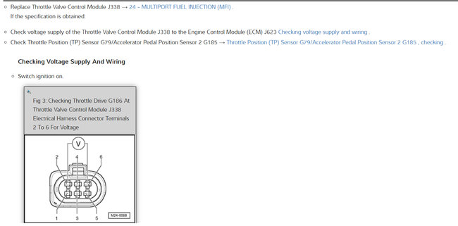

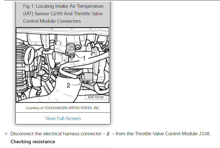

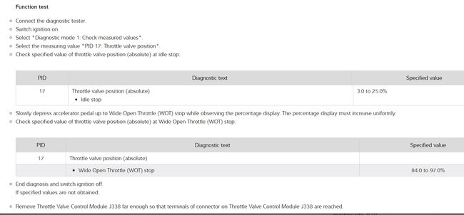

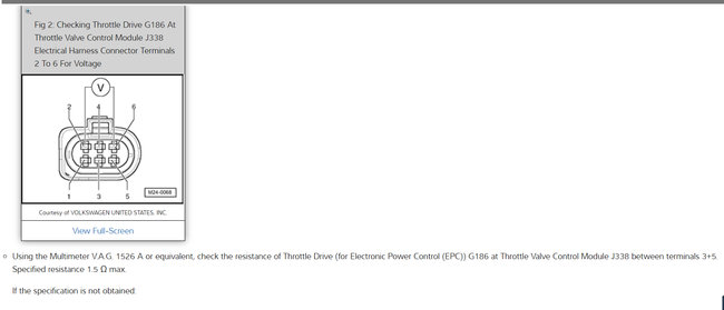

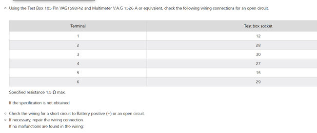

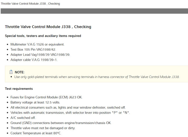

This sounds like a problem with your Idle Air Control (IAC) valve. I have included a link for down below to a guide and vehicle specific instructions for the IAC, but it requires some specific tools to go through it. Let us know what you find out.
