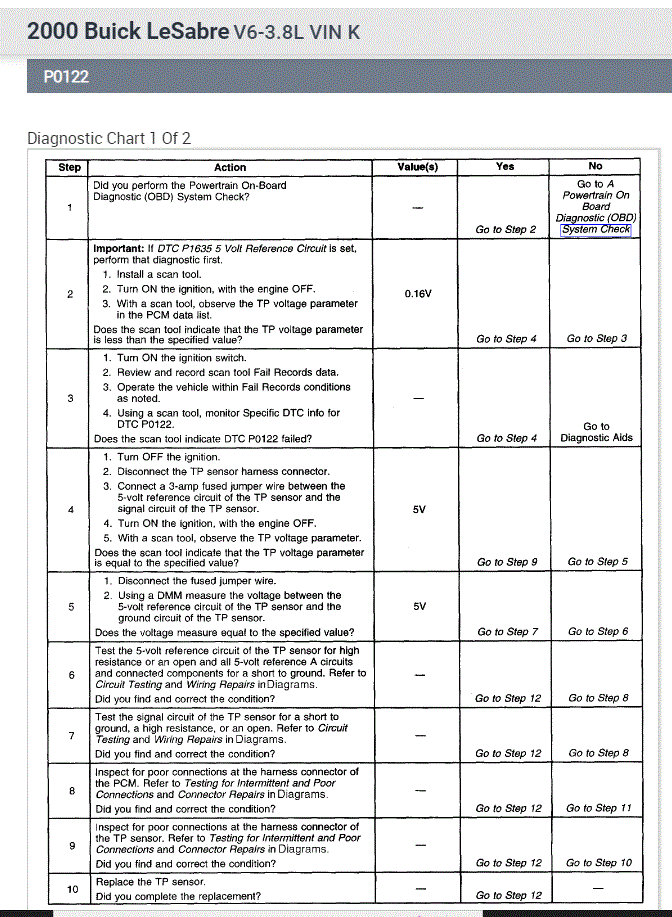

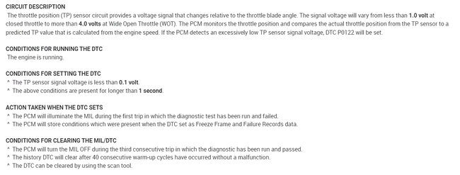

The P0122 is related to the throttle position sensor. There is a voltage variation that is outside the manufacturer's specifications.
Do me a favor. I believe you have a scanner. If so and it has live data, you should be able to perform the diagnostics for the code. I suspect the issue with the TPS is causing the idle and shifting issues.
Let me know if you feel comfortable performing the tests.
