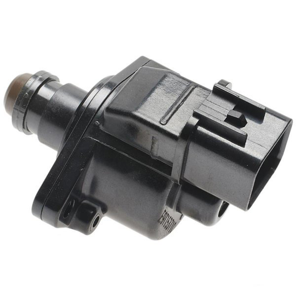

Believe I already resolved the problem. Found what appears to be a sticky IAC valve.
Took it apart, and the internal magnetic part seemed sticky...didn't spin freely.
turned it some, and put some WD Silicone spray around it...work it back and forth some.
Put the thing back on and seem to take care of the issue. Had to re-adjust the idle some.

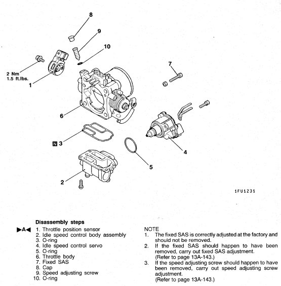

But can someone tell me how many turns the Idle Speed Screw should be turned out as a starting point once it has been fiddle with too. LOL. Throttle body pick, part number 9.

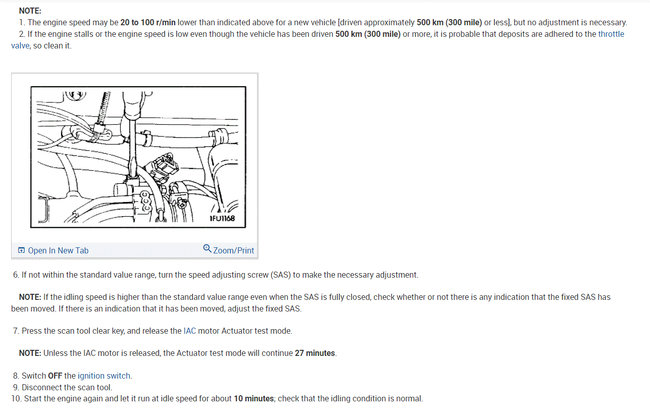

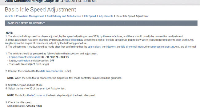

When I start adjustment, I go 1.5 turns out as a starting point.

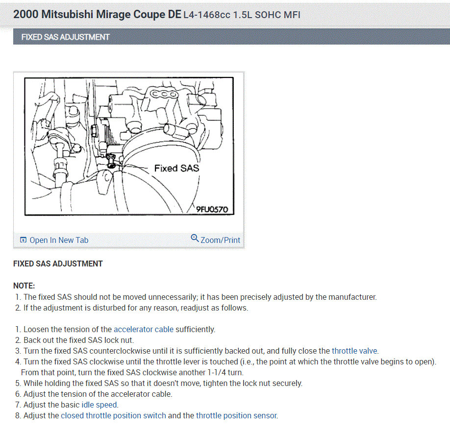

As far as this vehicle, if you look at the first two pics below, they provide the directions for basic idle speed adjustment. The last pic is for SAS adjustment (secondary air system). If no one has touched that adjustment, leave it alone. Otherwise, follow those directions.
