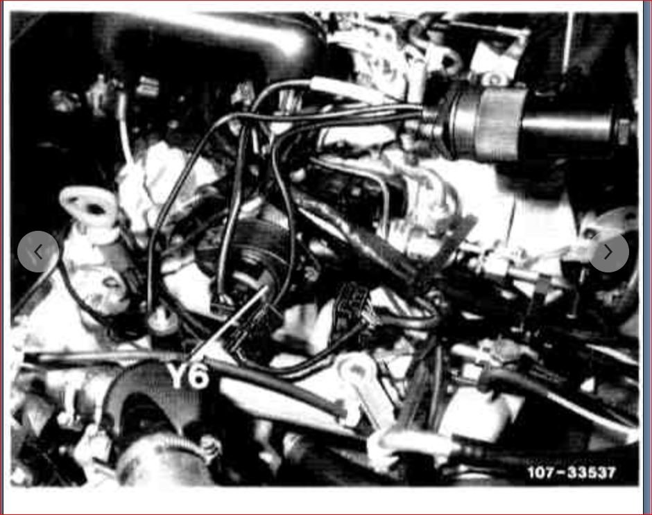

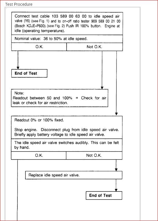

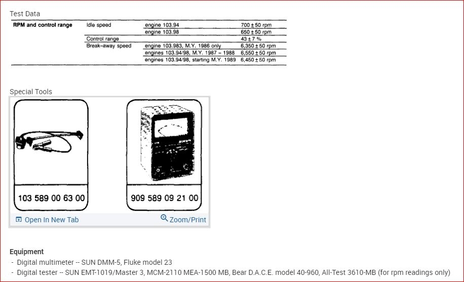

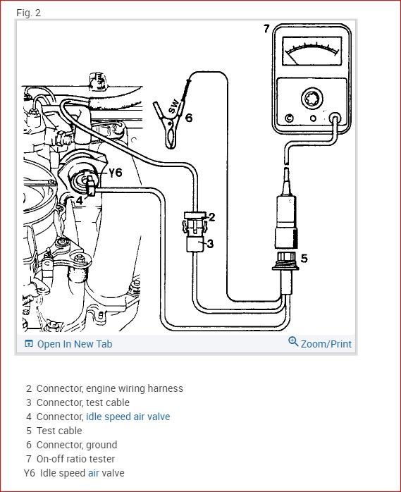

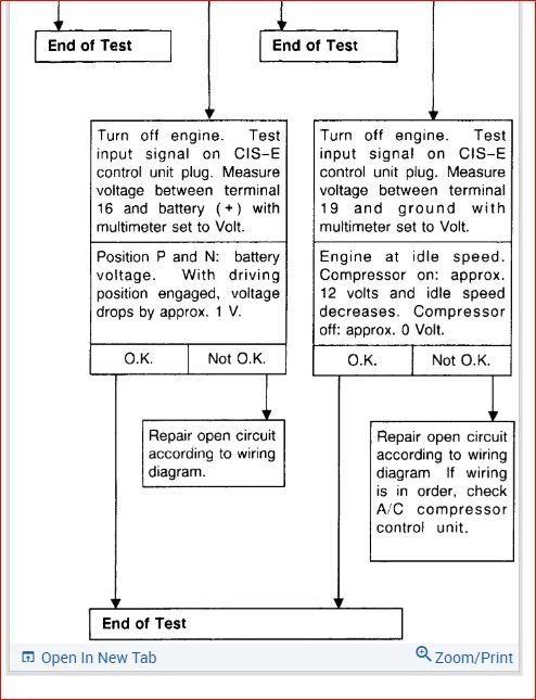

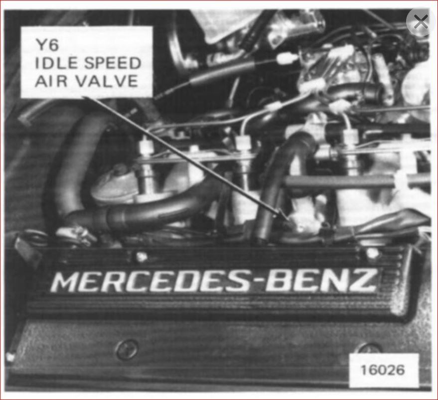

It is idling at 2,000 and clunks into reverse, just started.
Jun 1, 2019 at 5:14 AM
Hi Kayla,
More than likely you have a vacuum leak. However, you will want to run through some of the items on this list. The fact that it started all of a sudden it sounds like a vacuum hose started leaking.
Here are the guides that will help address it:
https://www.2carpros.com/articles/engine-idles-too-high
Let me know if you need anything else and I will be happy to assist. Thanks
