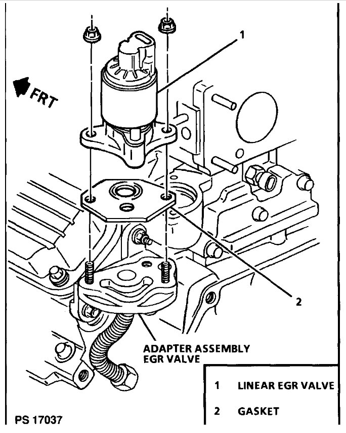

I have seen the EGR valve stick open and cause this problem. Also, here is how to run the codes for this car to see if any are stored:
https://www.2carpros.com/articles/buick-cadillac-chevy-gmc-oldsmobile-pontiac-gm-1983-1995-obd1-code-definitions-and-retrieval-method
This guide can help as well:
https://www.2carpros.com/articles/engine-idles-too-high
Here is the location of the EGR so you can remove it to see if it is leaking. These valves go bad btw. Check out the images (below). Please upload pictures or videos of the problem so we can see what's going on.

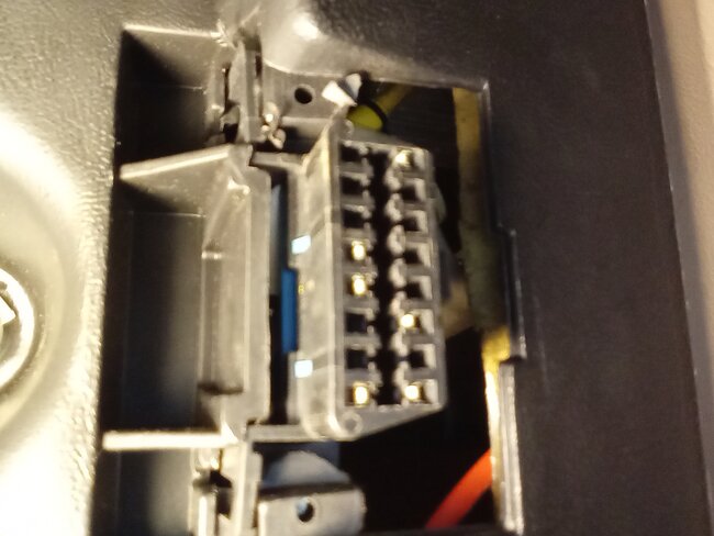

Ken, I tried the jumper wire test you were talking about but got no response from it when I switched the car on. The check engine came on but never flashed. I am going to try to send a video of the car running. You will see it idling at about 2,000 RPMs and go to 3,000 RPMs and I never touched the accelerator. I am also sending a photo of the 0bdi port. any other info i can get for you please let me know.
Dec 13, 2023 at 5:05 AM
  • 55,554 POSTS

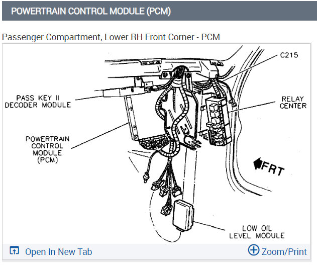

Thanks for the image and video they help, The PCM should have responded to one of the scan methods. Let's check fuse # 9C in the fuse panel on the left side of the dash and if the fuse is okay, it sounds like the PCM is bad so I would remove it to have it tested or replaced with a rebuilt unit. You can get a preprogrammed unit by searching Google or Ebay. Here is how to change the PCM out.
REMOVE OR DISCONNECT
^ Disable Supplemental Inflatable Restraint (SIR) system.
1. Powertrain Control Module (PCM) connectors.
2. PCM.
Pull bottom of PCM rearward over locking tabs and downward to remove.
INSTALL OR CONNECT
1. PCM into bracket, making sure PCM is up over locking tabs and locks into place.
2. PCM connectors.
Enable SIR system.
