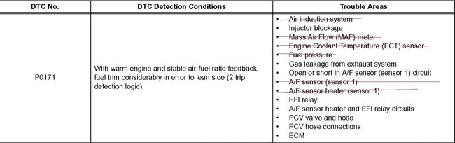

Since the fuel trims are high across all speeds it seems to me it must be either 1) a bad AFR sensor (changed), 2) a fuel delivery issue, 3) a massive air leak between MAF and cylinder, or 4) an air leak in the exhaust near the O2 sensor. This car has many miles (360,000). Any thoughts on items which could cause this issue?
Codes are lean engine (P0171).

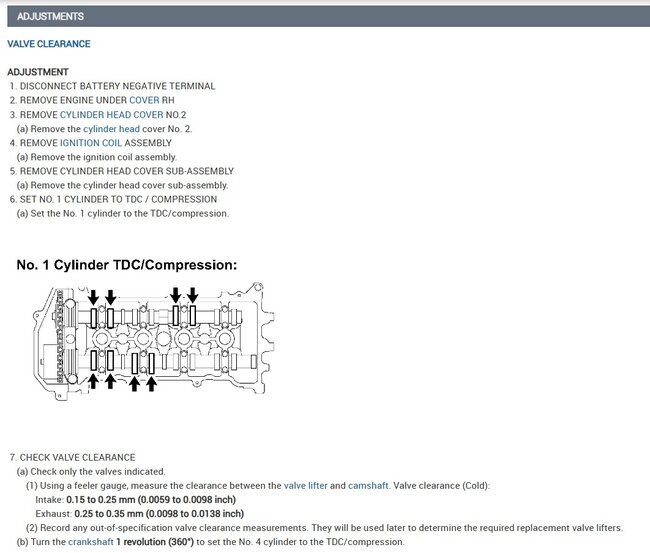

Interestingly though, there is a valve adjustment for this engine, it's the more difficult method of measuring and adding different size shims. But you could take the valve cover off and look for any worn cam lobes, after checking the back pressure and injectors. You might just be dealing with clogged injectors or a bad tank of gas, with everything you have already done, you're only left with a couple possibilities now. Harbor Freight sells a vacuum gauge that also measures positive pressure up to 10psi, that's what I use with an old 02 sensor bored out as an adapter to measure back pressure at the front 02 location. Just don't leave the gauge on there more than a few seconds to measure back pressure or it will melt the gauge. Hook it up, have someone else start the engine, check it at idle, and then have them try to rev it a couple of times while you monitor the gauge. then shut the engine off. You'll know right away if there is excessive back pressure.

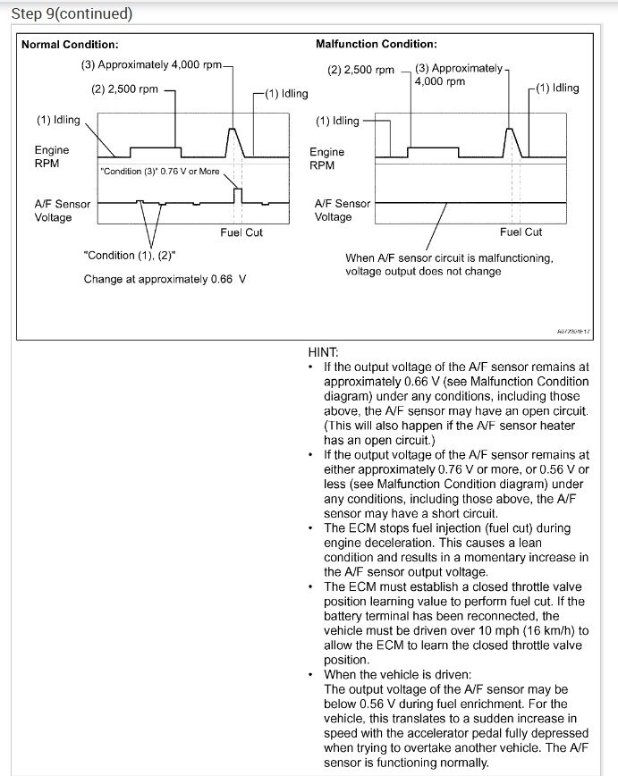

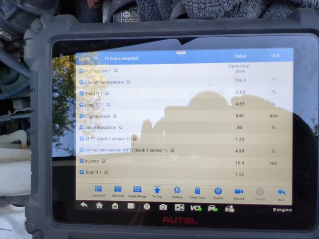

Just looking back over your list of repairs so far, you had listed the AF sensor as reading 1.23, is that milliamps?
And what is the reading of the rear 02 sensor at idle, and at 2000rpm if you can get it to go that high?

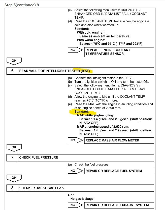

Since you have good scan data, some other things to check would the MAF reading at idle, on a small engine like this, it should be roughly around 1.3-2.3 grams per second or so (that is right from service info), (2.3g/s) at idle and 5.4-7.9 @ 2500rpm, on larger engines as a rule of thumb it will be about the same as the liters of the engine, so on a 5.0Liter it should be about 5g/s at idle.

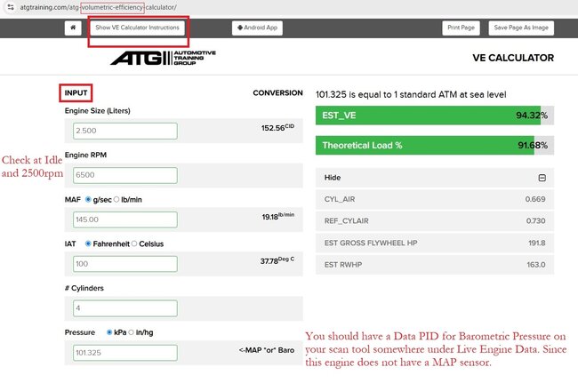

And another test to run is a VE Test, here is a link to a good VE calculator.
https://atgtraining.com/atg-volumetric-efficiency-calculator/
This is a screenshot of the page, when you input your live data PIDs, it will calculate the EST_VE which is the Volumetric Efficiency of the engine, basically how well the engine is breathing, taking in air and allowing exhaust out. If you have a bad cat, or a MAF that is misreporting air flow the VE percentage will be low. You want the number to be as close to 100% as possible, it won't be, but for example the 94% is really good. The Instructions go through a bit more about the test. It's a helpful test to have in general,

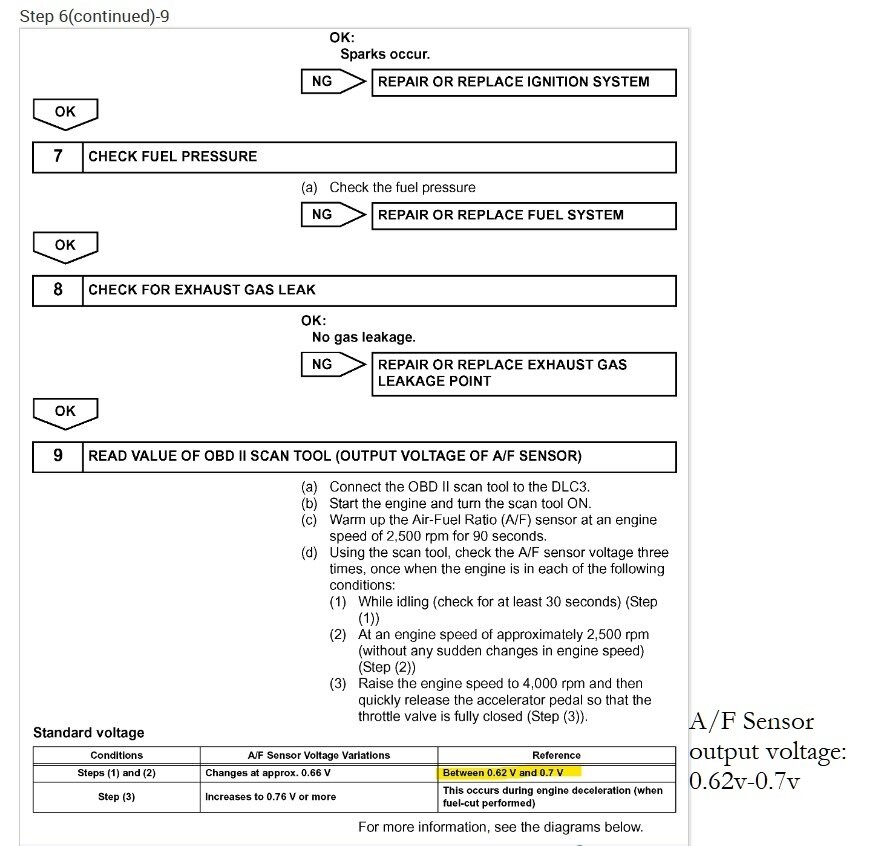

But I agree with your diagnosis and thought process so far, the only thing that looks out of place is your AF sensor reading, on a Toyota it should be reading about 3.0 volts on an engine that's running at the correct air/fuel ratio, so that's why I asked about your reading there. If it's in milliamps or if that's the sensors voltage reading.

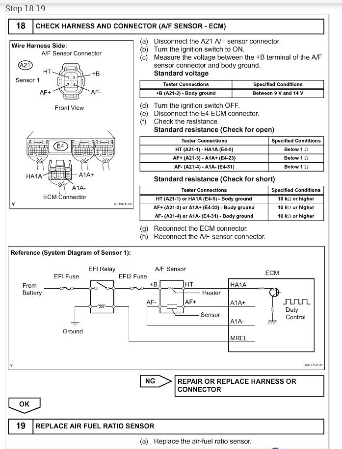

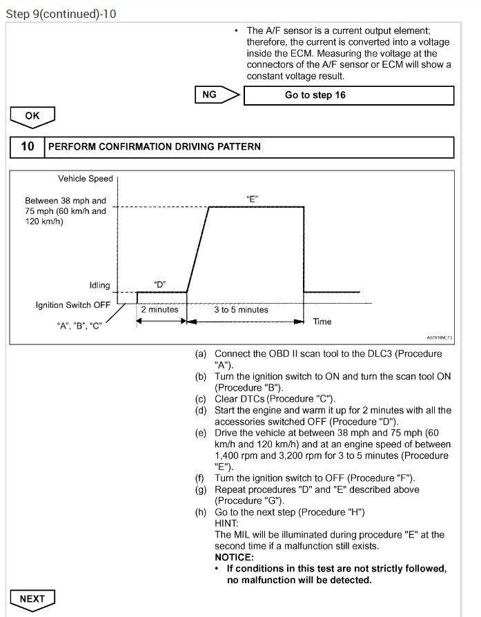

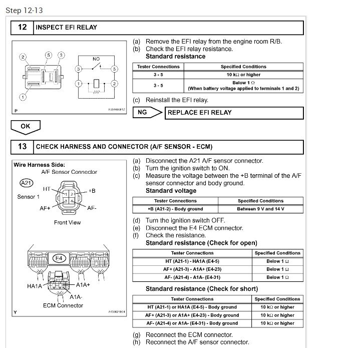

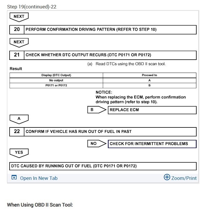

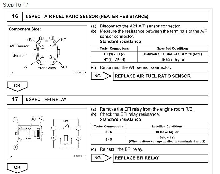

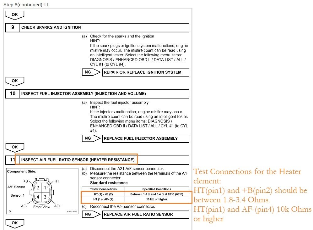

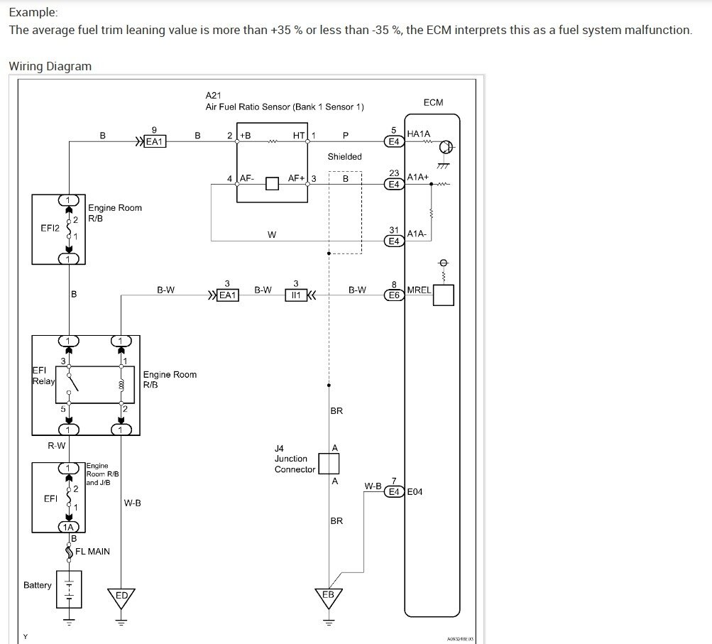

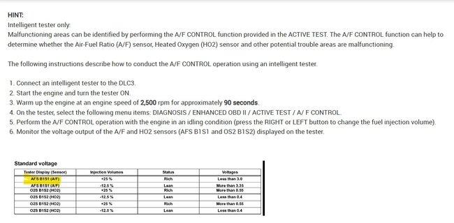

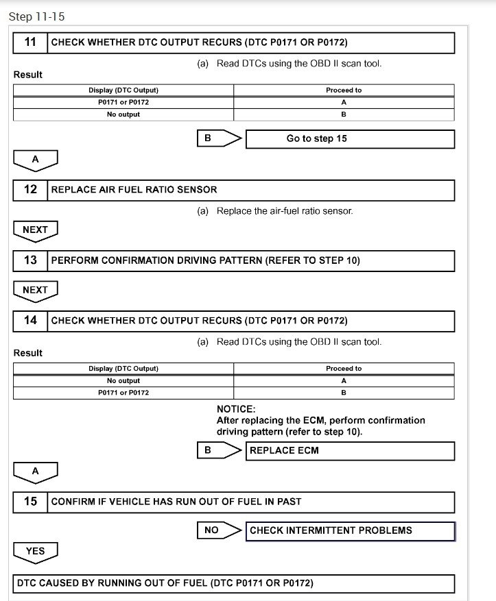

If it is reading 1.23volts at idle, that's way out of spec. I'm going to post the flow chart for you of the AF sensor's service info., I'm wondering if the parts store gave you either the incorrect part number or possibly a regular narrow band 02 sensor. Service info here is stating that anything under 3.0volts will cause high injection volumes (ill post all this for you). 25%+ which is what you are seeing.
And I know that Toyota's a really good at detecting oxygen sensor heater circuit issues, I've been down that road before. And you're not getting any heater circuit codes. So let me get this flow chart together for you, and you can go through it page by page and check your scan tool data.
Sep 18, 2024 at 6:05 AM

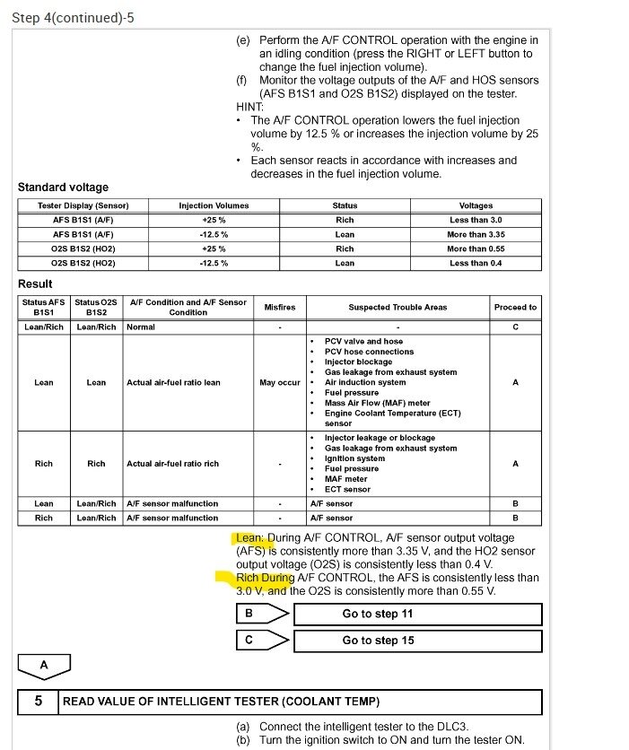

Okay, so some of these scan tool data PIDs will depend on if you are using a Generic basic OBD2 scan tool in which the AF sensor voltage will be converted into a lower reading such as 0.62volts to 0.7volts. If you are using a scan tool and are on the Toyota manufacturers side reading live engine data you should see about 3.0volts on the B1S1 A/F sensor, so either way, something does not look right if that reading is in voltage.
I'm not going to post all of this since you have already checked a lot of it, but these first diagrams are for checking the manufacturers side of the scan tool, so selecting 2007 Toyota Corolla 1.8l etc. It gives a voltage reading of 3.0volts as being 14.7/1 ratio (normal). Page 4 shows that service info. I'll post the basic OBD2 data next.

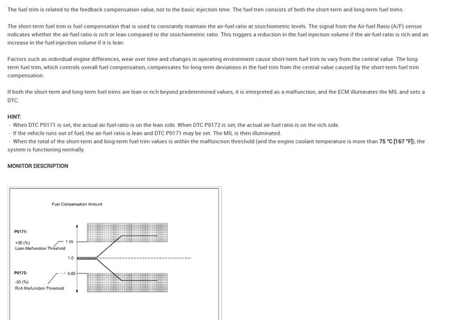

This is the generic OBD2 scan tool flow chart for P0171, and it pretty much ends in "Replace the A/F sensor", and then "Replace the ECM". So, the only differences are the Output voltage readings. But this gives the same MAF readings. I haven't seen a Toyota AF sensor voltage drop that low on the manufacturers side of a scan tool, such as on an Autel or Topdon. Service info states the ECM converts the current flow into a voltage reading for live data, but I suppose that could vary depending on scan tools as well.

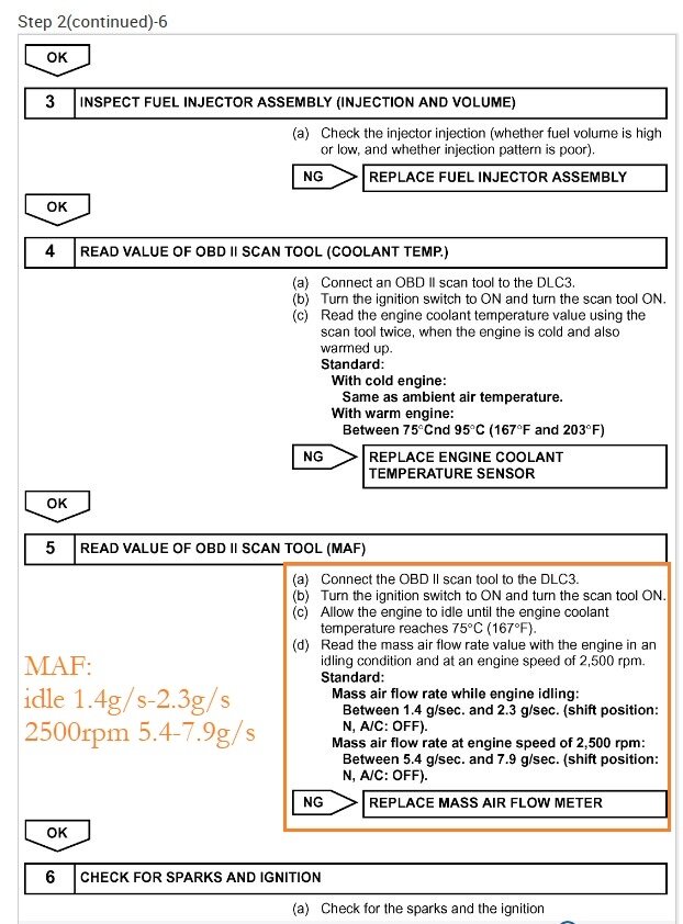

I have a Autel MaxiSys 909 scanner. It reports voltage and a ratio for the AFR sensor. The value I reported is the ratio. As I understand it higher ratios (above 1.0) are lean, and lower ratios are rich. A ratio of 1.23 corresponds to 4.99V as I watch it on the scanner.
MAF readings:
740 RPM = 2.35 gm/s
2536 RPM = 10.62 gm/s
I will run the back pressure test, and retest the fuel pressure on Friday. Additionally, I will review this correpondence to see if there are other tests I need to run. My issue is if the ECM has not relearned the particular area of the fuel map to the ~150% fuel increase then the engine falls flat when I hit that area. If I full throttle the engine (open loop) the engine barely runs. This implies to me it is real (meaning not a sensor lying about the engine being lean when it isn't). If it was a lying sensor (say AFR) then the engine should run fine in these unlearned areas despite the sensor reading.

Note: the 2500 RPM MAF value above was with AC on. I re-ran the test -
MAF readings:
737 RPM = 2.14 gm/s
2506 RPM = 7.73 gm/s
Sep 18, 2024 at 12:16 PM

Yes,you're correct, if it was an air leak (vacuum leak) it would cause the fuel trims to come down towards zero at WOT, along with being in open loop, manifold vacuum would be closer to atmospheric pressure and the leak wouldn't effect fuel trims like they are, so yes it appears to be an actual lean condition. Your MAF readings suggest it's okay. They were a little better on the first pull, but still within spec. The AF ratio of 1.0 is stoichiometric (14.7/1) so 1.23 is an actual lean condition reading as well, you might be looking at clogged up, restricted injectors here.

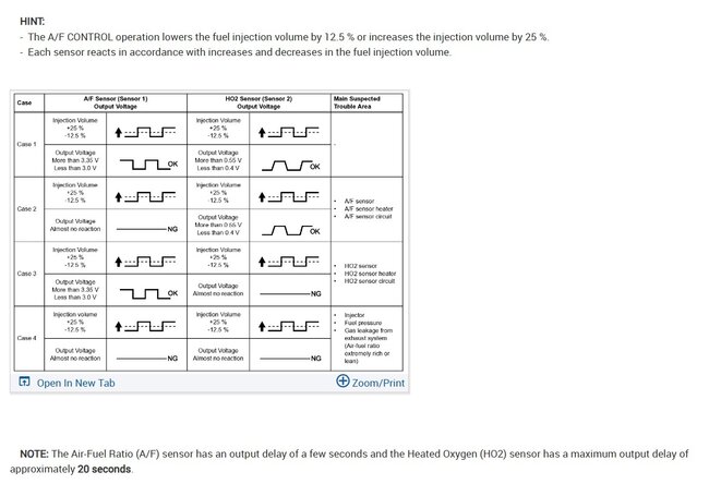

You could also graph the rear oxygen sensor voltage, and it should go full rich (high voltage) at a WOT run, and then it should have an injector cutoff when decel, my guess is you are going to see the rear 02 go lean instead. The MAF readings should be lower if this was a restricted exhaust, because the engine would not be able to take in more air if it can't let exhaust out.

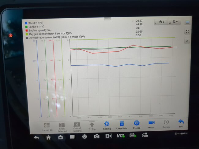

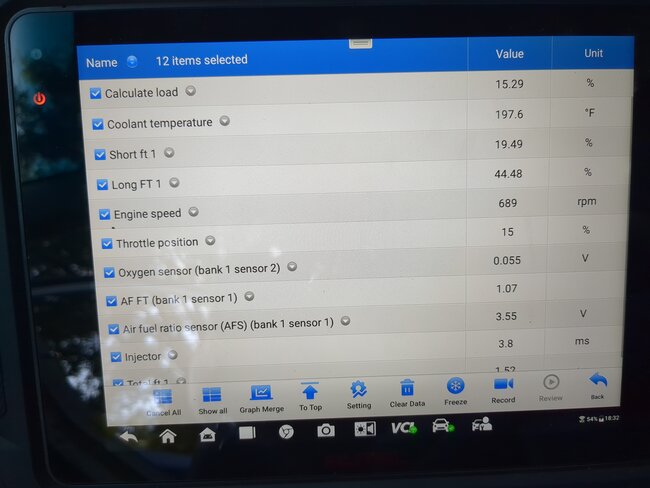

Photos
Sep 22, 2024 at 10:02 PM

Okay, just taking a look at all your postings here, looks like the back pressure is not an issue, that seemed to be the case with the live data from the MAF.
Sep 23, 2024 at 4:57 AM
AL514
  • 5,692 POSTS

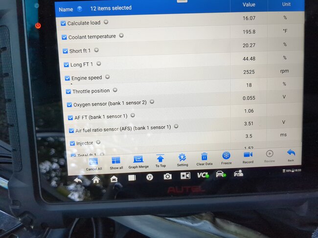

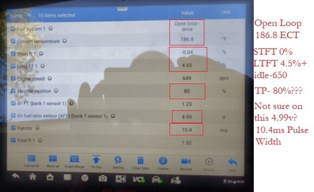

So when was this 3rd set of data PIDs done? This is the strange(r) one of the bunch, its looks like at idle, and 186.8f on the ECT. But Throttle Position is at 80%? and injector on time 10.4ms? And this was taken in Open Loop. Something just doesnt look right here. It looks like closed loop is when the super high fuel trims come in, can you grab data PIDs ECT, Fuel system status, STFT & LTFT, RPM, TPS, Injector ms, MAF, calculated load, B1S1 & B1S2, just those data PIDs, and any others you think will help. I think we need to see what the MAF is reporting during some of this, because how can you have 80%tps @ 650rpm? With the injectors being almost full on at that point, the only difference I see here is the Open/Closed Loop difference. Im going to see how this MAF reads, if its frequency or voltage reading, Interesting case study, Im going to go through the sensor operations some more. You may want to Graph the TPS and check for anything weird going on there too. I cant explain these specific readings at these certain engine temps. I would think at 186.8f it should be able to go into closed loop at that point.
Sep 23, 2024 at 5:30 AM

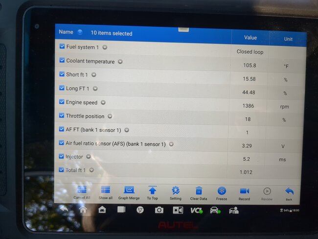

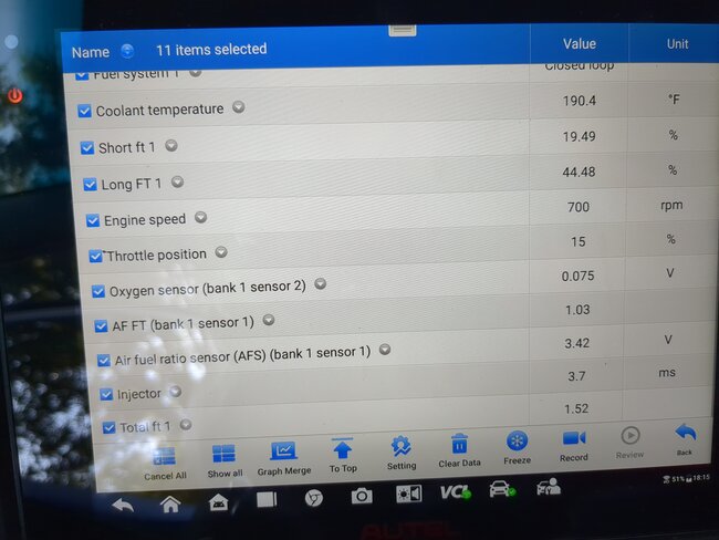

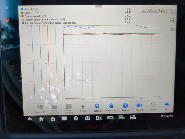

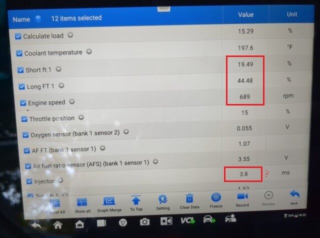

I named the photos for the cases but apparently that does not show up. The specific case you are asking about is a full throttle case in park. Since the fuel map has not "learned" that position and I am in open loop the engine just bogs.
Sep 23, 2024 at 9:20 PM
GNMAN4
  • 27 POSTS
For the regular idle case you can see the fuel map has dramatically increased the fueling (~150%) and the injection time (ms) is higher than it should be. To me this agrees with the lean O2 readings I am receiving.
Any other ideas on what could cause this? I have not researched the effect of cam advance/retard on O2 readings. Lets suppose the timing chain has stretched or the hydraulic advance mechanism is leaking, would it have any effect on O2 readings?

Yeah, I can see the fuel compensation has maxed out in closed loop which is your 4th picture up top there. The rear 02s are only going to read oxygen or lack there of, not the amount of fuel.
But in the picture 3 you are going WOT to 80%, the ECM goes into open loop like it should, the pulse width goes high like it should, the AF sensor ratio of 1.23 though is indicating on the lean side. **But is the lack of RPM change the bog down you are referring to?
Just curious, where did the AF sensor that you swapped out come from? Because it's pegging out a 4.99volts there as well during that event. This data just looks so out of place here.

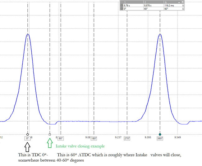

I mean a stretched timing chain is a possibility, Id think you would get some crank/cam correlation codes, along with some possible back firing into the intake, but that also depends on how stretched it is,
Do you have a 2 channel oscilloscope where you could grab the cam and crank signals, I can get you a known good cam/crank wave form for this vehicle no problem, and we could compare the two, I would need your waveform first, Ill give that to someone I know and he will give the same waveform back at the same time base and such. We're only dealing with one cam sensor, if you can get a waveform which shows 360degrees of crank rotation, so you'll have 2 crank TDC signals, one at the beginning of the waveform and one at the end, with the cam signals below it, and zoomed in enough where we can measure the actual degrees between either the rising edge or falling edge of the 2 sensors, that would tell us exactly how stretched the chain is.
If you have an in-cylinder pressure transducer, that can even tell you if your intake or exhaust valve opening is either retarded or advanced. I use a scope for almost everything these days.. I can post some examples if needed

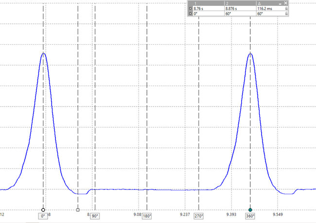

So this is a cranking in cylinder waveform from a 2006 Honda CRV, which turned out to be a strange head gasket issue, but even though this is not a crank/cam waveform it shows how we could measure the degrees between the two signals my lining up the cursors and marks, the compare it with a known good, do the same and see if there is timing chain stretch or if the timing might have jumped a tooth, but in that case technically it should set a code, but sometimes the difference needs to be something like 5 or 6 degrees to actually set a code for timing, This is from a Pico scope setup. I just put this up as an example. I do have a vehicle here that I need to get the cam and crank signals from, which I'll try to do in the next day or so.

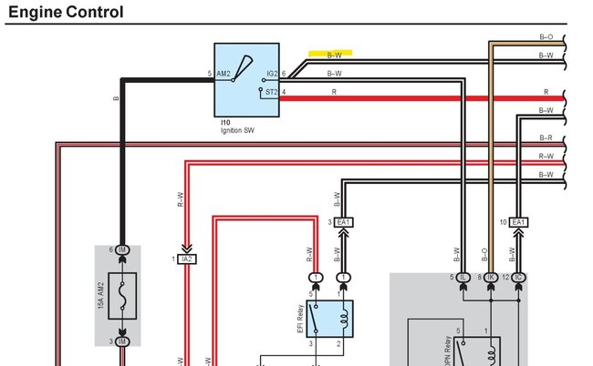

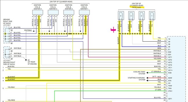

So, Id first check to make sure the injector power wire can carry current, the injectors and coils look to be powered directly through the ignition switch (I will verify this), but they are on a 15amp fuse, so that injector wire should be able to light a 4amp test lamp easily. I use a turn signal or headlamp bulb should work, I use a turn signal bulb, one filament is about 2-3amps for load testing wiring. If it can light the bulb with no problems for a few seconds, then at least the wiring should be okay. I don't even think a purge valve stuck open would cause the fuel trims you're seeing, they're just too high.
Plus, your sensor data points to an actual fuel issue, so the *injectors and *fuel rail, Or *bad gas is all that's left. Unless we missed something, I've been crossing off components listed under the p0171 code criteria, and we're at what you see below. You did smoke tests, I'm not sure how much pressure you put on the intake while smoking it, but a vacuum leak should go away at higher rpm and this issue isn't.
If your power feed load test is good, I guess pull the rail and you can even use the injector balance tool to see what they are flowing.
Something else I've seen which is common these days, is if the injectors have been replaced by someone in the past and they install the "great deal" injector set from amazon, or some other aftermarket source, and they are junk and just don't have the correct flow rate. Or if the incorrect injectors were installed at some point,
I mean between the 2 of us, this shouldn't be too difficult, it's just the amount of trim that's really crazy, You're correct the fuel mapping is maxed fully. This leaves the fuel rail, and I'm really looking forward to hearing the fix on this one. I have to go on a mobile call here shortly, but I will stop back and check your reply during the day.

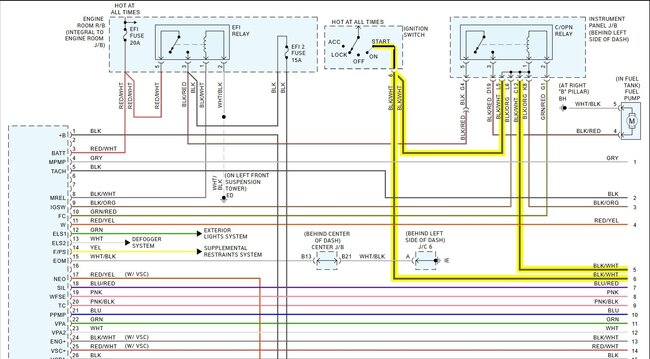

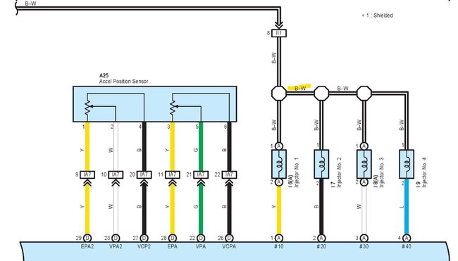

Yes we're on the same page. WOT should go full bore... I messaged a friend of mine whos a sales rep for PicoTech but he didnt get back to me yet, he might not have an answer since you have already gone through so much. I mean we are only left with injector flow or bad ECM I think. I kind of wish I was at this vehicle to see how its acting, pretty interesting case study if its all 4 injectors clogged up,. Did the car sit for awhile, or did these issues develop over time? Its amazing how high the mileage is,
You want to pump out a gallon or two out of the tank when you have the fuel lines apart and let that sit. If theres anything in it but gasoline it will separate into different levels in the bucket, just to see if there is possibly anything in the bottom of the tank. This will also show how much volume the pump can put out.

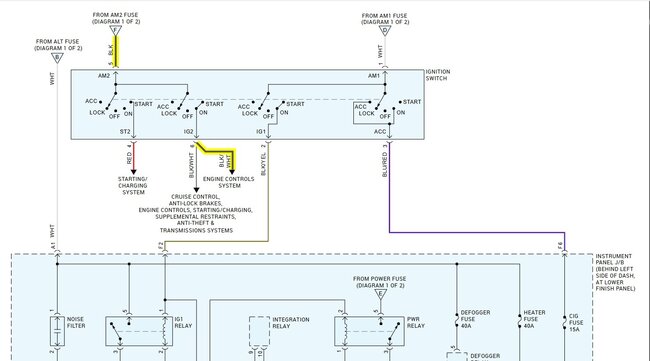

But also load test the injector power feeds with a good size light bulb to make sure they can carry good current. Pop out a turn signal bulb if needed, that should be 2-3 amps at least. Port fuel injectors only pull about 1 or so amps if they are the 12-14 ohm ones. So a turn signal bulb is plenty to see if that circuit can carry enough current. but only keep it lit for a few seconds. I cant wait to see this thing fixed man..
These are the injector power feeds, the Black/White wire also feeds the coils, its strange that it comes directly through the ignition switch and not from a relay, but diagrams 4 and 5 are the "oem" if theyre correct,
