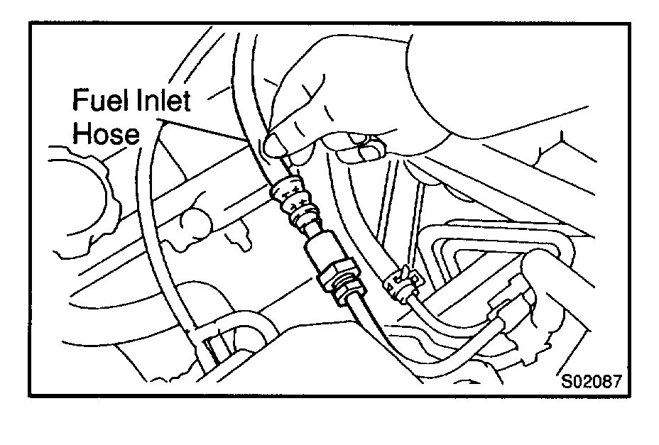

Here are the directions specific to your vehicle. The attached pictures correlate with these directions.
_____________________
FUEL PUMP
ON-VEHICLE INSPECTION
1. CHECK FUEL PUMP OPERATION
a. Connect a TOYOTA hand-held tester to the DLC3.
b. Turn the ignition switch ON and push TOYOTA hand-held tester main switch ON.
NOTE: Do not start the engine.
c. Select the ACTIVE TEST mode on the TOYOTA hand-held tester.
d. Please refer to the TOYOTA hand-held tester operator's manual for further details.
e. If you have no TOYOTA hand-held tester, connect the positive (+) and negative (-) leads from the battery to the fuel pump connector.
f. Check that there is pressure in the fuel inlet hose from the fuel filter.
HINT: If there is fuel pressure, you will hear the sound of fuel flowing. If there is no pressure, check the H-fuse, M-fuses, fuses, EFI main relay, circuit opening relay, fuel pump, ECM and wiring connections.

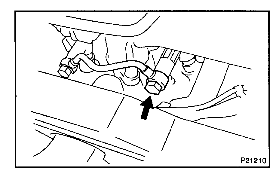

d. Remove the union bolt holding the fuel pipe to the delivery pipe and gasket.
CAUTION:
- Put a shop towel under the delivery pipe.
- Slowly loosen the union bolt.

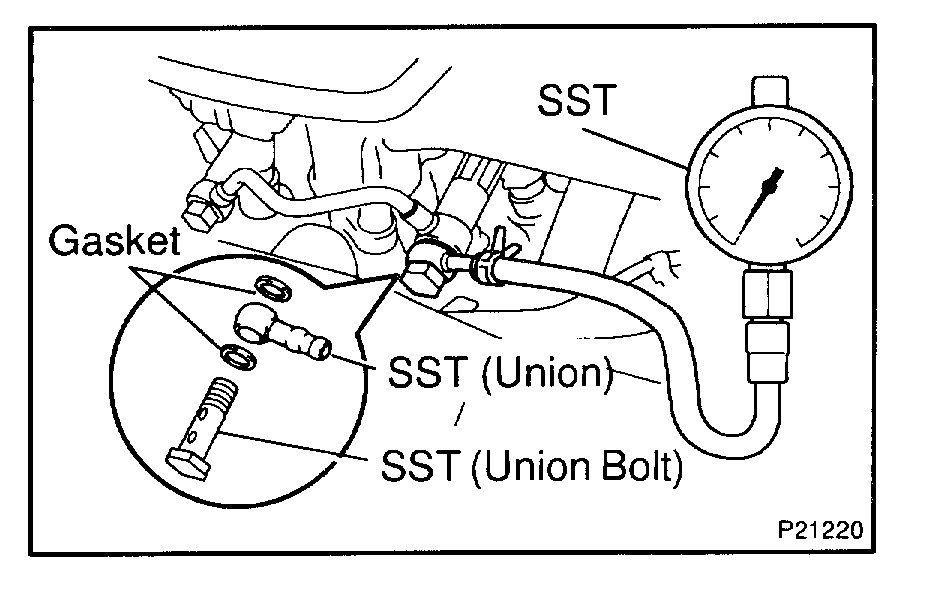

e. Install SST (pressure gauge) to the delivery pipe with the 2 gaskets and SST (union and union bolt).
SST 09268-45014
Torque: 34.3 Nm (350 kg.cm, 25 ft.lb)
f. Wipe off any splattered gasoline.
g. Connect a TOYOTA hand-held tester to the DLC3. (See step 1)
h. Reconnect the negative (-) terminal cable to the battery.
i. Turn the ignition switch ON.
j. Measure the fuel pressure.
Fuel pressure: 265 - 304 kPa (2.7 - 3.1 kg/Sq.cm 538 - 44 psi)
If pressure is high, replace the fuel pressure regulator. If pressure is low, check the fuel hoses, fuel hose connections, fuel pump, fuel filter, fuel pressure regulator and VSV for the fuel pressure control.

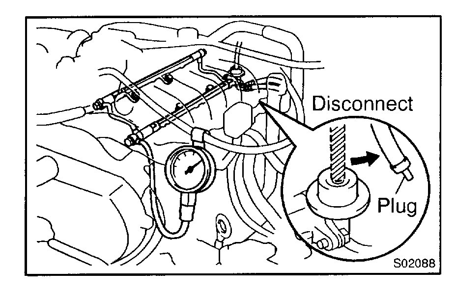

m. Start the engine.
n. Disconnect the vacuum sensing hose from the fuel pressure regulator, and plug the hose end.
o. Measure the fuel pressure at idle.
Fuel pressure: 265 - 304 kPa (2.7 - 3.1 kg/Sq.cm, 38 - 44 psi)
p. Reconnect the vacuum sensing hose to the fuel pressure regulator.
q. Measure the fuel pressure at idle.
Fuel pressure: 226 - 265 kPa (2.3 - 2.7 kg/Sq.cm, 33 - 38 psi)
If pressure is not as specified, check the vacuum sensing hose and fuel pressure regulator.

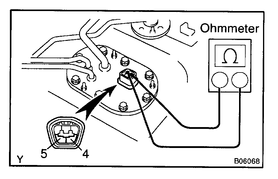

3. INSPECT FUEL PUMP RESISTANCE
Using an ohmmeter, measure the resistance between terminals 4 and 5.
Resistance: 0.2 - 0.3 Ohms at 20 °C (68 °F)
If the resistance is not specified, replace the fuel pump and/or set plate.

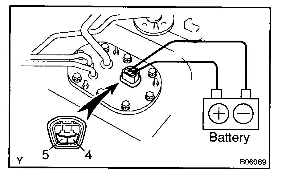

4. INSPECT FUEL PUMP OPERATION
Connect the positive (+) lead from the battery to terminal 4 of the connector, and the negative (-) lead to terminal 5. Check that the fuel pump operations.
NOTE:
- These tests must be done quickly (within 10 seconds) to prevent the coil from burning out.
- Keep the fuel pump as far away from the battery as possible.
- Always do switching at the battery side.
If operation is as not specified, replace the fuel pump and/or set plate.
