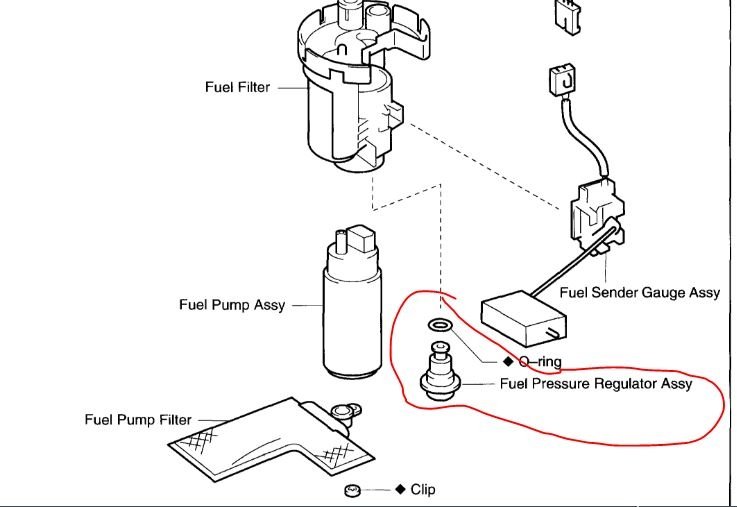

I was driving and my car just shut off. I later realized that the fuel pump was not working and changed it. but after then I realized my car takes lots of fuel. I have changed the plug service nozzles and also air intake sensor, but still the same.

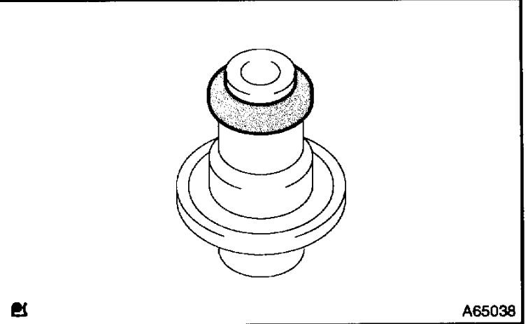

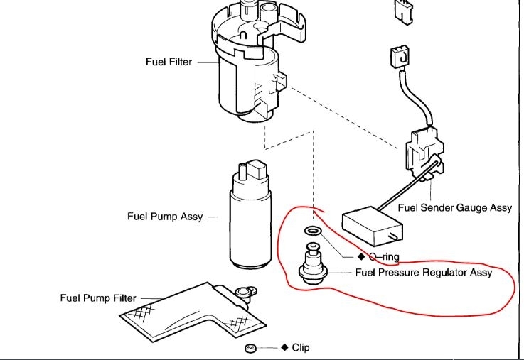

When you replaced the pump, was the regulator inspected? Have you checked fuel pressure to see if it is too high?
I attached two pictures. The first shows where the regulator is located in relationship with the pump. The second picture is what the regulator looks like.

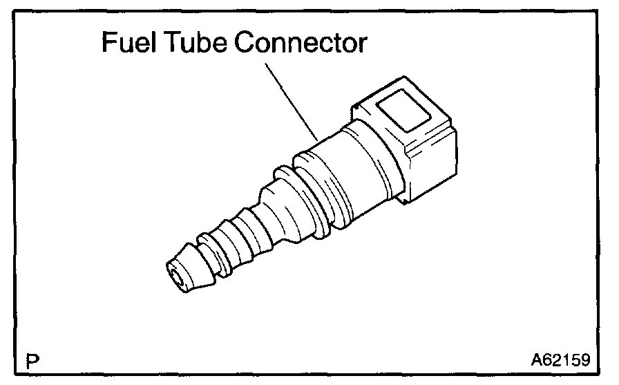

1. Purchase a new fuel tube, and take out the fuel tube connector from its tube.
HINT: Part No. 23901-OD010
b. Work for prevent gasoline from spilling out.
c. Disconnect the EFI fuel pipe clamp.
d. Disconnect the fuel tube from the fuel main tube.
pic 4

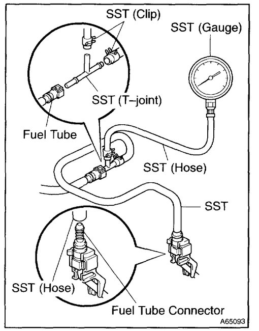

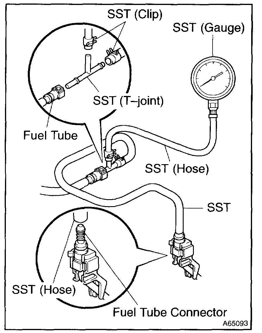

e. Install SST (pressure gauge) as shown in the illustration by using the SST and fuel tube connector.
SST 09268-41047 (90467-13001, 95336-08070), 09268-45014 (09268-41200, 09268-41220, 09268-41250, 90467-13001)
f. Wipe off any splattered gasoline.
g. Start the engine.
h. Measure the fuel pressure at idle.
Fuel pressure: .................... 304 - 343 kPa (3.1 - 3.5 kgf.sq.cm, 44 - 50 psi)
i. Stop the engine.
j. Check that the fuel pressure remains as specified for 5 minutes after the engine has stopped.
Fuel pressure: .................... 147 kPa (1.5 kgf.sq.cm, 21 psi) or more
If pressure is not as specified, check the fuel pump, pressure regulator and/or injectors.
k. After checking fuel pressure, disconnect the negative (-) terminal cable from the battery and carefully, remove the SST and fuel tube connector to prevent gasoline from the splashing.
l. Reconnect the fuel tube to fuel main tube.
m. Install the EFI fuel pipe clamp.
n. Check fuel leak.
