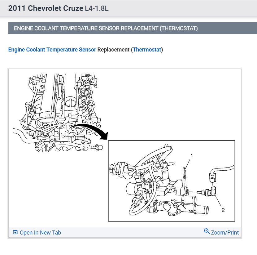

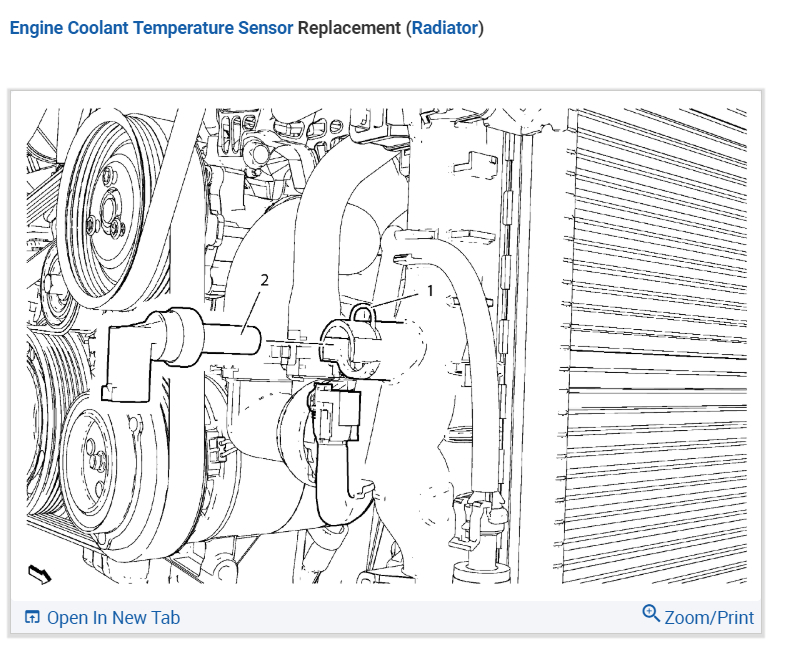

I have had thermostat housing, water pumps etc., fixed in my car. Still getting this message A/C off due to high engine temperature and fan is going. Please help. Any suggestions?
Jul 20, 2019 at 1:28 AM
  • 55,721 POSTS

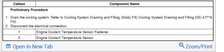

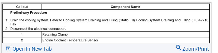

We can put it on a scanner to see what the reading of the engine coolant temperature is to confirm the sensor has gone bad. here is a guide with the both sensor locations below (this car has two sensors):
