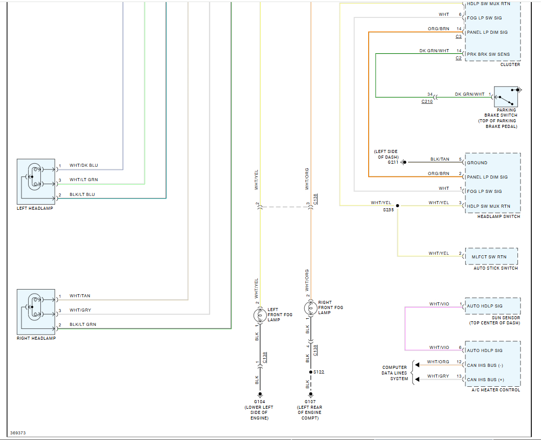

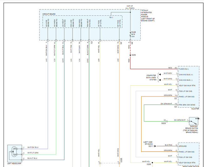

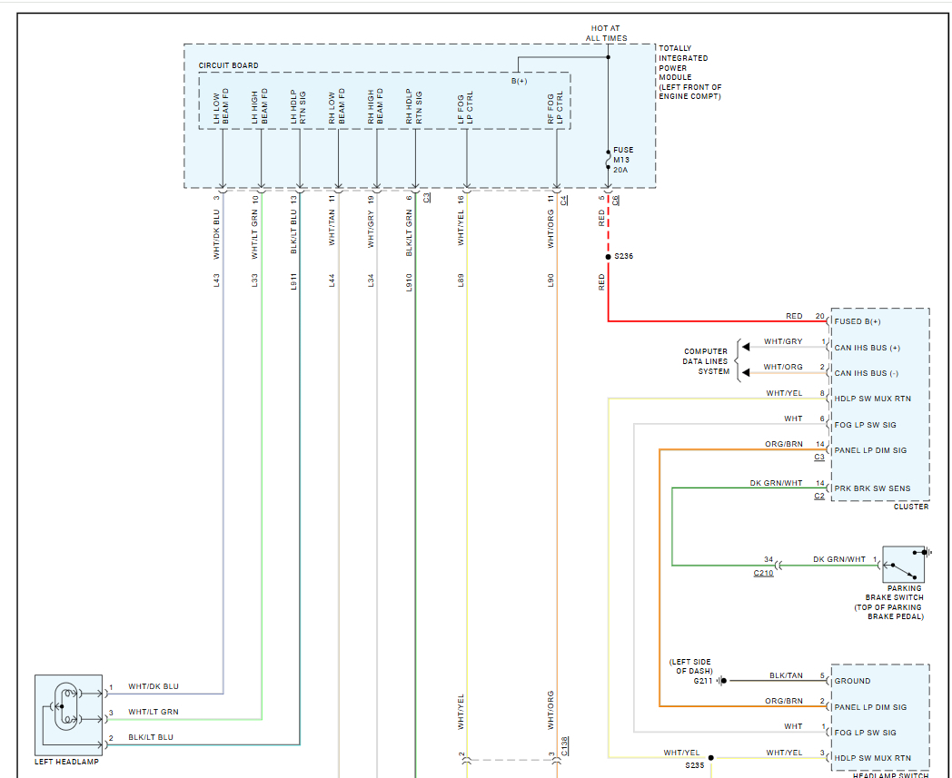

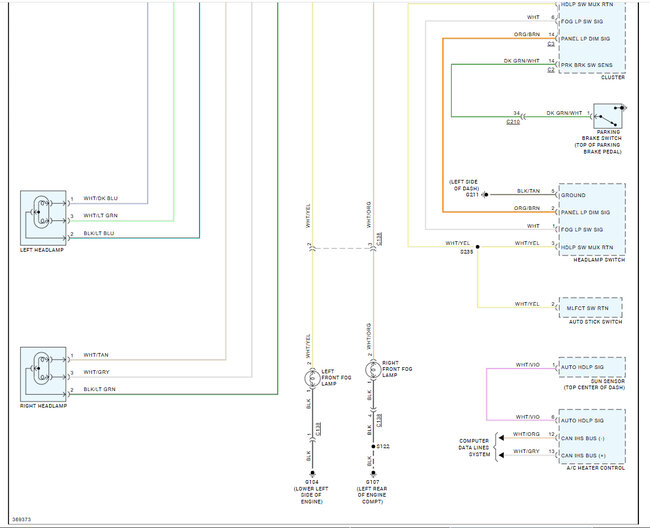

That is a nice truck!! Okay lets fix this problem for you. Since the issue is intermittent we will need to test when the lights are out or do a CAN scan which may guide us in the right direction, this video will help.
CAN SCAN - https://youtu.be/u-4syLc-ifQ
I can tell you I have seen the TIPM go bad on these trucks and you will need to replace it to fix it. Here is the wiring diagrams so you can see how the system works, the TIPM supplies the power and grounds. So the wiring is bad, (doubtful) or the TIPM needs replacement.
