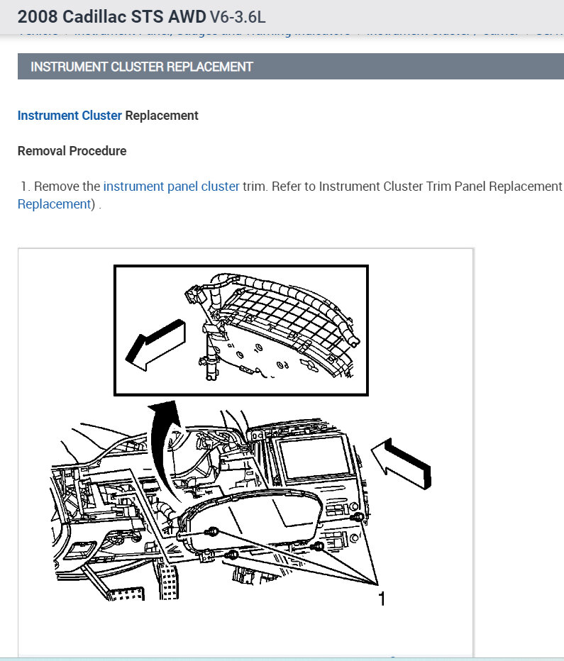

I have seen the IPM (instrument panel module) cause this issue. here is the location of unit so you can check it out, also we should check the fuses to be sure and do a CAN scan which is easy. You can get a CAN scanner (Controller Area Network) from Amazon.

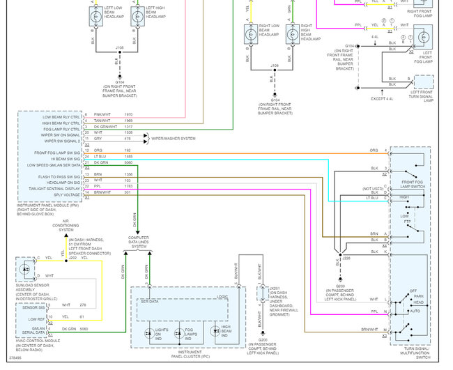

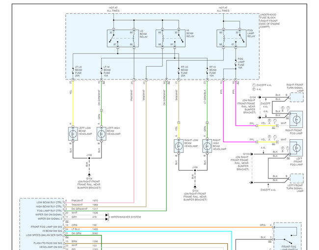

Also, here is a guide to help you check the fuses for the headlights which I have left the headlamp wiring diagrams so you can see which fuses to test under the hood and to see how the system works.

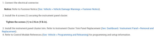

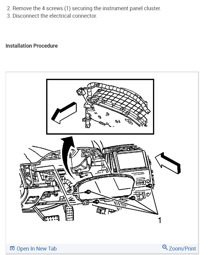

Here is how to change the IPM out which you can find a rebuilt preprogrammed unit by searching google or eBay. Please let us know how it goes.
