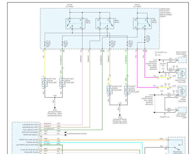

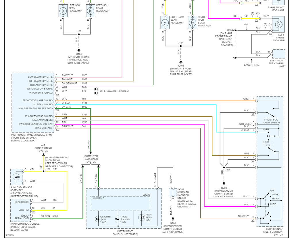

My High Beams are on until i use the left turn signal. How do I fix this? it's been going on a long while turns off on occasion then back on, the auto control on my rear-view mirror don't seem to work like it used to so it doesn't matter if the auto is on or off the high beams stay on regardless or at least till i use the left turn signal. please send whatever I can do to fix this with wiring diagrams, if needed. PS: at night they go off when a car is in the opposite lane, at least that still works, Thanks Again you guys are priceless !!!!

I have seen the IPM (instrument panel module) cause this issue. here is the location of unit so you can check it out, also we should check the fuses to be sure and do a CAN scan which is easy. You can get a CAN scanner (Controller Area Network) from Amazon.
https://youtu.be/u-4syLc-ifQ
and
Here is a list of CAN scanners starting at about $25.00 on Amazon:
https://amzn.to/3DBMlc7

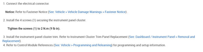

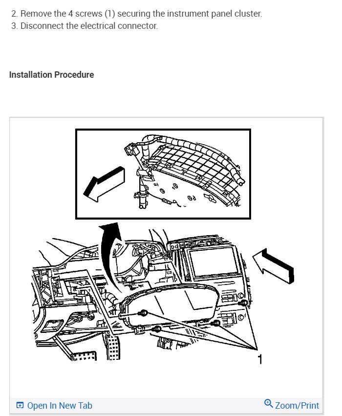

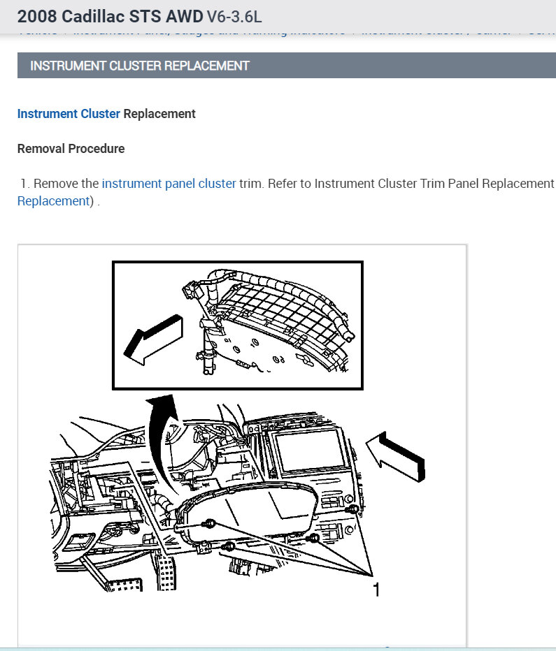

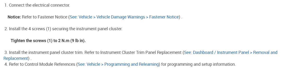

Also, here is a guide to help you check the fuses for the headlights which I have left the headlamp wiring diagrams so you can see which fuses to test under the hood and to see how the system works.
Here is how to change the IPM out which you can find a rebuilt preprogrammed unit by searching google or eBay. Please let us know how it goes.
