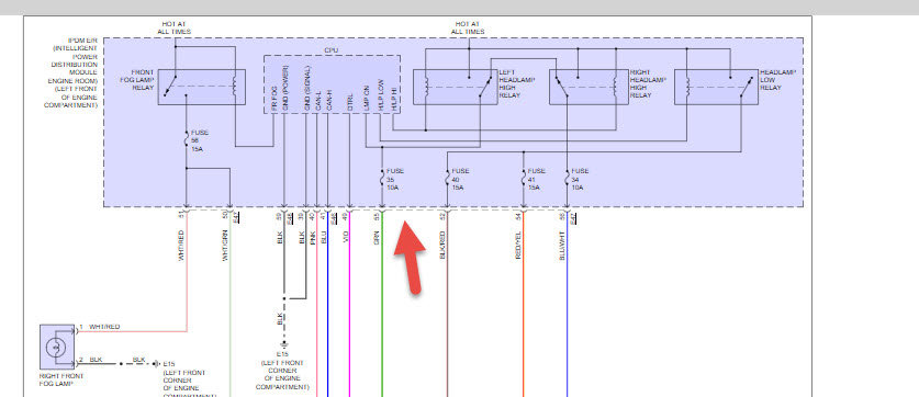

I have a problem only in the low beam light only at the drivers side it is not working, however the high beam is fine.
Jul 19, 2017 at 3:08 AM
HMAC300
  • 48,601 POSTS

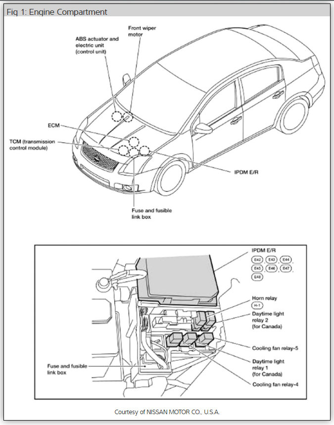

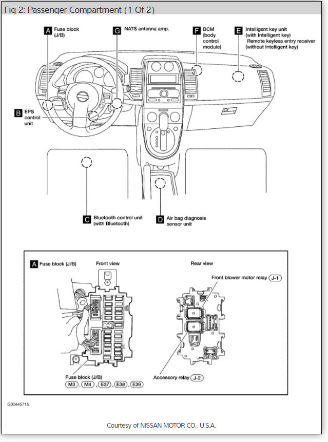

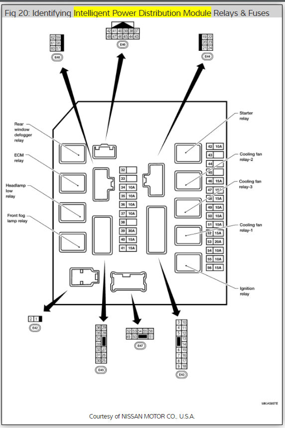

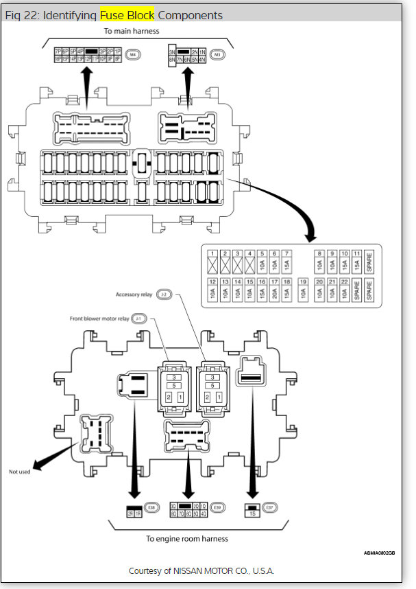

Check fuses in picture. if not that then do a CAN scan for codes as it may be a body module problem. Here is a video that shows how.
https://youtu.be/InIlnsjOVFA
You can get a CAN scanner for $40.00 on Amazon
Jul 19, 2017 at 8:40 AM
SHEREF
I checked and replaced the fuse but nothing changed
Jul 24, 2017 at 1:25 AM
  • 55,224 POSTS

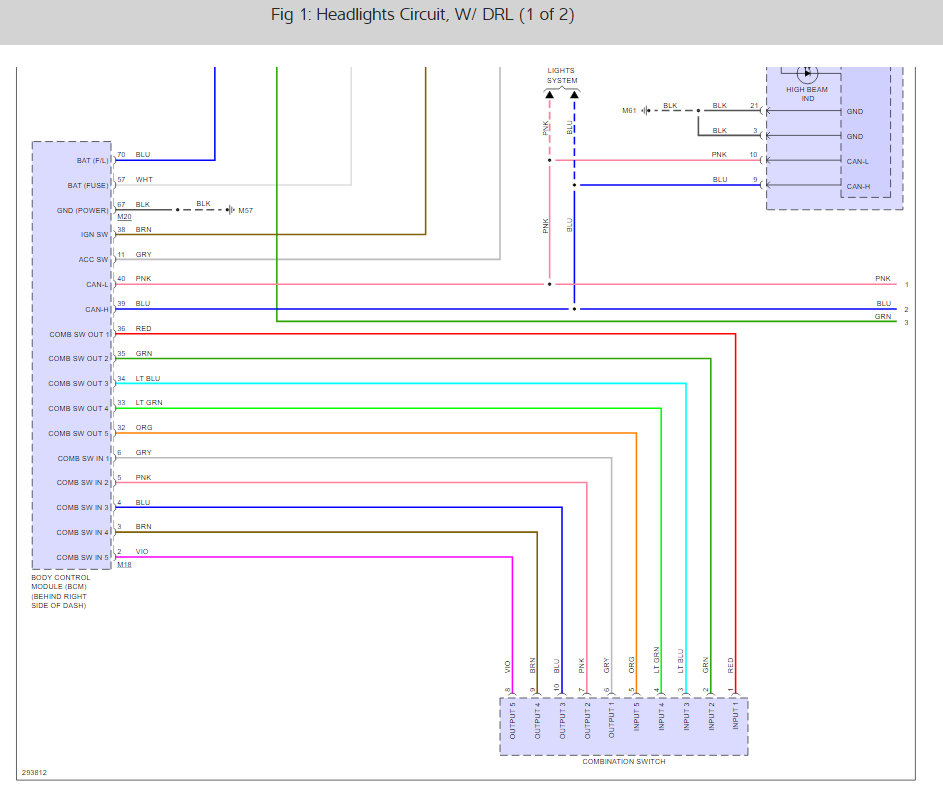

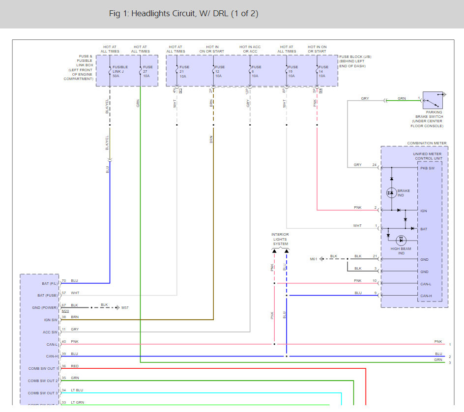

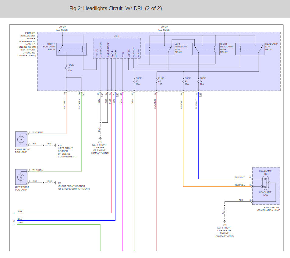

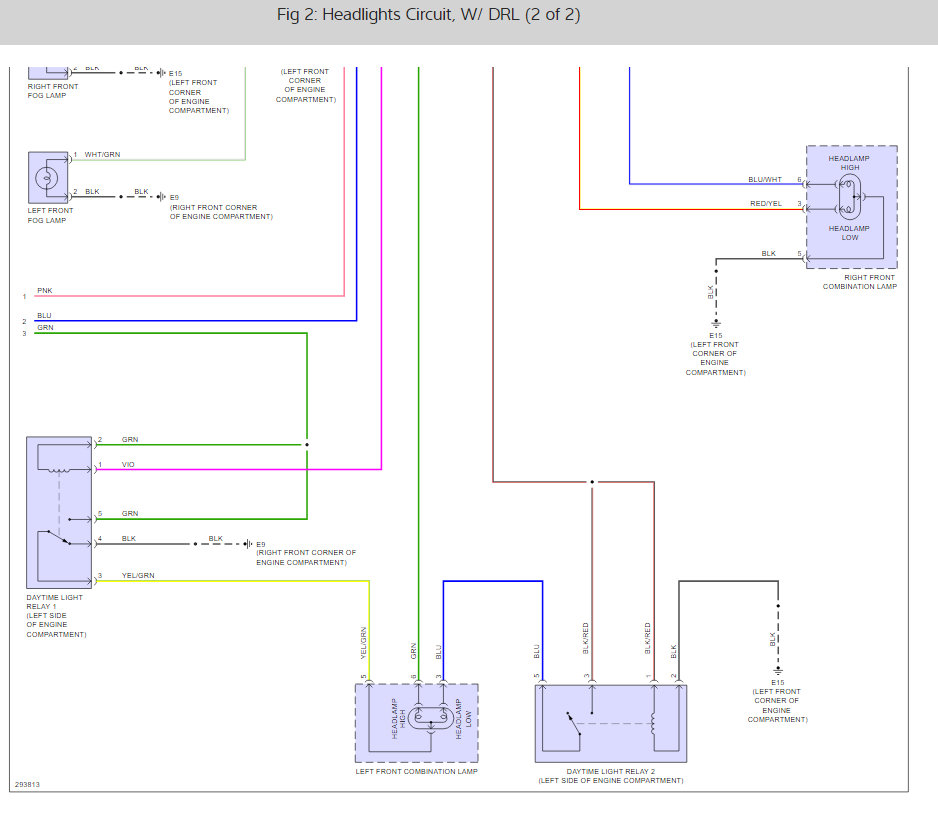

There are several fuses and relays that work the system. Here are some guides and diagrams (Below) that will help you get the problem fixed.
and
and
Please run some tests and get back to us we are interested to see what it is.
Jul 24, 2017 at 12:13 PM
SHEREF
First the left side low beam did not work although the high beam is working. I checked the fuses they were fine. Now the tail light on the left side is also not working at all.

Thanks for this post I had this problem and had to get a new IPDM which cost $176.00 all fixed I love this site.
