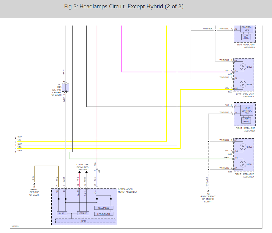

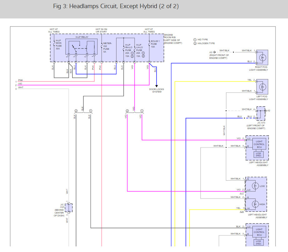

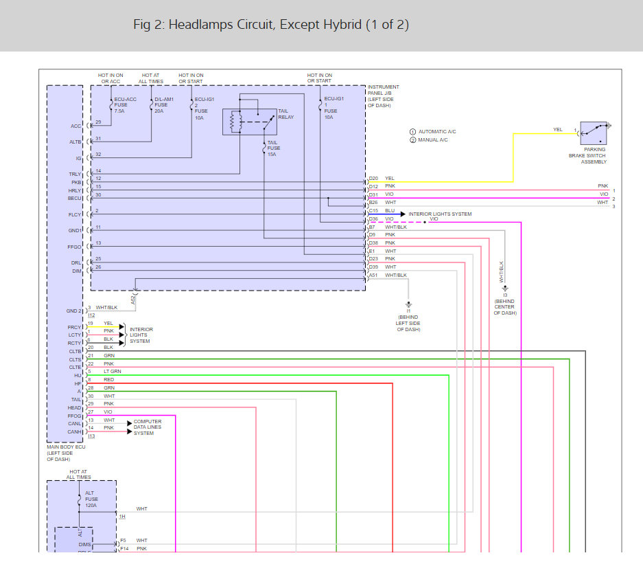

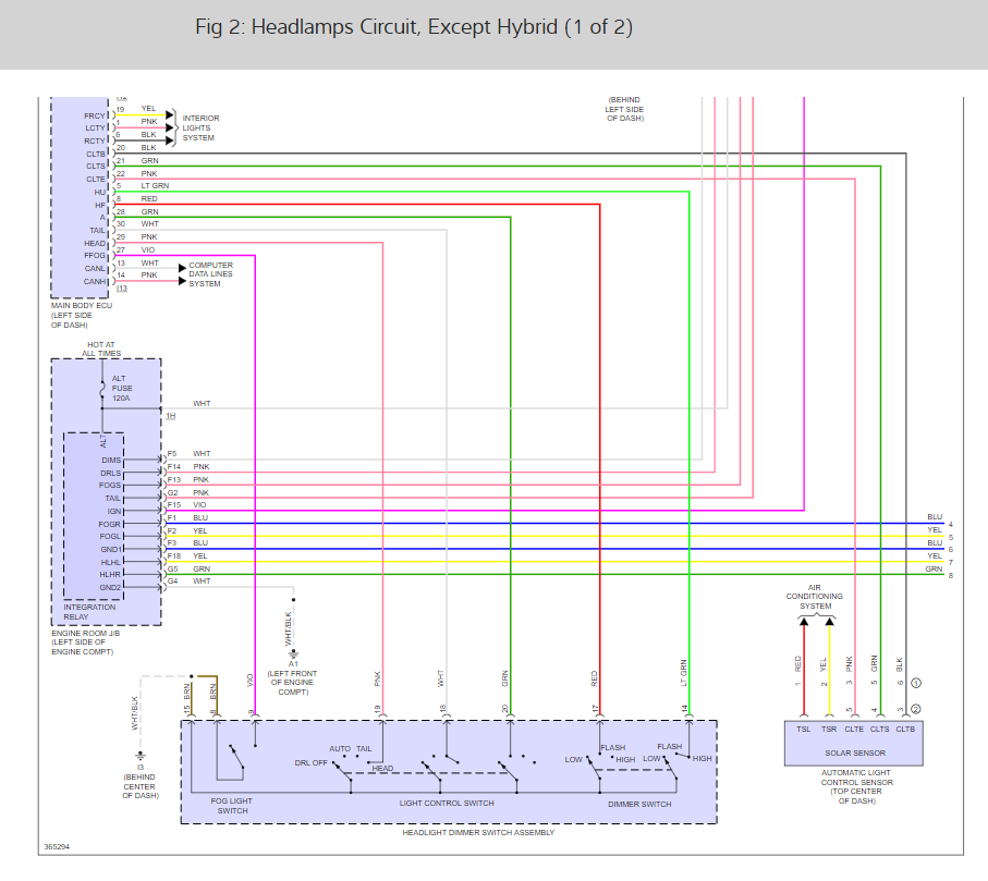

Hi. Can't find problem what cause high beams to stay on. Check light switch and main body ECU and still not the problem . What else can I check?
May 25, 2019 at 10:25 AM
  • 55,267 POSTS

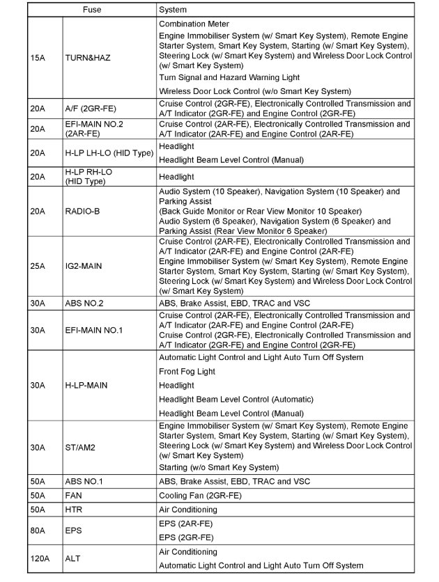

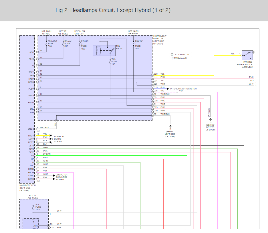

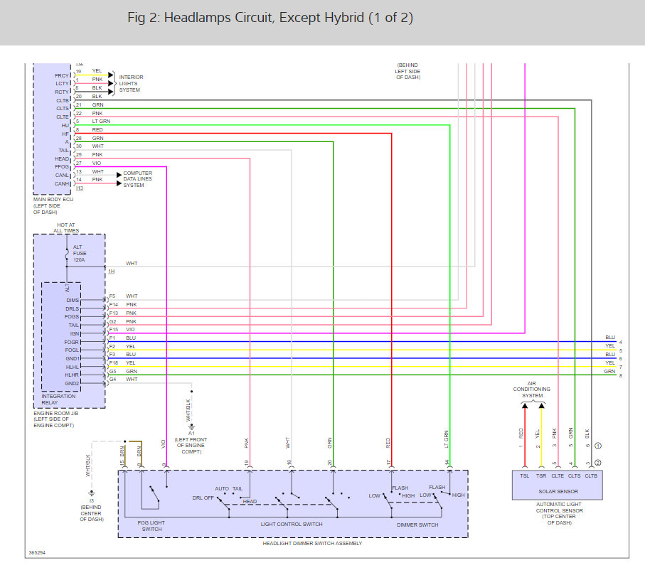

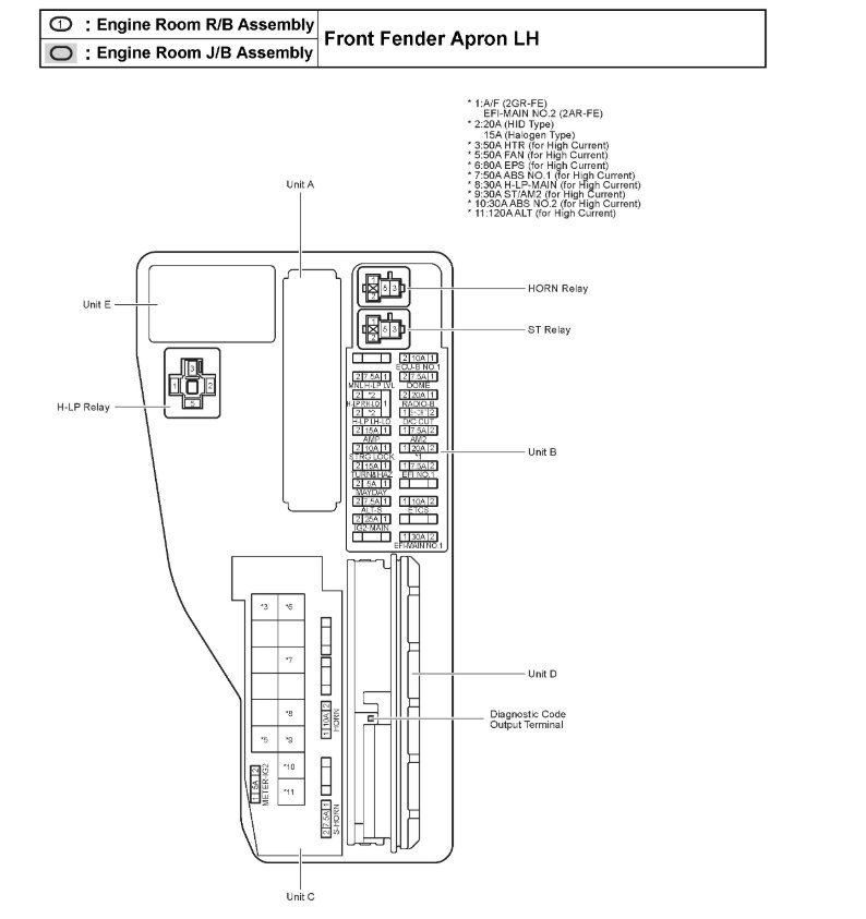

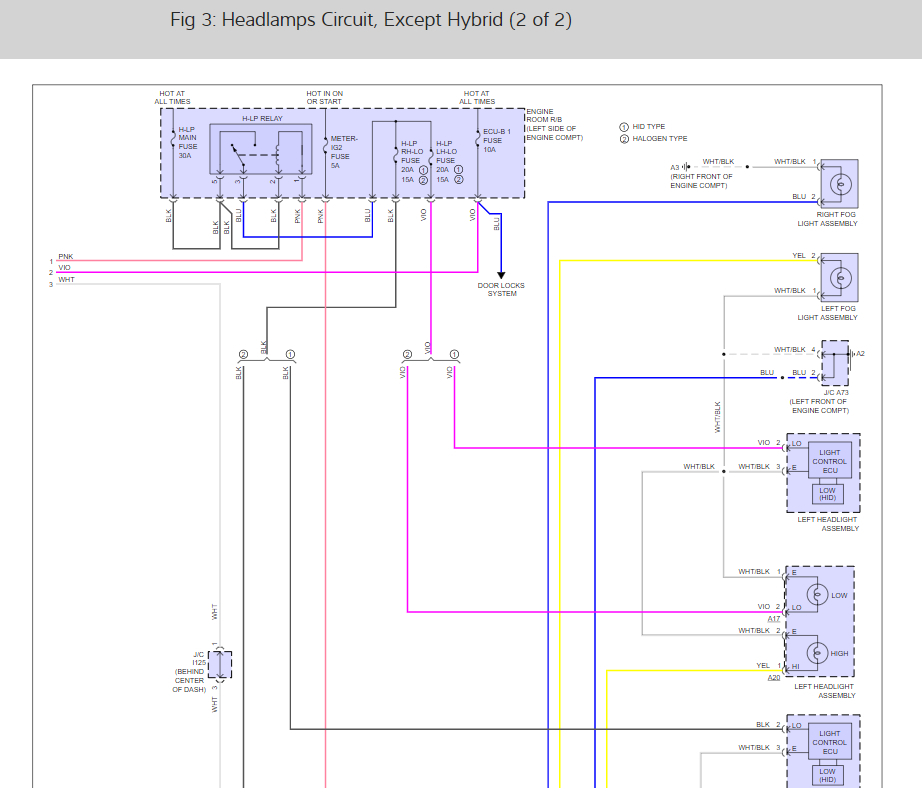

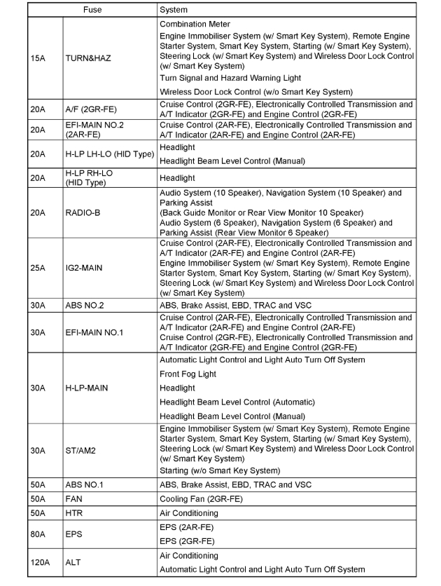

It sounds like the H-LP relay is stuck on. here is a guide to help you test it and the headlight wiring diagrams so you can see how the system works and the relay location as well (below):
May 29, 2019 at 12:35 PM
SAENGS210
  • 10 POSTS
It was a bad integration relay.
Jun 4, 2019 at 10:17 AM
  • 55,267 POSTS
Glad you could get it fixed, that kind of problem can be tough. Please use 2CarPros anytime we are here to help.
