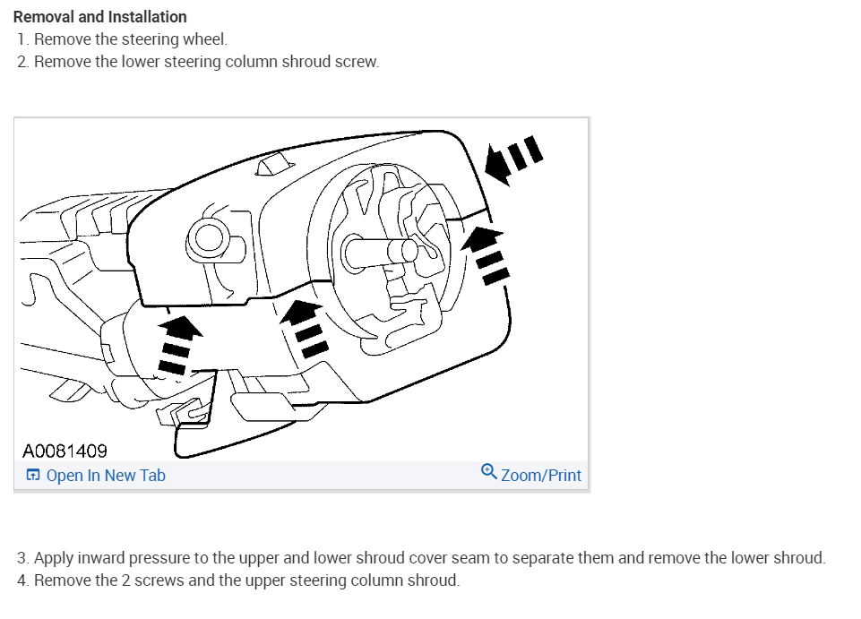

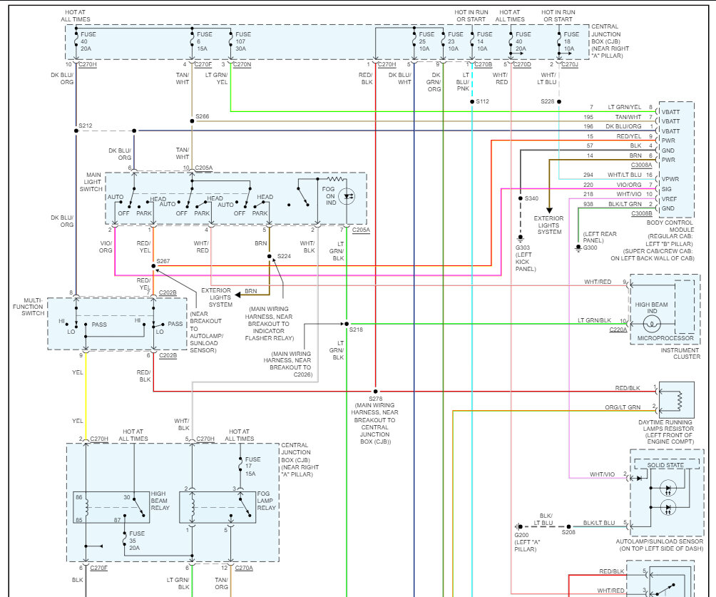

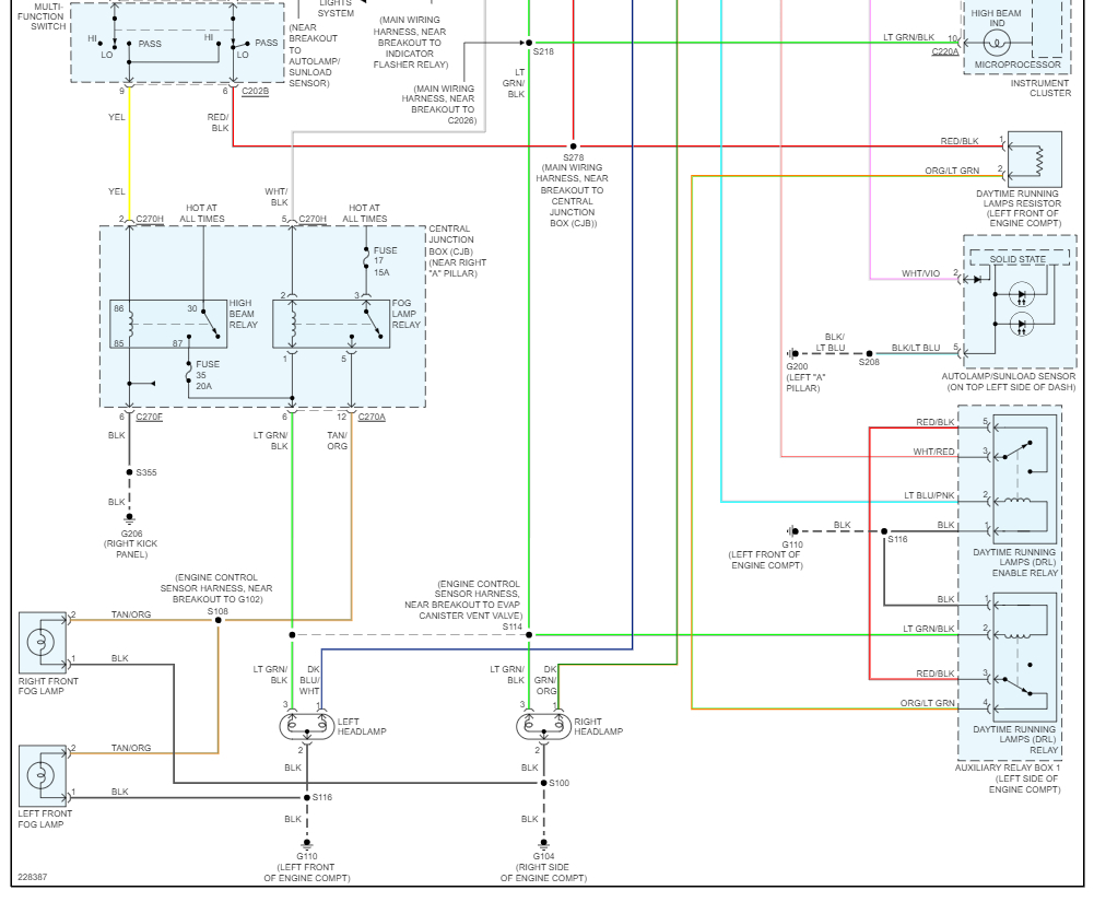

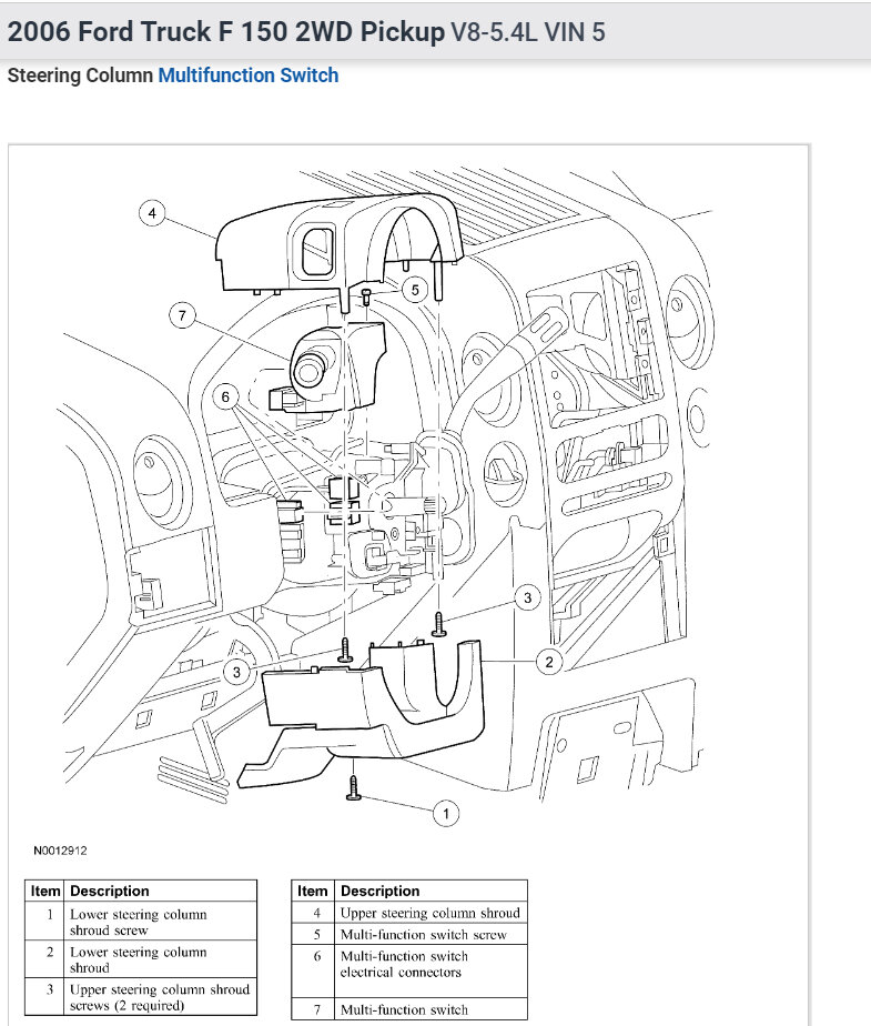

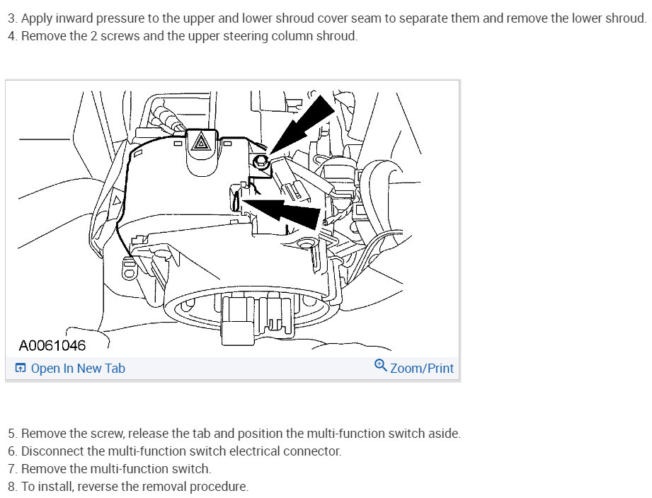

9 times out of 10 it will be the multifunction switch but there are several fuses that run the system so I would check those first here is a guide to help and the headlight wiring diagrams so you can see how the system works and which fuses to check:
Check out the images (below). Please let us know how it goes

Yesterday I installed the new switch that controls the wipers, the fluid for them, the indicators, the high beams and the problem with them was fixed!
