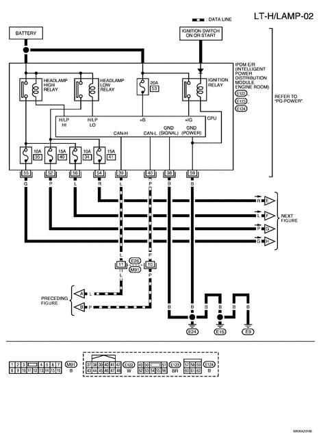

High Beam lights work, but low beam lights don't work
2007 NISSAN FRONTIER
97,750 MILES • V6 • 2WD • AUTOMATIC
MAGICMOMENTS4
My high beam lights work fine, but my low beam lights don't work. I have check the fuses, and relays to determine if there is a problem with them, but all appear to work fine. I have not check the light switch on the steering column nor the head lights yet. Any thoughts?
Feb 1, 2014 at 1:23 AM
KNOWLEDGE IS POWER
  • EXPERT
  • 1,136 POSTS
that vehicle has module that controls the headlights. the high beam and low beam headlights are controlled separately inside this module called the IPDM. you may have a problem in there. if you have a test light or meter you can check power and ground t the low beams. im leaning towards the module if both of them went out together
