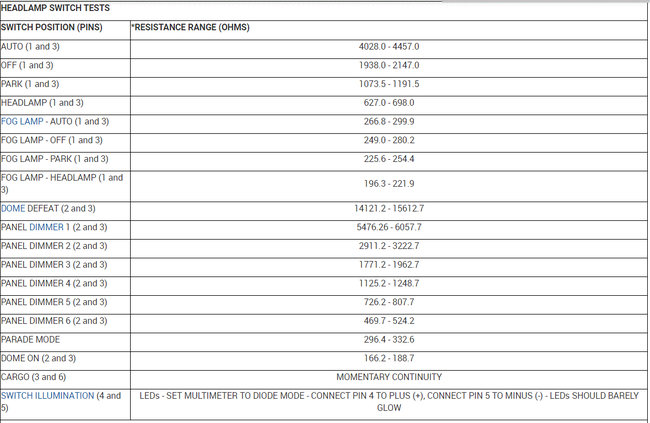

It sounds like the switch could be the problem. I'm saying that since all lights are affected. Here are directions for testing the switch. You will be checking the resistance between specific pins on the switch. The attached pics correlate with the directions.

See pic 1
Remove the headlamp switch from the instrument panel. (Refer to 08 - Electrical/8L - Lamps and Lighting/Lamps/Lighting - Exterior/SWITCH, Headlamp - Removal) .
Disconnect the instrument panel wire harness connector from the back of the headlamp switch.

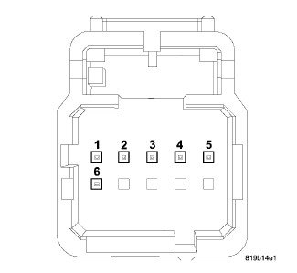

Using an ohmmeter, test the resistance or continuity between the terminals of the switch as shown in the Headlamp Switch Tests table.
Test
See pic 2

If the switch is good, then we need to check the totally integrated power module (TIPM). They are known to have issues with the connector pins failing.
