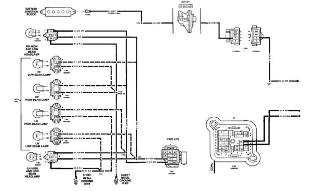

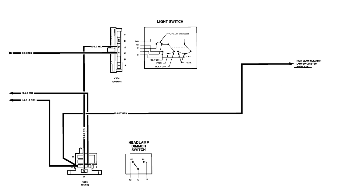

I installed a new bulb but no results. I changed the dimmer switch about a month ago, that's when i noticed the light didn't work at all. Please help me out. Thanks
Jul 15, 2022 at 8:28 AM
  • 55,732 POSTS

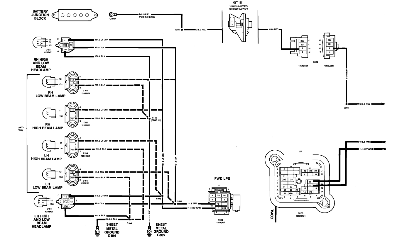

I would use a test light and test the light blue/green wire for power at the cluster when the high beams are activated. Here is a guide that will help, and I have found the headlight wiring diagrams so you can see how the system works.
