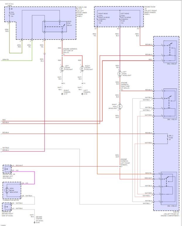

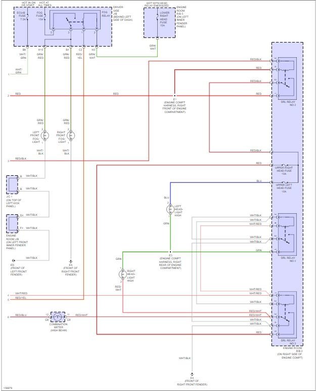

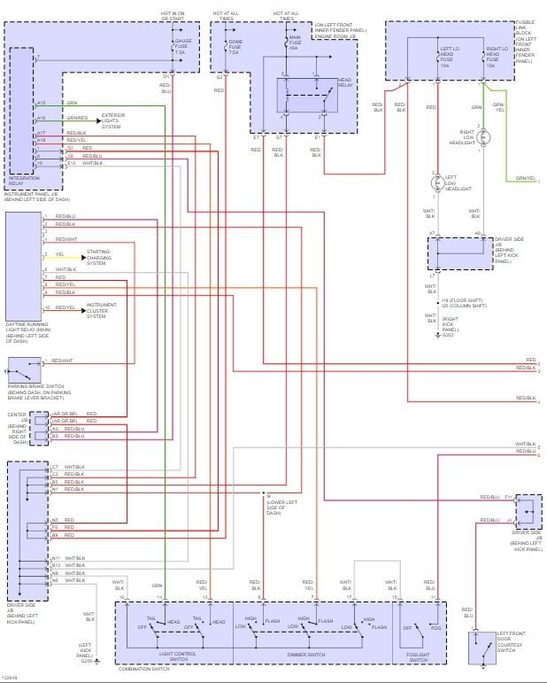

good morning.
I attached a wiring diagram for you to view. make sure you test for voltage at the headlight for the high beam feed with a test light or voltmeter to be sure there is power.
Also, check the fuse for the high beams for power to the fuse. Check for voltage on both sides.

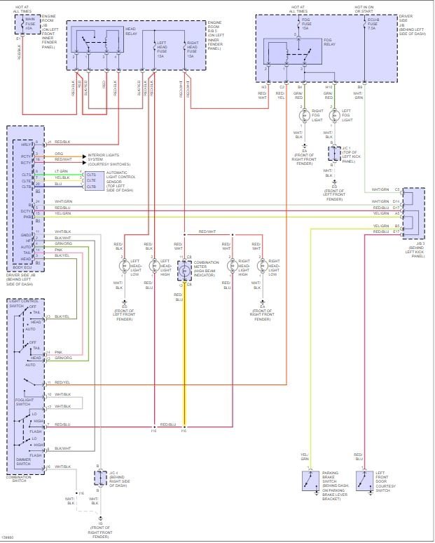

The diagram does not look like what I have in my car.

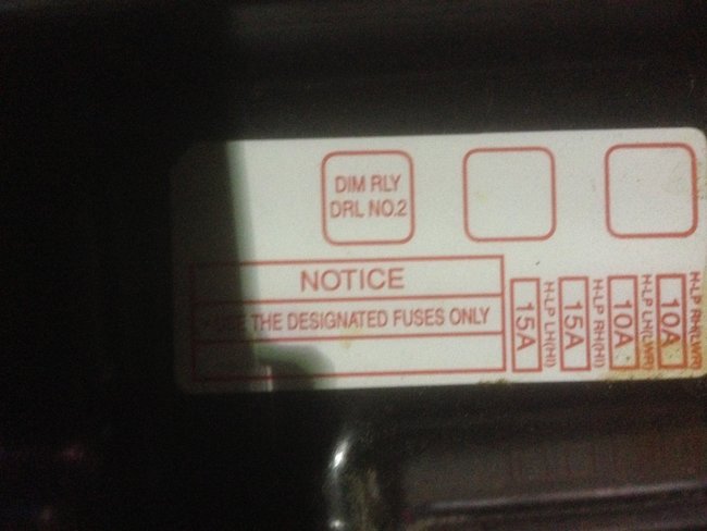

My car has four fuses for each lights and the relay is Dim relay ( please see the photo attached).
Car model is MCX10R Mark II Conquest.
Apr 16, 2018 at 7:16 PM
PATENTED_REPAIR_PRO
  • 1,853 POSTS
That is why I asked if this had DRL (daytime running lights) or not, because there are two different wiring diagrams and since you said no DRL, I gave you that wiring diagram. The DRL does have four fuses.

I should disclose that I am from Australia, are your diagrams for US models?

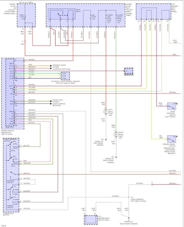

My car has four fuses for four lights and it does not have DRL (I searched all over the engine department but found no relay labeled DRL). I do not think I ever use it (DRL). Also, your DRL diagram shows that lower beams use 15A fuses, mine (from the photos I attached) shows that lower beams use 10A fuses.
According to wikipedia (https://en.wikipedia.org/wiki/Toyota_Avalon), 2002 Australia Avalon should be the first generation Avalon. However, when I looked at diagrams for first gen (from the old post, https://www.2carpros.com/questions/toyota-camry-1999-toyota-camry-high-beams ), the circuit without DRL does not match either.
I am trying my luck to see if anyone has my model's diagrams.
Apr 17, 2018 at 1:28 AM
PATENTED_REPAIR_PRO
  • 1,853 POSTS
You just showed me a relay that said DRL. Look again at your photo of DIM relay, it also says DRL #2.
Your second link says that is for a Camry, not an Avalon.

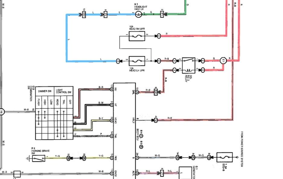

These from a 1999 Avalon with DRL, have 10a fuses.
Apr 17, 2018 at 2:36 AM

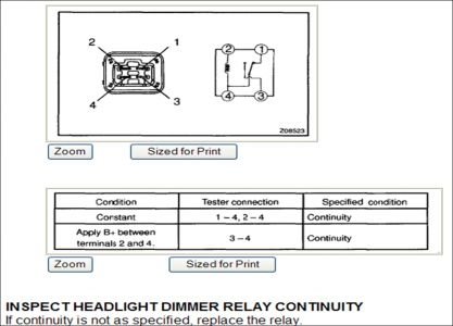

Thanks all for the answers so far. I think I found the problem.
Today I decided i will check the dimmer relay first. I took it out and check voltage between dimmer plug terminals.
1. 12 volts between two and four, which means the switch circuit is good, what a relief.
2. 12 volts between one and four, which is expected because the low beams work.
3. 12 volts between three and four, which means high beams circuit is good, voila. I connect them using a wire and high beams turn on.
So it is the dimmer relay is faulty, although I heard the click when high beams switched.
