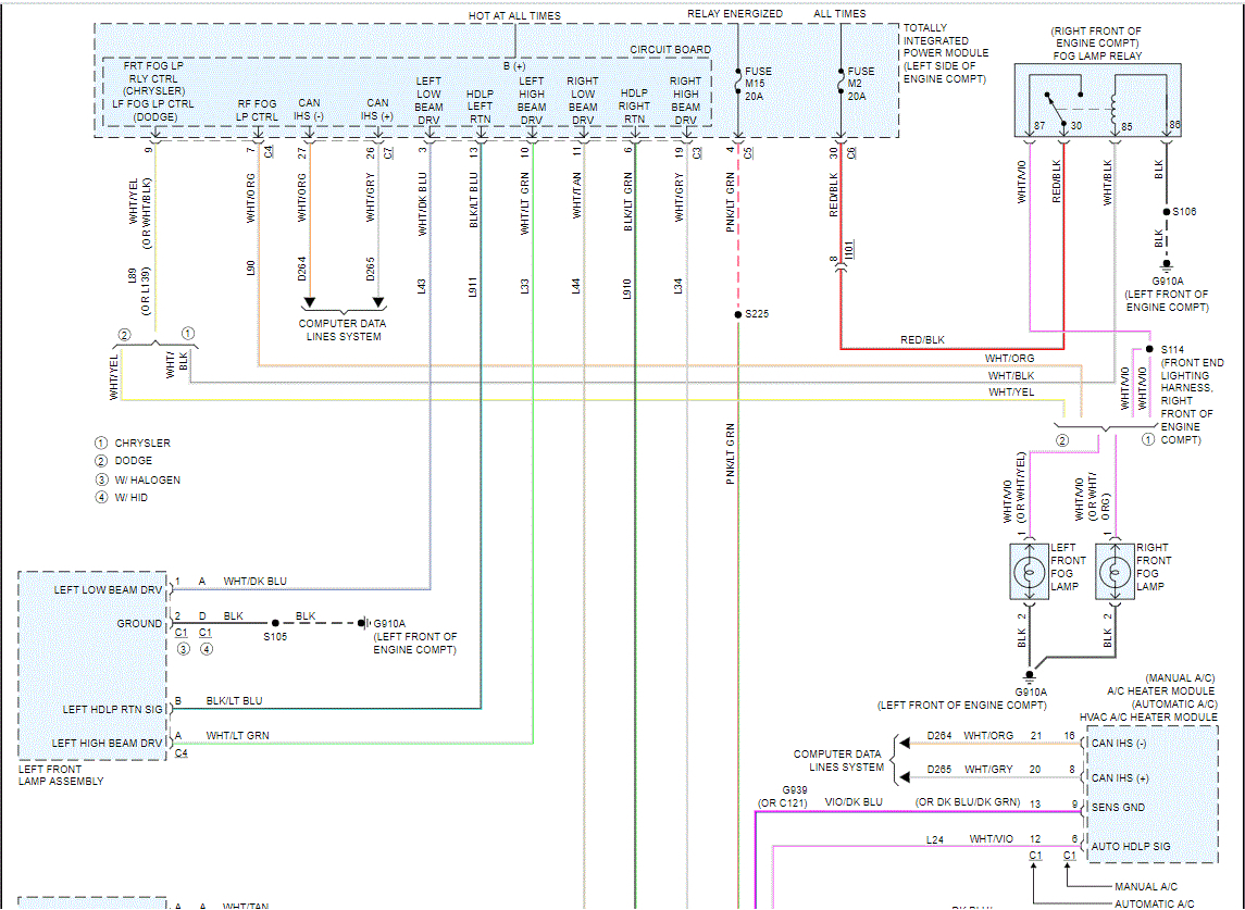

My passenger side high beam/day light won't work. I tested the bulb and it works fine. I know it isn't the switch because all other exterior lights turn on. It's just that one light. Any suggestions?

This vehicle has what is called a totally integrated power module (TIPM). They are pron to have issues with the tiny pins in the connectors corroding or breaking.

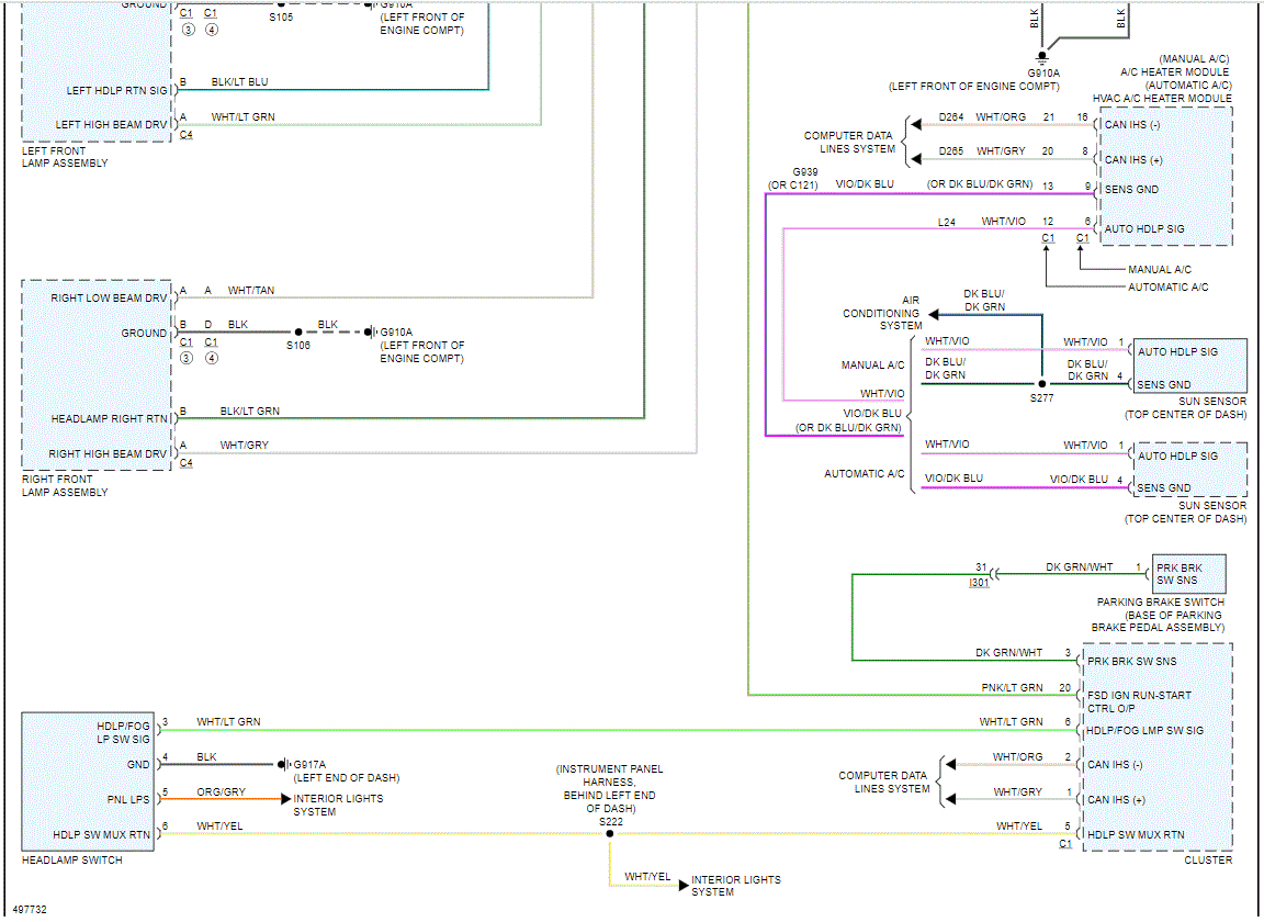

I attached two pics below which show the entire headlamp wiring schematic. Pic 1 shows the TIPM and you can see where the right high beam is powered from.
Here is what to do: At the headlamp assembly, there will be a white wire with a gray tracer. Check that wire to see if there is power when the light is turned on.
Do this and let me know the results.
