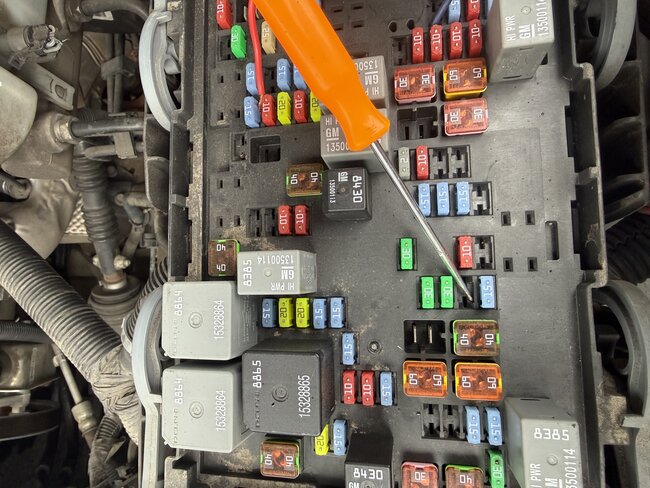

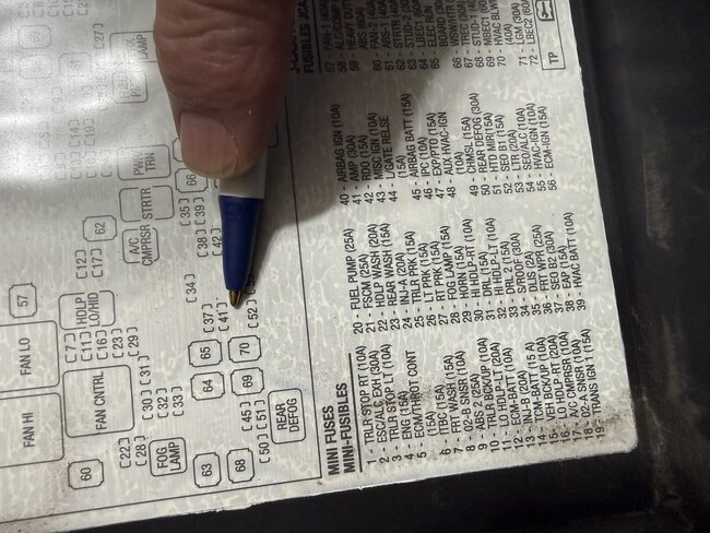

Tracking down the draw and found that a fuse that should be nonexistent when pulled the battery draw drops to 001 Milliamperes, this fuse is located between 41 and 52 in the main power distribution box. When this fuse is pulled I loose the power port and OBD port data. All the charts I have found all say that there should not be a fuse there. Any thoughts or ideas?

No. Fuse 53 is not where I’m at, if you look at the fuse chart and you see fuse 41 and then you skip a place and then the fuse 52, in the place that the chart shows a skip I have a fuse in the space that causes the excessive draw, removing that fuse causes my power port to stop working and the data stream also stops in the OBD 2 port. Truck runs fine. So why is that fuse there and why the excessive power draw and why the loss of data when all the ECM fuses are good. Nothing external is added to this truck.

They do not show a fuse between 41 and 52. So someone must have installed something in the blank slot? Can you upload an image of it so I can see, and you say nothing after market has been installed? Is this truck a hybrid? The power for the data port and the power port comes from fuse 53.

Here are the pics
Apr 2, 2026 at 3:37 AM
TENNISSHOES
  • 11 POSTS
Here is what I’ve got
Apr 2, 2026 at 3:38 AM
  • 55,402 POSTS
So you are pointing to an empty slot, no fuse goes in there and there is no metal terminals in that slot as well correct?

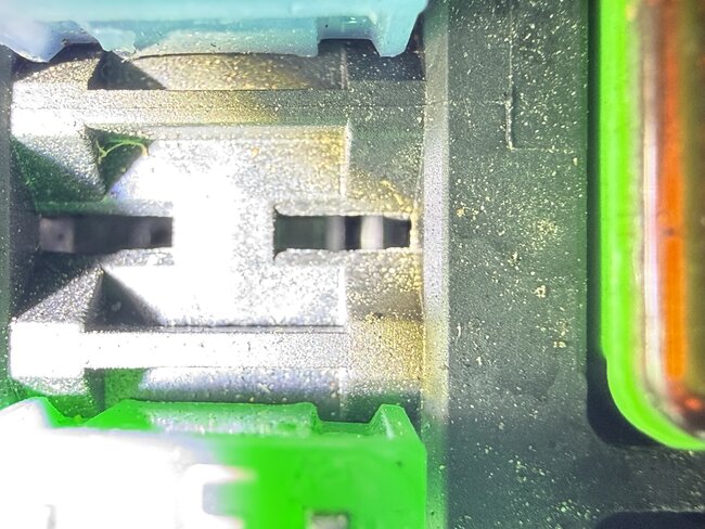

There are metal terminal connectors in the empty slot, yes or no?
Apr 2, 2026 at 4:21 AM
TENNISSHOES
  • 11 POSTS
Yes one got all the time the other has excessive draw on it.

Can you please upload an image of the fuse position straight down where the mystery fuse is located?
Apr 3, 2026 at 1:07 AM
TENNISSHOES
  • 11 POSTS
Tried too. Can’t really see the contacts even in direct sunlight, but you can just barely see the little tiny silver rings in each slot.
