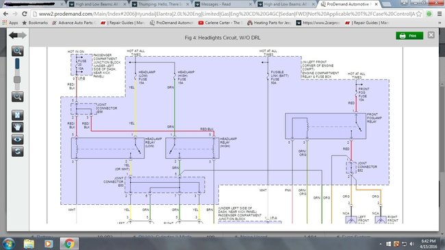

All headlights have gone out at the same time. I have replaced the headlight switch and relays. Any ideas on what is going on?

I'M LOOKING STRICTLY AT WIRE DIAGRAMS
TO GET ON THE CORRECT ONE
SUB-MODEL? SEDAN/ HATCHBACK?
I NEED TO KNOW IF YOU HAVE "AUTOLAMPS" OR "DRL"?
ALSO WHAT SORTA RECENT HISTORY MAY HAVE CONTRIBUTED TO THIS PROBLEM?
LIKE JUMP STARTING/ ACCIDENTS/ NEW PARTS?

Its sedan the lights are not auto. Right before this happened I had to replace passenger headlight bulb then 2 days later all 3 brake lights went out which caused me to have to replace the brake light switch. The next day all headlights quit working. The blue light in dash that indicates bright lights on isn't even working

OK

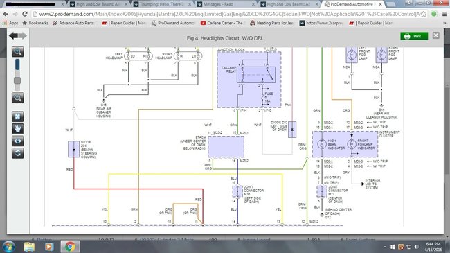

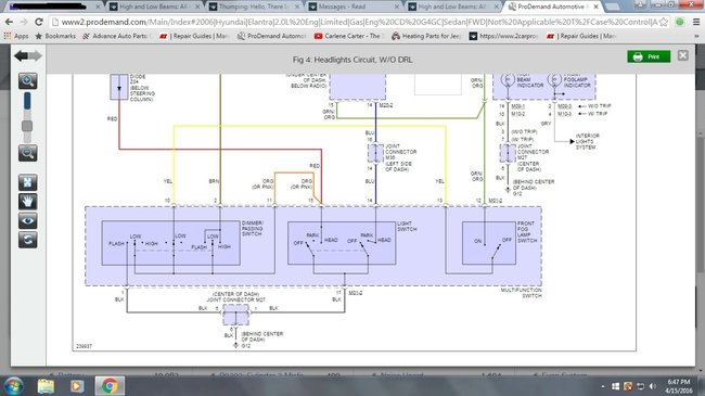

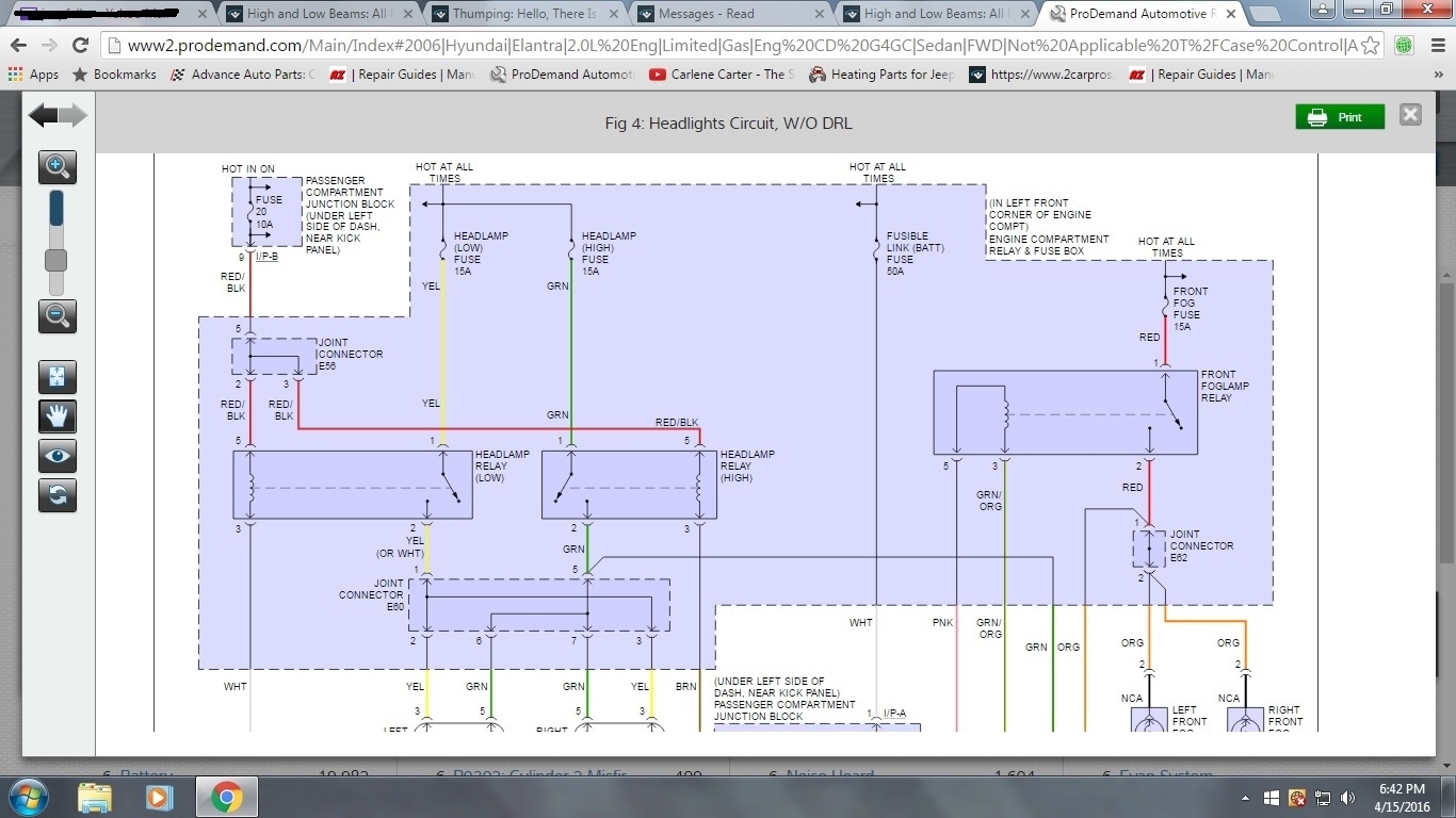

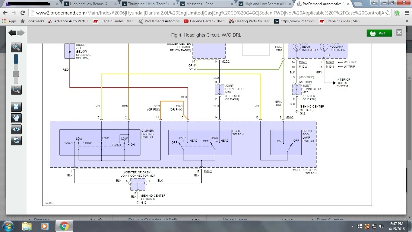

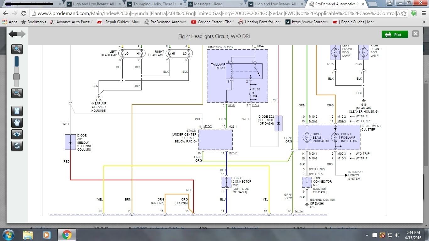

I SCREENSHOT THE WHOLE DIAGRAM IN "PRODEMAND"
I WILL POST THEM IN ORDER TOP TO BOTTOM (THIS IS ONE DIAGRAM CHOPPED INTO THIRDS)
IF YOU CAN PRINT 'EM, I MADE THE SHOTS OVERLAP SO YOU CAN TAPE IT TOGETHER AND NOT MISS NUTHIN'
THIS DIAGRAM IS "NO DRL" (NOT AUTO LAMPS EITHER) SO I RECKON IT'S JUST REGULAR OLE PLAIN JANE LIGHTS
IF YOU WILL LOOK IT OVER WELL, YOU WILL SEE FUSES/ RELAYS/ SWITCHES/ ETC ALONG WITH THE LOCATIONS OF EACH
JUST SORTA GUESSING FOR A POSSIBILITY. LOOK AT THE SECOND PIC, LEFT SIDE, BOTH HEADLIGHTS. THERE IS A GROUND "G15" SEE IF IT IS CONNECTED, MAYBE LOOSEN IT UP AND INSURE IT'S GOT A GOOD CONNECTION (IT'S LOCATION IS LISTED)
THERE ARE OTHER ITEMS THAT ARE IN THE DIAGRAM THAT OPERATE THE LIGHTS, I'D ALSO CHECK FUSES AND FUSIBLE LINKS. IF MR. MULTI-FUNCTION SWITCH HAS HAD A HARD LIFE, DON'T RULE HIM OUT EITHER.
I WAS AT A PARTS STORE RECENTLY AND A CUSTOMER WAS COMPLAINING ABOUT HER TURN SIGNALS NOT WORKING. I SAID "MAYBE IT'S THE MULTI-FUNCTION SWITCH THAT IS SORTA BARELY HANGING/ FA-DANGLIN' OFF OF THE COLUMN."
SHE SAID, "I KNOW THAT'S NOT THE PROBLEM, IT'S BEEN LIKE THAT FOR A LONG TIME"
HERE'S HER SIGN!
LEMME KNOW IF THIS HELPS, IF IT'S THE WRONG DIAGRAM, SEND YOUR VIN, I'LL TRY AGAIN!
