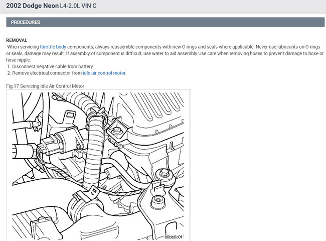

When I start my car, it automatically starts revving up. It stays revving up when I'm going. I drove it on the bypass doing 70 MPH and I never touched the gas pedal. At the stop light I had to put it in neutral and it stayed revved up. Then of course it starts to overheat from it idling so high. The code reader said it could be several sensors, but I was hoping to narrow it down.
Aug 9, 2022 at 6:51 AM
  • 55,051 POSTS

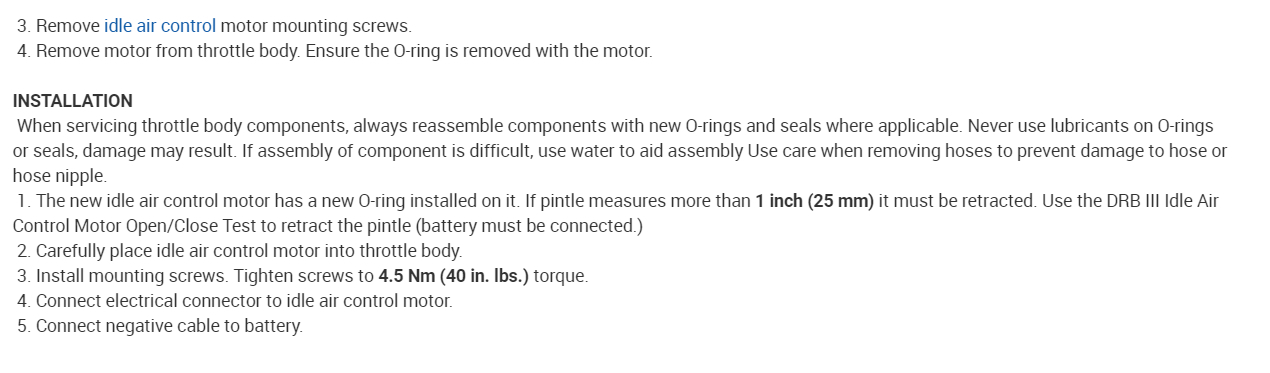

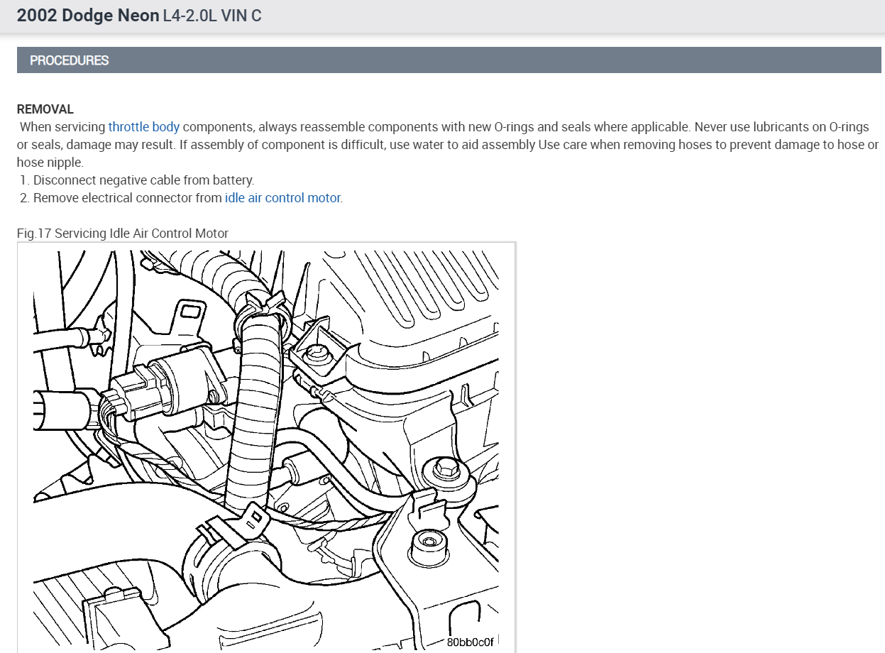

What codes are they? It is probably your IAC motor that is stuck or not working, I would remove the IAC motor and use carburetor cleaner to clean out the passages. Here is the location of the IAC in the images below. This guide may help as well:
https://www.2carpros.com/articles/engine-idles-too-high
