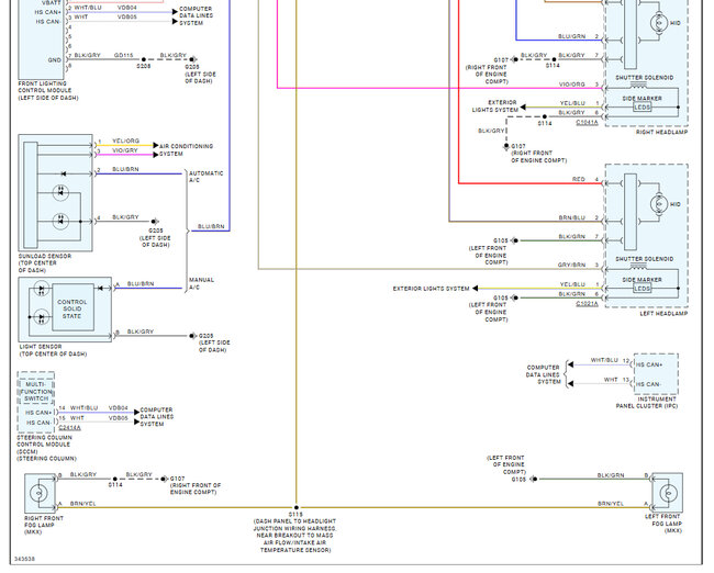

Passenger side headlight stopped working and replaced the ballast and the bulb it worked for a short trip about 30 miles and quit appears to be no power to the plug at all. Also adaptive headlight check adaptive headlights more light came on now the code reader says it's lost communication to the A headlight fuses. All look good. What else can I check?
Jul 22, 2026 at 1:09 PM
  • 55,746 POSTS

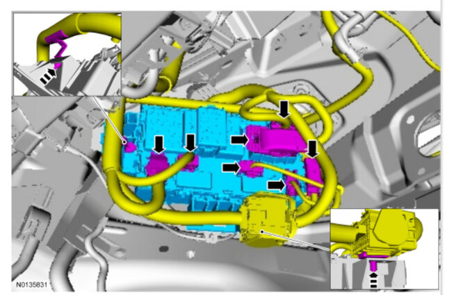

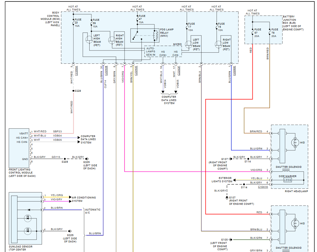

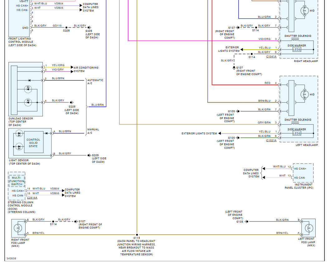

This can be a bad BCM, but there are 7 fuses that run the system so we need to check all of them, here are the fuses and there location in the image below. I also included the wiring diagrams so you can see how the system works. To see if the BCM is bad lets do a CAN scan, this video can show you how.
CAN SCAN - https://youtu.be/u-4syLc-ifQ
Check out the images (below). Let me know how it goes

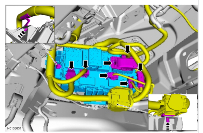

Here is the location of the BCM which is under the dash on the drivers side. in case you need to change it out. Also, I would try removing the electrical connector at the BCM to see if there are corroded or melted. Disconnect the battery first.
