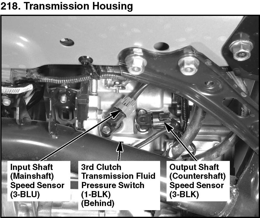

Hi, where is the input shaft speed sensor located?
Apr 22, 2018 at 1:09 PM
WRENCHTECH
  • 20,761 POSTS
You can access it from below.

Thank you for your fast answer. i have been looking with that picture still no luck. can you please be more specific where is located? thank you so much.
Apr 22, 2018 at 2:06 PM
WRENCHTECH
  • 20,761 POSTS
That view is the front of the transmission from below. You may have a splash panel to remove.

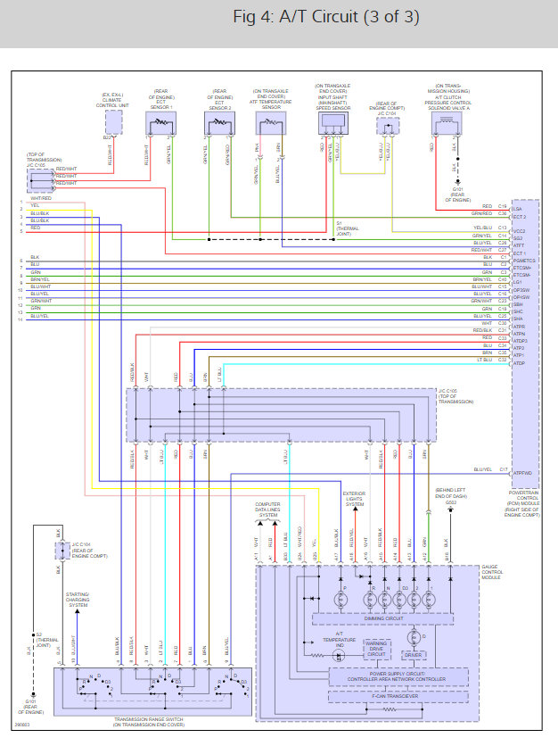

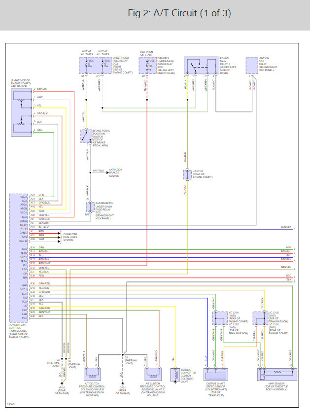

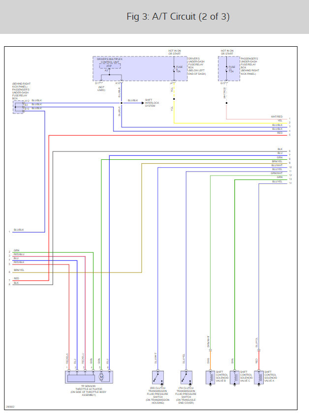

  • 54,837 POSTS
I do not think it is a shift control solenoid. It sounds more like you have a wiring issue. Lets run through this guide.
Please check the connection for the speed sensors to the PCM.
Here are the transmission wiring diagrams to help you see how it works.

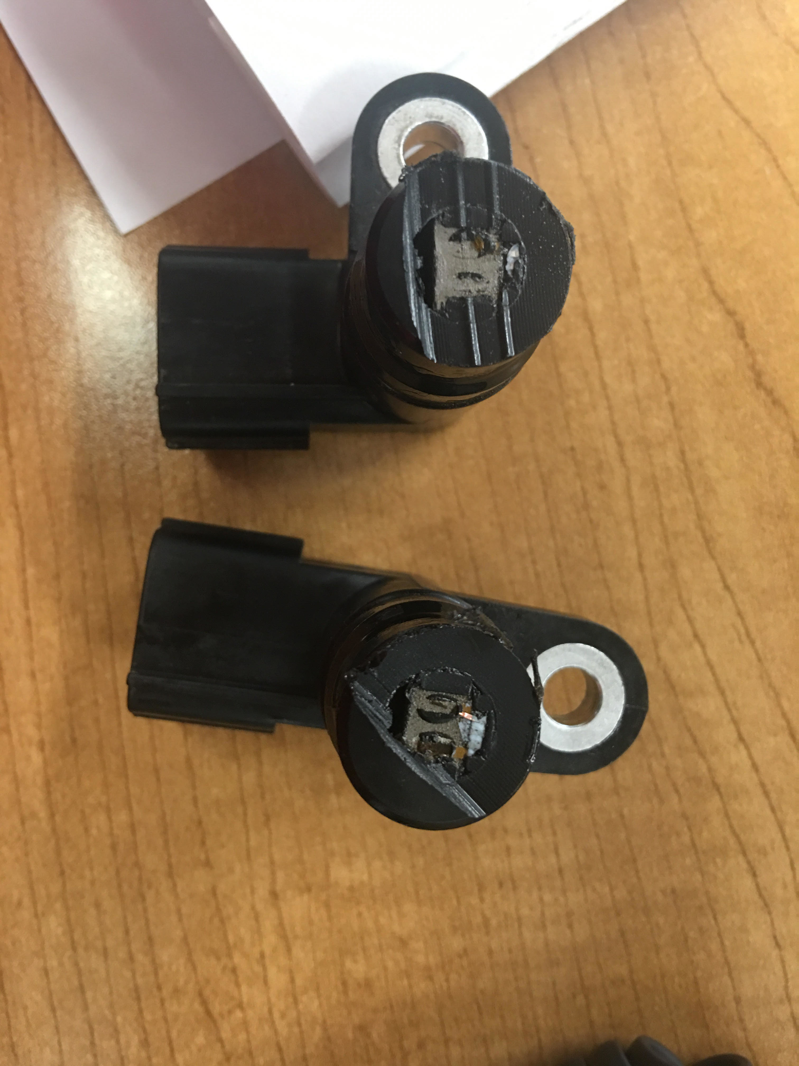

Hi, the sensors I removed (the originals) looks like the one in the picture. After replacement it did not work I took it to the Honda dealer and they removed the sensor that are the ones on the picture and say they need to replace it and flash the transmission and reprogram the ECU. An $800.00 job. After a week of calling and no straight answer they said they replace the sensors and still doing the same thing the said I need to replace the transmission. Any ideas? I think they just do not want to spend more sensors and time and they are going for the easy part replace the transmission for $4,200.00.

Image.
May 3, 2018 at 6:54 AM
  • 54,837 POSTS
Yes, you have a bearing going out allowing the internal part of the transmission moving inward which causes the sensor to have contact with the sensor, but I have heard of people using a spacer to move the sensor away form the timer wheel inside the transmission. I would try that first.

VICARUN
  • 8 POSTS
That is what I was thinking, I just do not know how far the sensor could be to cause damage and continue reading, but I will try it. Thank you.
May 3, 2018 at 11:38 AM
Okay, that sensor is really bad. The damage comes from the inside moving all over the place.
On this one the dealer is correct. You have internal damage and transmission will have to come out. There is no way of cheating this one.
