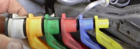

I need to replace the low/hi press. hoses and they have those round type locking connectors( one going into the condenser,the other into the dryer.What kind of tool I need to loosen the locking connectors?. Thanks for your help...

Take a look at the picture. I just want to make sure we are talking about the same type of line.

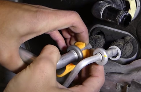

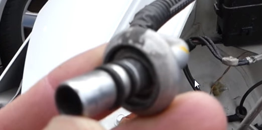

If it is then you need to use a fuel line disconnect tool to release these. Take a look at the pictures.
Basically you just need to push it in and hear a click then the spring inside is released and then turn the line back and forth to slide it off.
Let me know if you have questions. Thanks

Yes Sir, that's the type.Thank you much for your help,appreciate it..
