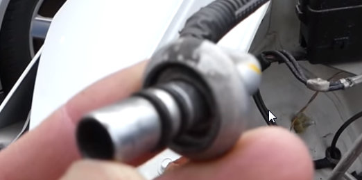

I need to replace the low/hi press. hoses and they have those round type locking connectors( one going into the condenser,the other into the dryer.What kind of tool I need to loosen the locking connectors?. Thanks for your help...
Jun 11, 2020 at 7:46 AM

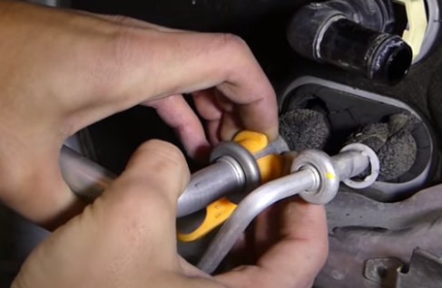

Take a look at the picture. I just want to make sure we are talking about the same type of line.

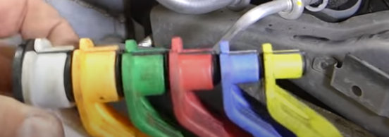

If it is then you need to use a fuel line disconnect tool to release these. Take a look at the pictures.
Basically you just need to push it in and hear a click then the spring inside is released and then turn the line back and forth to slide it off.
Let me know if you have questions. Thanks
