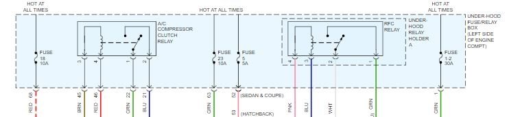

My AC stop working, and I would like to try this before I take for service. Thanks for your help.
Jul 28, 2018 at 9:05 AM
  • 110,244 POSTS

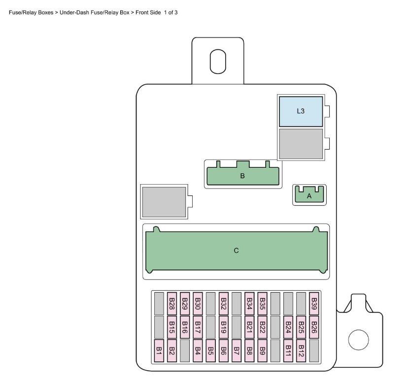

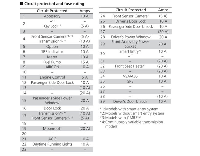

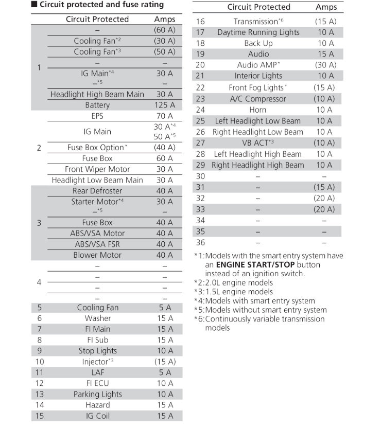

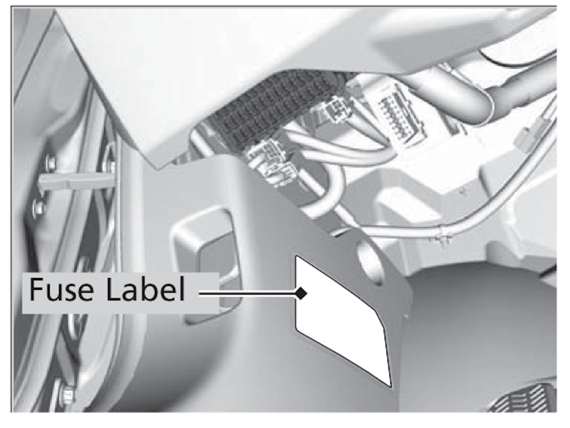

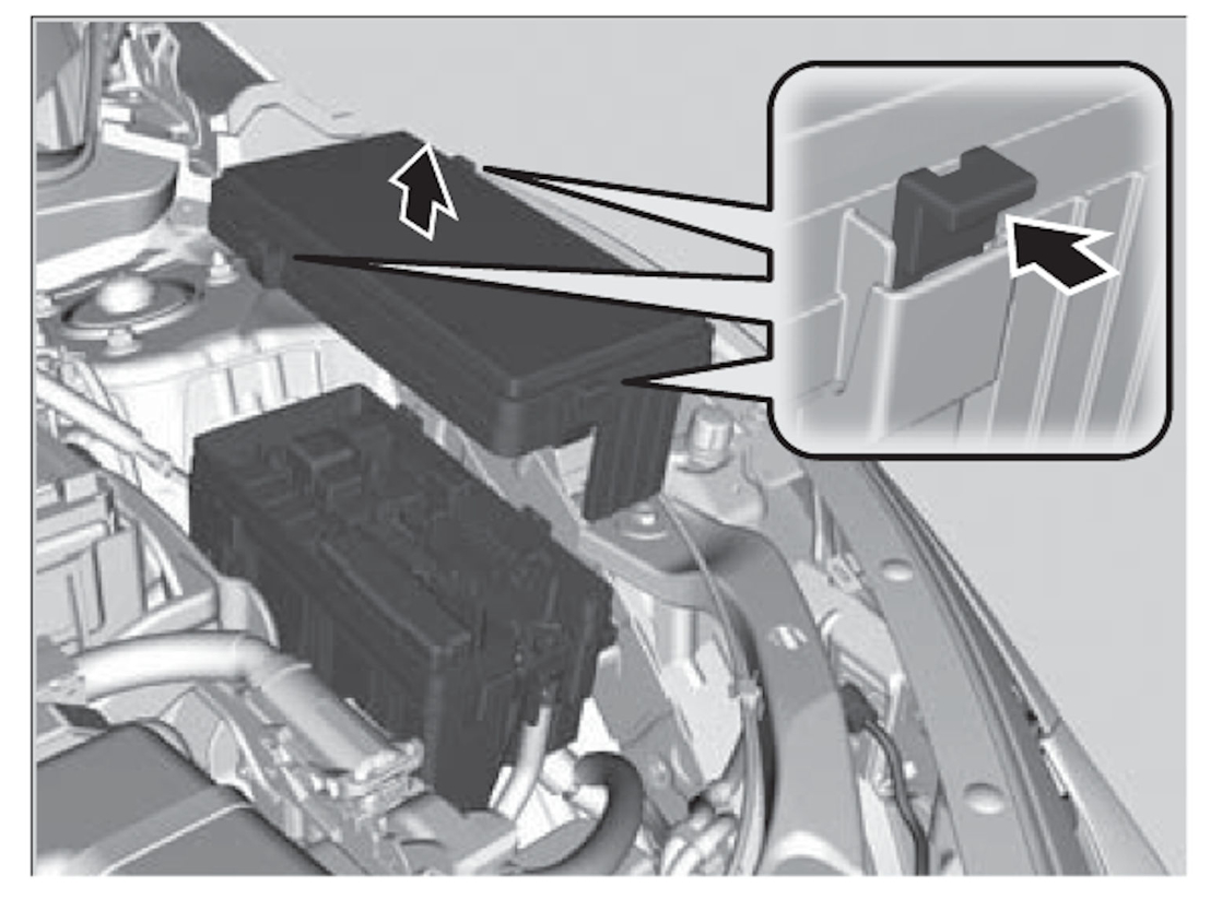

The relay is located in the under hood relay/fuse box. It is on the left side of the engine compartment. Here is the legend and locations of all fuses. The pictures correlate with these directions. One box is under the hood and the other in the vehicle. Also, when you remove the cover from the box, on the lid it will list what each component does. I have attached a wiring schematic for you to see where the relay is as well.
Here is a link which describes how to check a relay:
I hope this helps you. Honestly, any issues should be under warranty. The vehicle has a three year 36,000 mile bumper to bumper warranty. My only concern is if you do something, they may say it is your fault and not cover the repair. It is just a thought.
Check out the diagrams (Below). Please let us know what you find.
