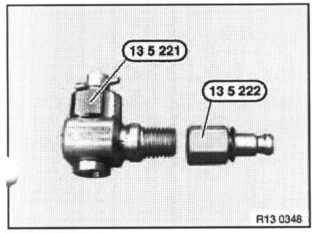

Prepare special tool kit 13 5 220 (consisting of 13 5 221 and 13 5 222).
Connect special tool kit 13 5 220 to pressure sensor of DIS Tester.

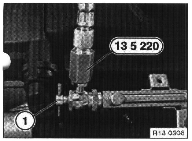

Remove dust cap (1) from measuring valve on fuel rail.
Picture 4
Unscrew check valve (1) on special tool so that valve remains closed in fuel rail.
Attach special tool kit 13 5 220 to fuel rail and tighten down firmly so that sealing ring in special tool is sealed.

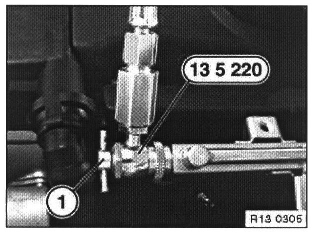

Picture 5
Start engine.
Screw in check valve (1) on special tool until a pressure reading is displayed at DIS Tester.

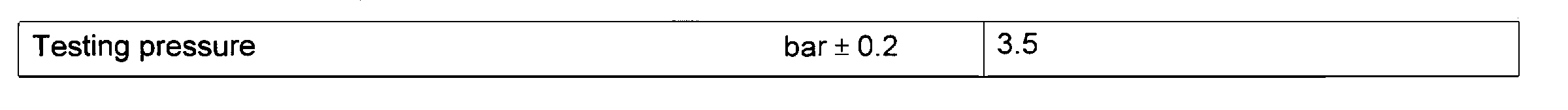

Test pressure,
refer to Technical Data.

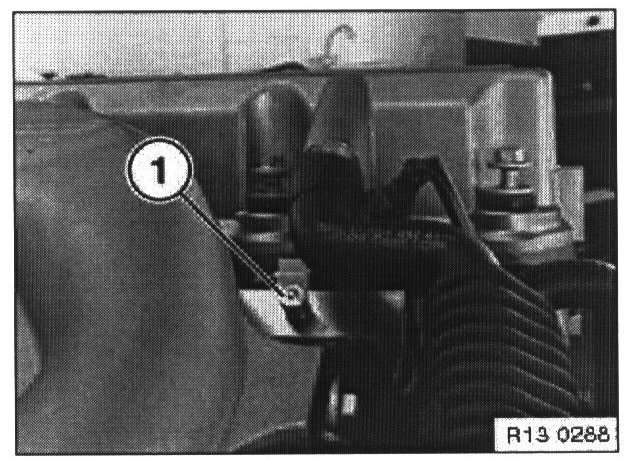

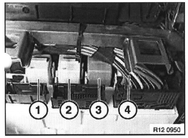

Checking fuel pump:
E39:
Detach fuel pump relay (2).

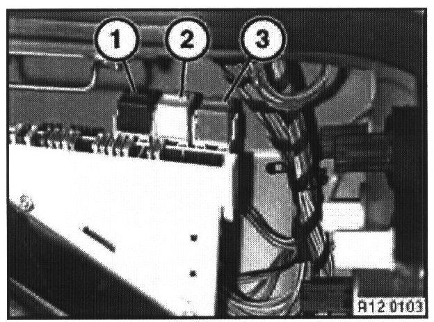

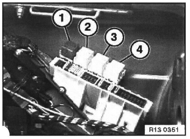

Picture 9
E46:
Remove fuel pump relay,
Picture 10
E38:
Picture 10

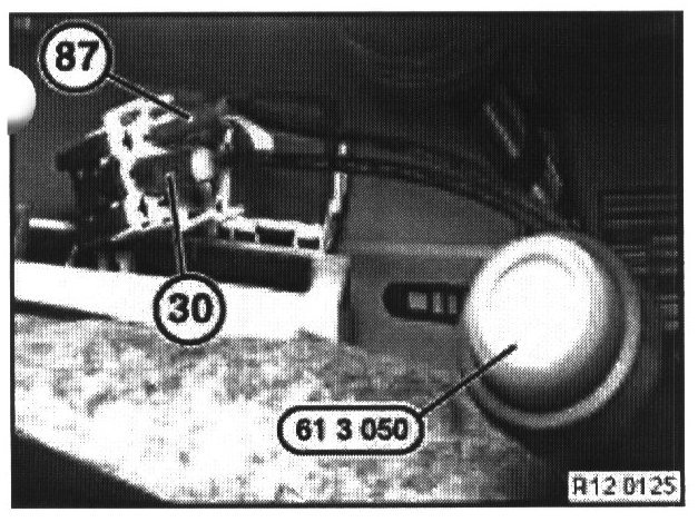

Connect up special tool 61 3 050 to terminal 87b and terminal 30.
Operate button for approx. 10 sec and read off delivery pressure at DIS Tester.
