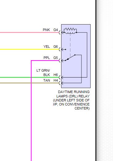

Hi Beams Low Beams Dont Work On My Headlights

I tapped into the high beam wire harness for my headlights and I put to secondary lights on the bumper it blew something out I don't have high beams or low beams at all even after I took the wire off what do I do

check item in pic to see if power is coming to it. if you have quad headlights or sealed beam it's the same. then check fuses in truck for drl if stillnot working have scanned as you may have burnt out the drl module. Next time try wiring into under hood fuse box with a fuse and relay for lights you are installing.
