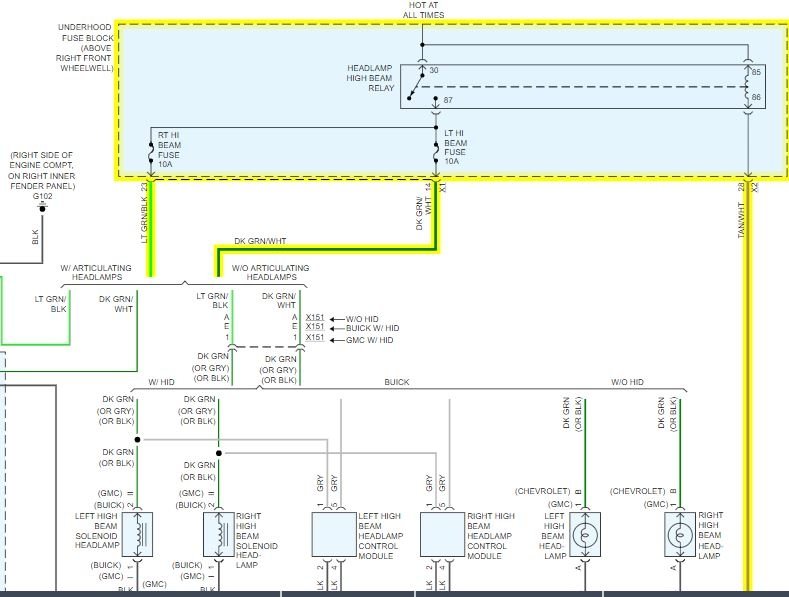

why wont my high beams stay on?
Oct 2, 2019 at 4:33 AM
Experienced Mechanic
52,796 POSTS
Good afternoon.
There is a relay and fuses for the high beams.
I attached a diagram for you to view. You will need to check for power to the relay and the fuses.
Let me know when you are ready to do some testing.
