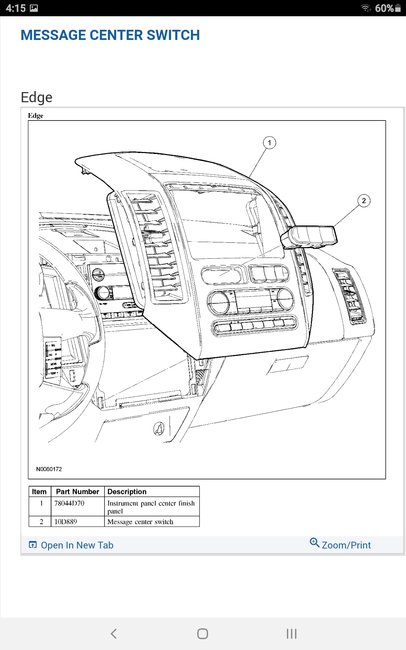

I bought the vehicle listed above last September and the clock wasn't on and it been like that. so i was wondering if the clock is under radio fuse or what? i didn't want to mess it up if i decide to put new fuse for the radio and see if the clock will come on.

The clock is part of the radio and is powered through the same fuses. If the radio is working and the station memory is working the issue is internal to the radio and changing fuses won't change that. You would have to replace the radio to get the clock feature to work.

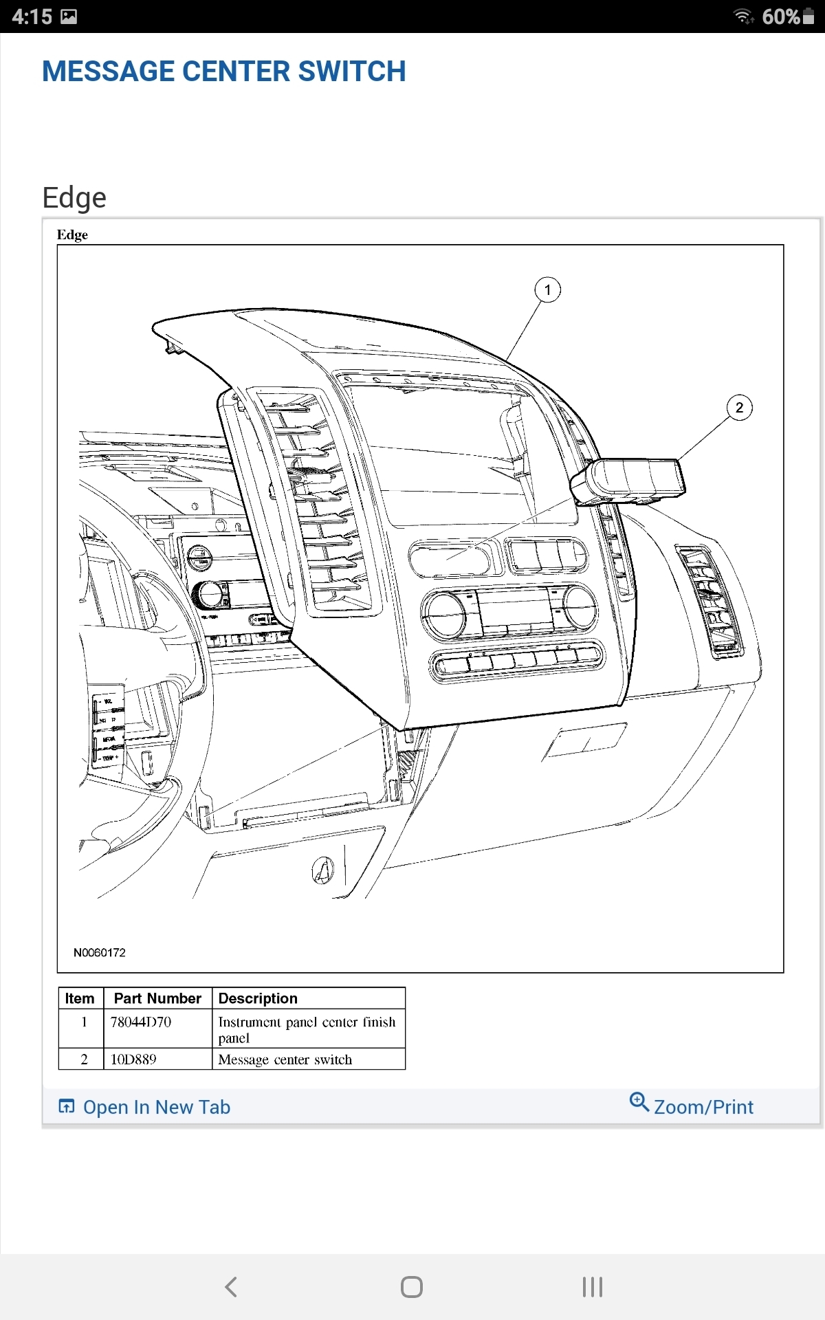

Your center dash will pop right out and you will be able to get to the mounting screws to get the radio out. The clip are at the four corners of the panel. Here is a picture that shows the clip locations.
Pull the instrument panel center finish panel straight out to release the retainer clips and remove the instrument panel center finish panel.
- Disconnect the electrical connectors.
Press the 4 retaining tabs and remove the message center switch.
To install, reverse the removal procedure.
