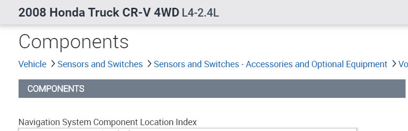

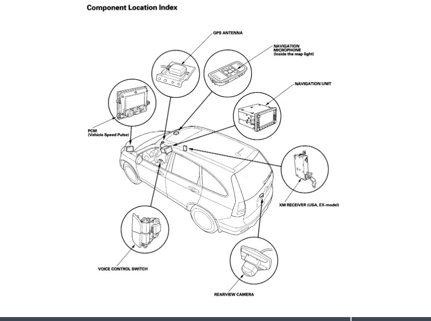

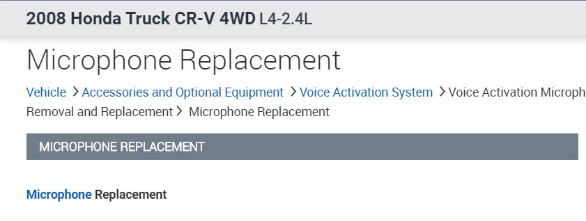

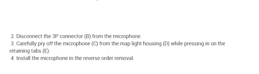

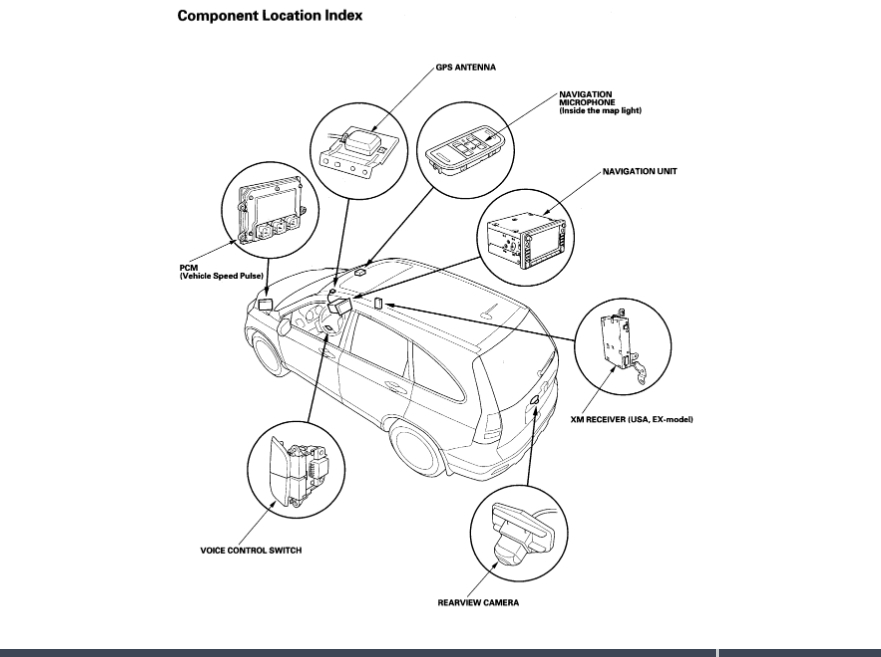

Where can i find my HFT module on the car listed above.
Nov 23, 2019 at 1:06 AM
SCGRANTURISMO
  • 4,897 POSTS

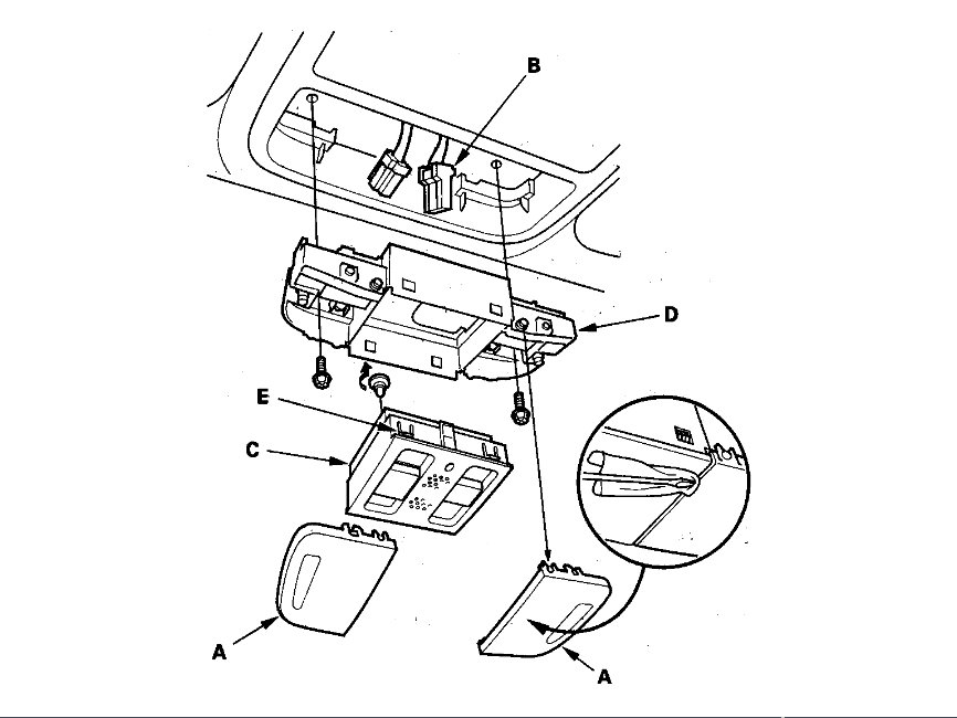

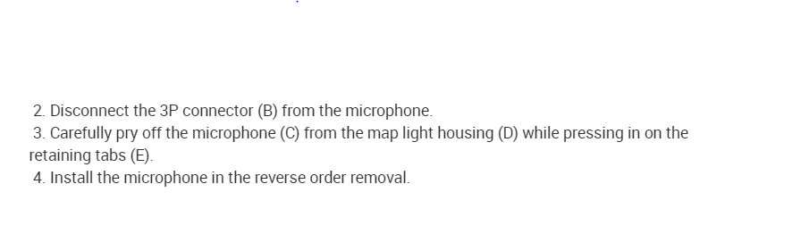

In the diagrams down below I have included a diagram of all of your vehicle's Navigation system components, including their locations on the vehicle, and the instructions for the removal and installation of your vehicle's hands free microphone. Please go through these guides and get back to us with what you are able to find out.
Thanks,
Alex
2CarPros
Nov 23, 2019 at 6:40 AM
RON JONES2

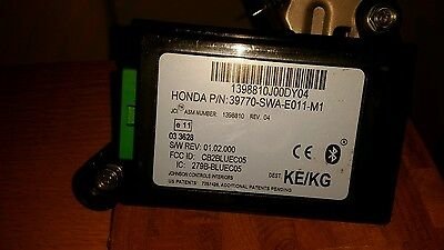

Hi, this is the part i am looking for Honda CRV Bluetooth Module Unit 39770-SWA-E011-M1.
Nov 23, 2019 at 3:40 PM

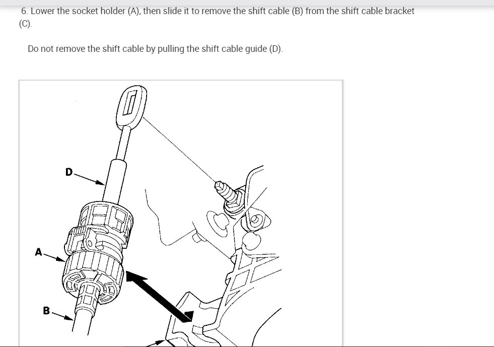

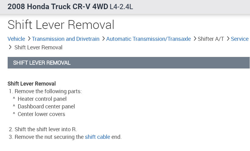

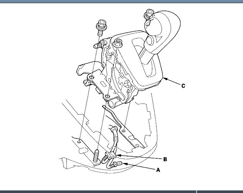

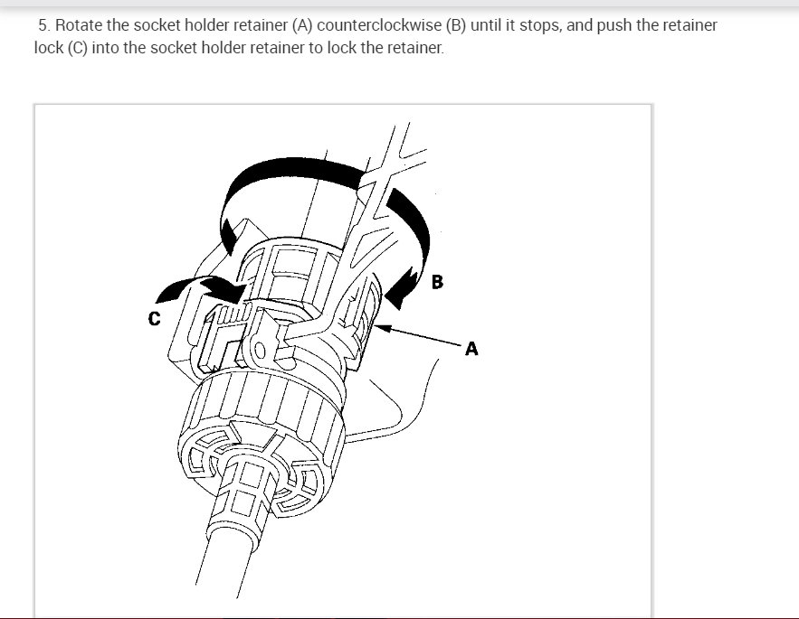

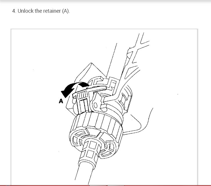

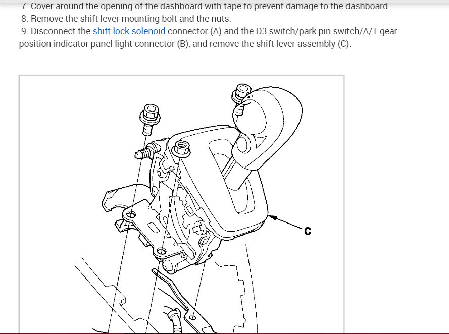

RON JONES2
Hi again I have found it just below the gear stick.Can you tell me how to remove the plastic covers surrounding the gear leaver?
Nov 23, 2019 at 4:07 PM
SCGRANTURISMO
  • 4,897 POSTS
Hello again,
Okay, I have included the guide for the removal of the Shift Selector in the diagrams down below. I hope that this helps out. Please go through this guide and get back to us with what you are able to find out.
Thanks,
Alex
2CarPros
Nov 24, 2019 at 12:18 PM
