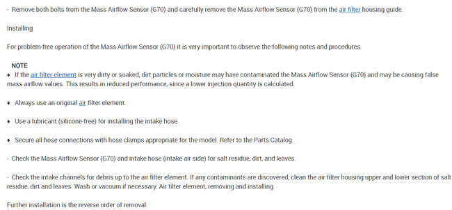

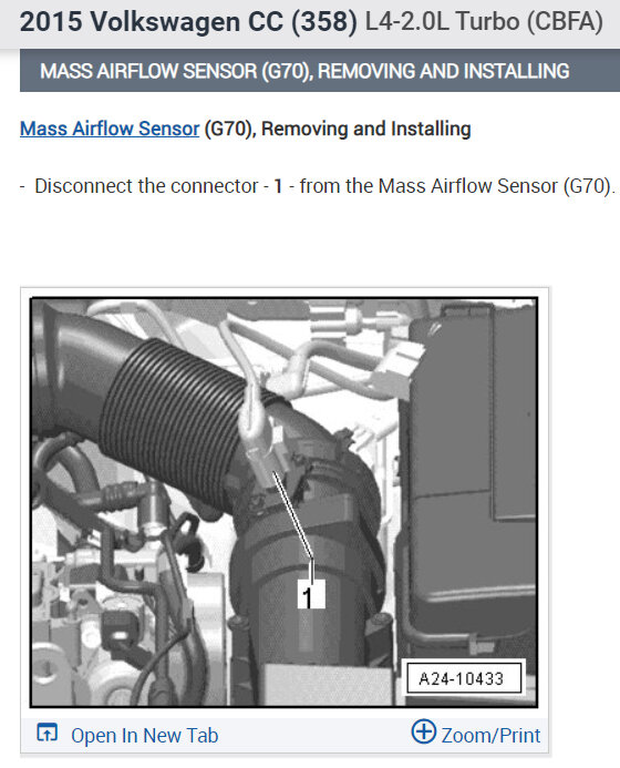

Thanks for the videos, it helps. I have seen the MAF sensor cause this problem because the sensor wire goes bad at it shows less air going into the engine. That actually is which makes the computer give the engine less fuel. At this point cleaning it will not help, and the sensor needs replacement. You can compare the readings from the new sensor to the old one to confirm the sensor failure. Check out the images (below). Please let us know what happens.
