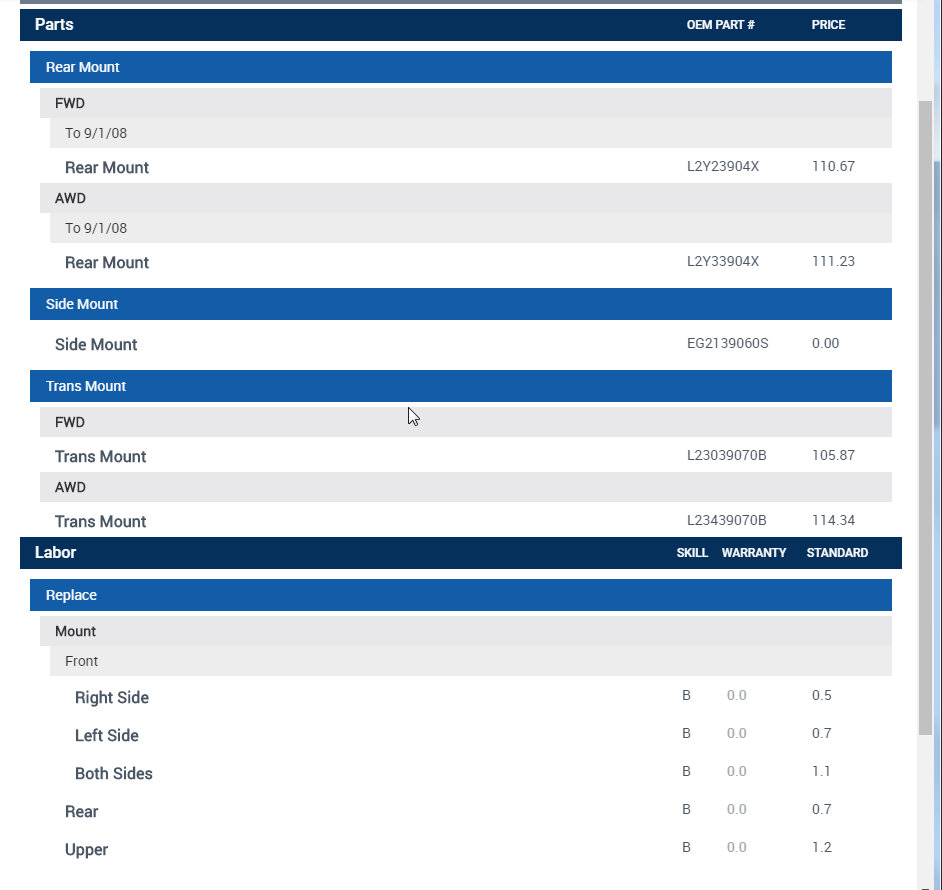

This is normally caused a failed engine mount or transmission mount. Basically when they fail and the AC adds the additional load or stain to the engine it causes it to shake. More than likely it will get worse and start shaking or vibrating all the time.
There is a chance that there is a vacuum leak but I would start with the mounts.
Here is a bunch of info on the mounts. Let me know if you have questions.
https://www.2carpros.com/articles/how-a-motor-mount-works
https://www.2carpros.com/articles/replace-motor-mounts
https://www.2carpros.com/articles/vibration-noise
