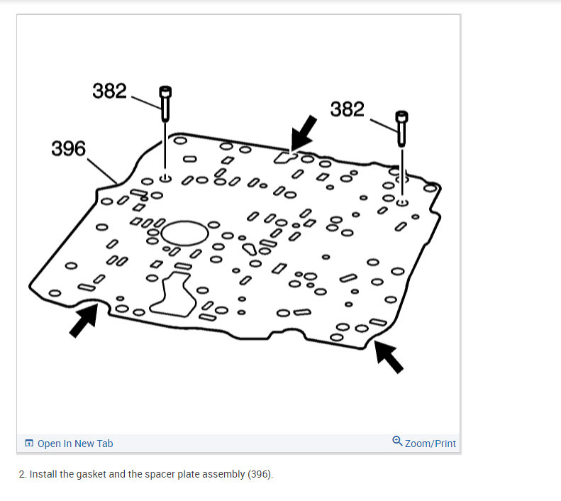

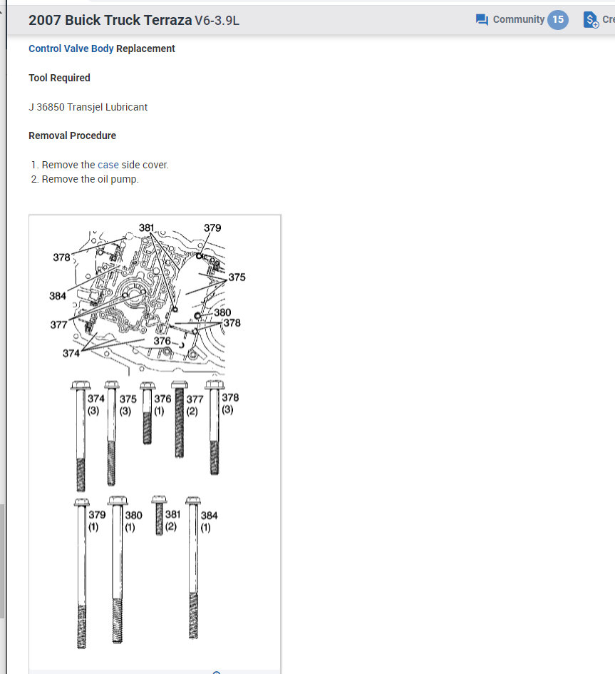

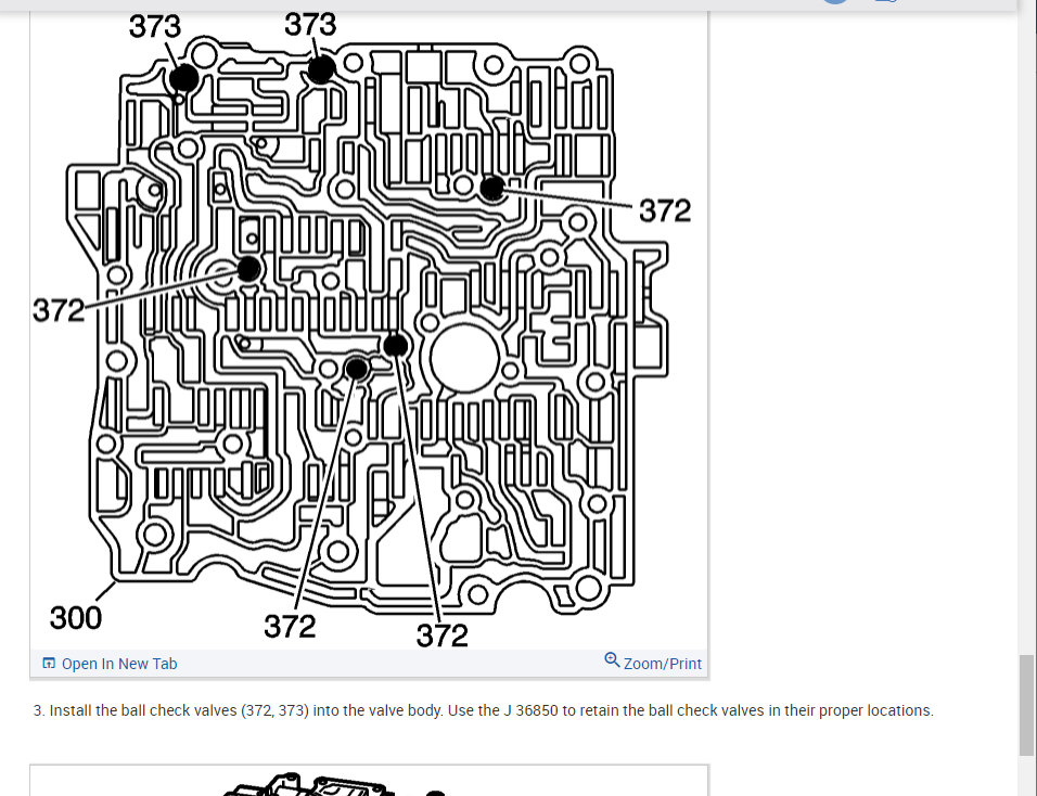

Jun 18, 2021 at 1:00 AM

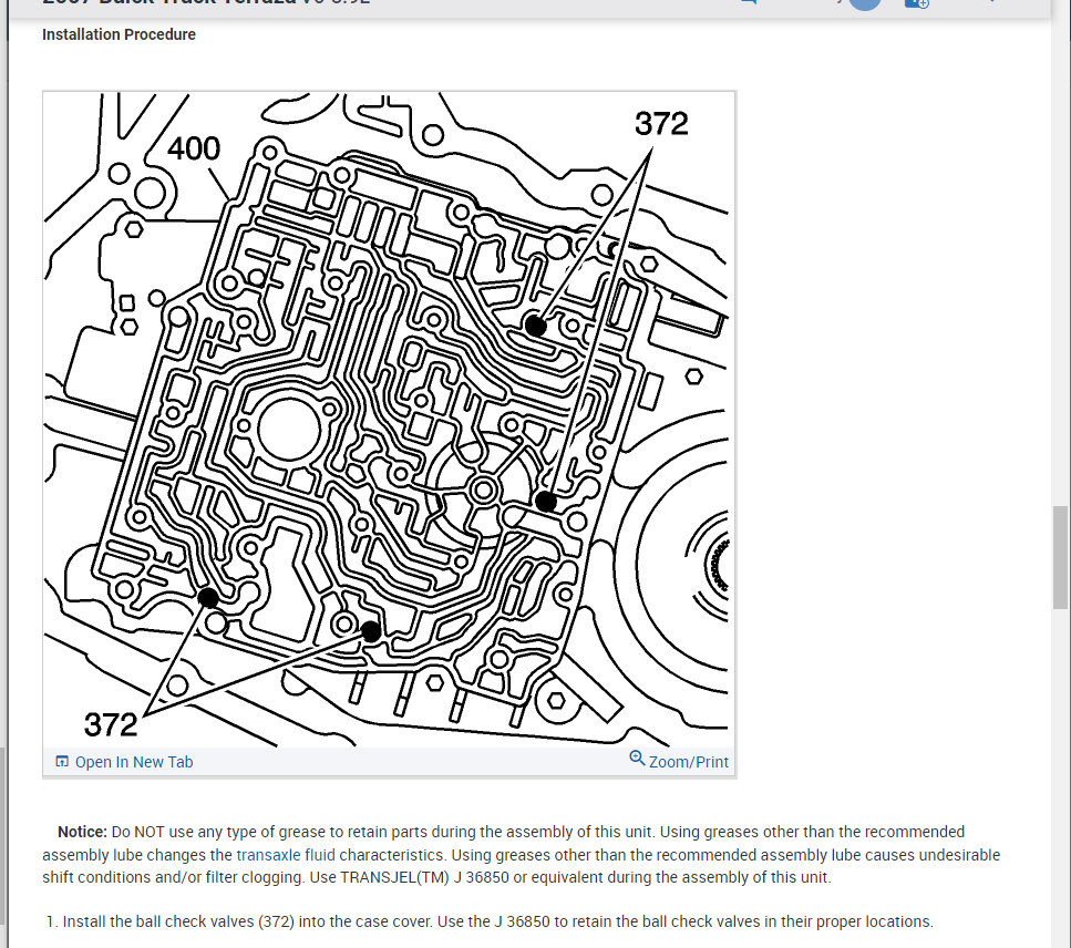

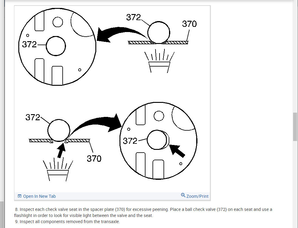

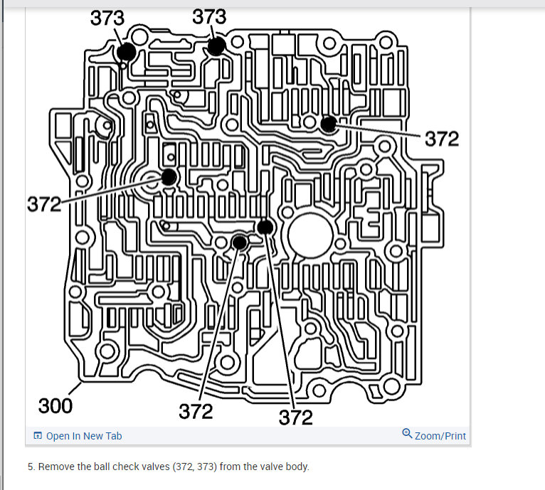

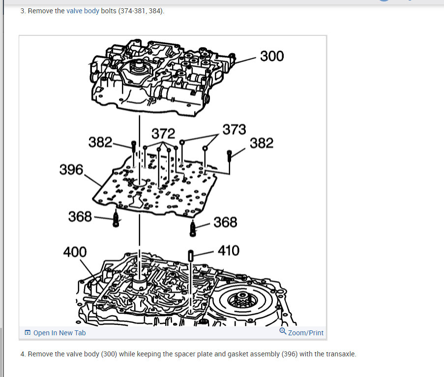

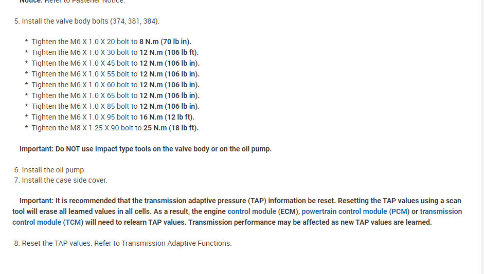

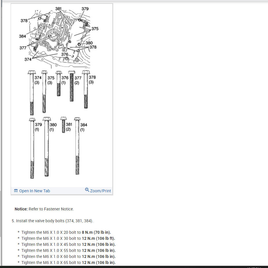

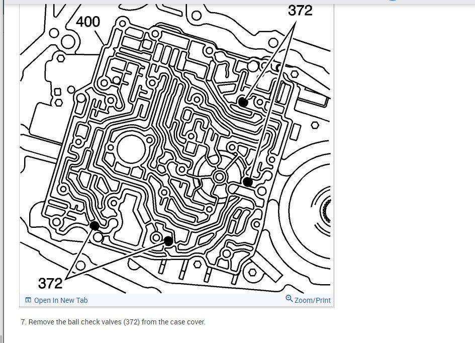

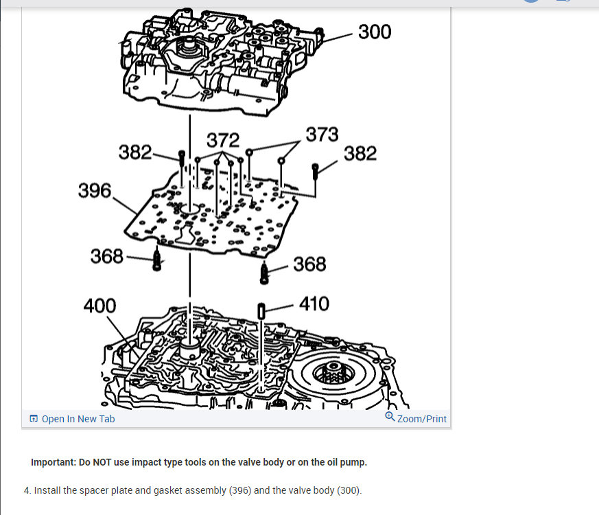

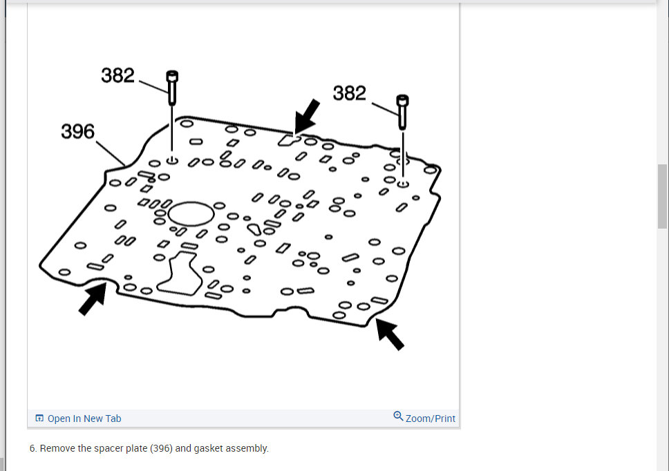

You do have to remove the side pan but you do not have to remove the interior portions of the unit.
I attached the entire process for your review.

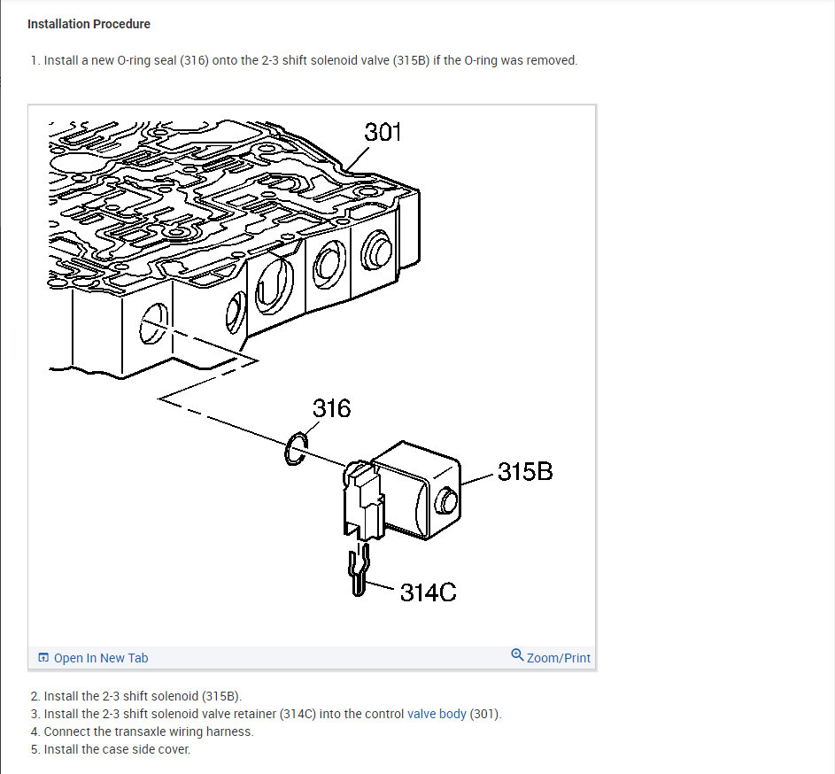

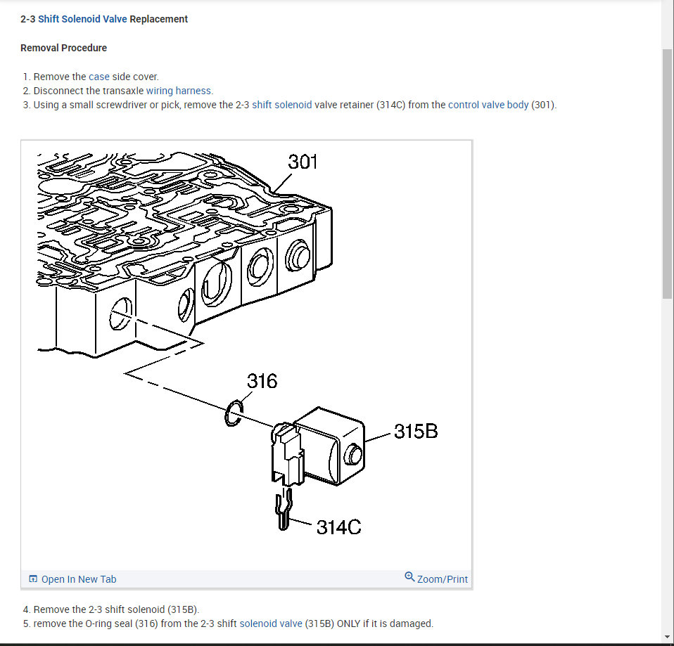

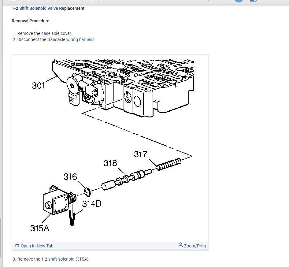

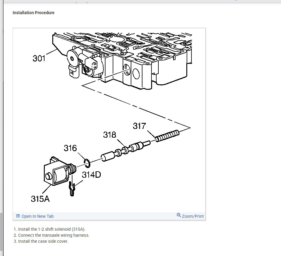

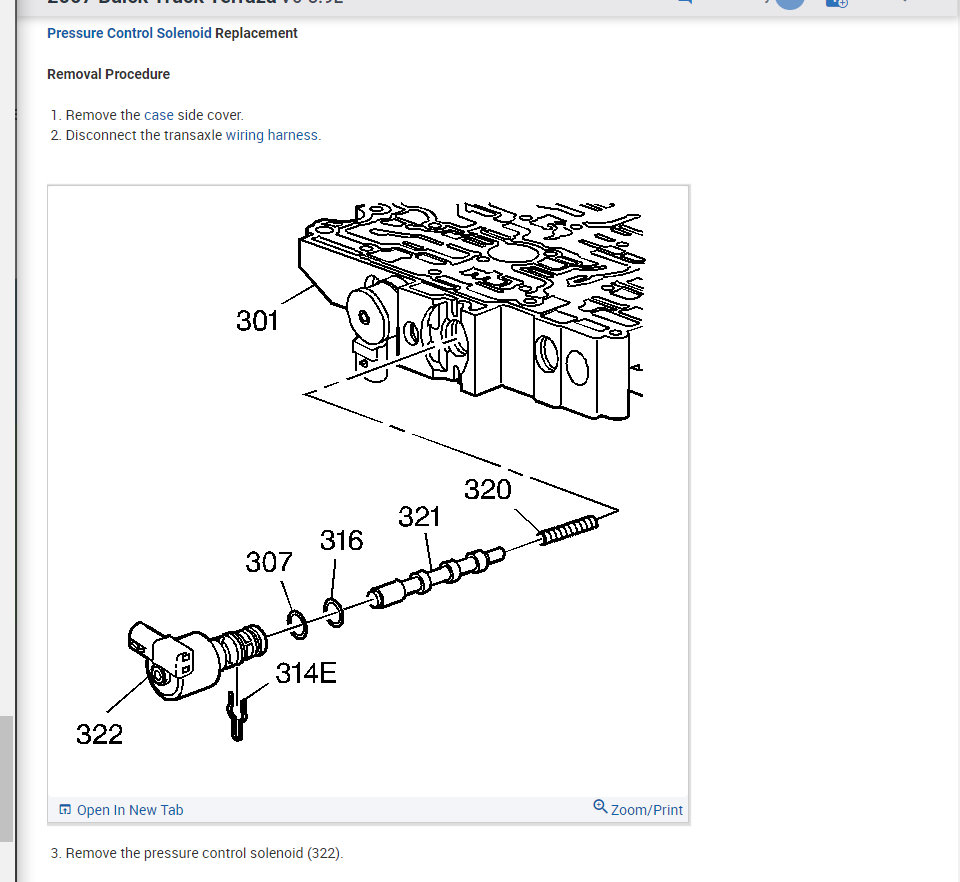

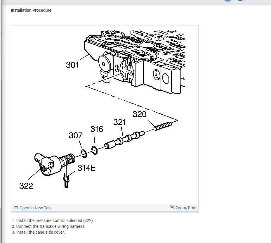

This is a pretty big job. You have to remove the pan, remove the valve body and then remove the faulty solenoid. I attached the valve body process above and will post the solenoid process below depending on which solenoid is the issue.
$1,400.00 does sound high so I suspect they are replacing all of them or the entire valve body. Do you have a copy of the estimate that they provided? Can you get a picture of their right up where they diagnosed it?
Please see the info below and let us know if you have questions. Thanks
