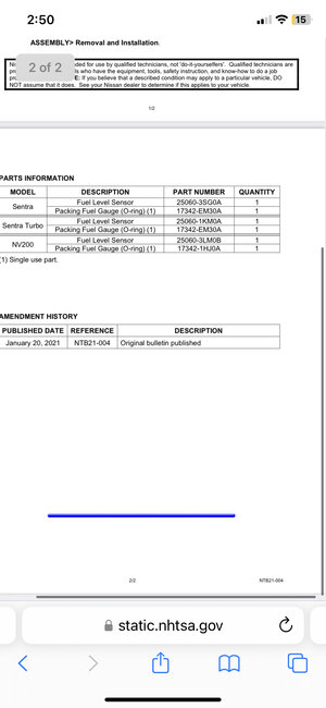

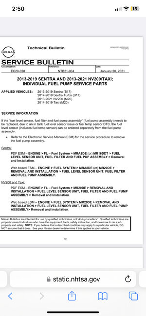

Just noticed this post. Sorry for responding to my other thread earlier today and mentioning the P0181 issue there. I will look for and check the evap purge valve, possibly this weekend. Note P0451 only shows up during more severe hesitation events usually along with P0181 and P0183. As I mentioned in the other thread, I have only seen P0181 the past couple weeks and it has been much less frequent (either due to cleaning the grounds or the cooler outside temperatures).
Regarding the fuel temperature sensor, I may replace that eventually if all else fails. I did find the attached bulletin so it looks like I could possibly replace the sensor without buying a new pump.
Oct 20, 2023 at 4:55 AM
SSCHELLATO
  • 18 POSTS
See attached.
