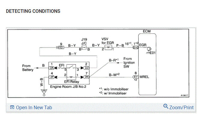

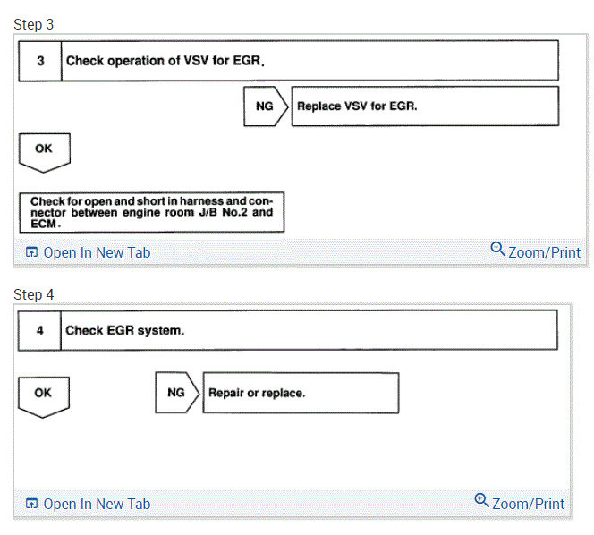

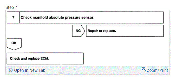

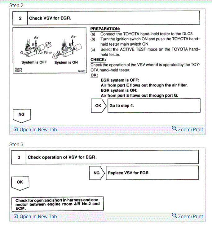

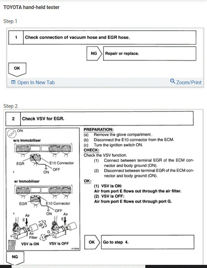

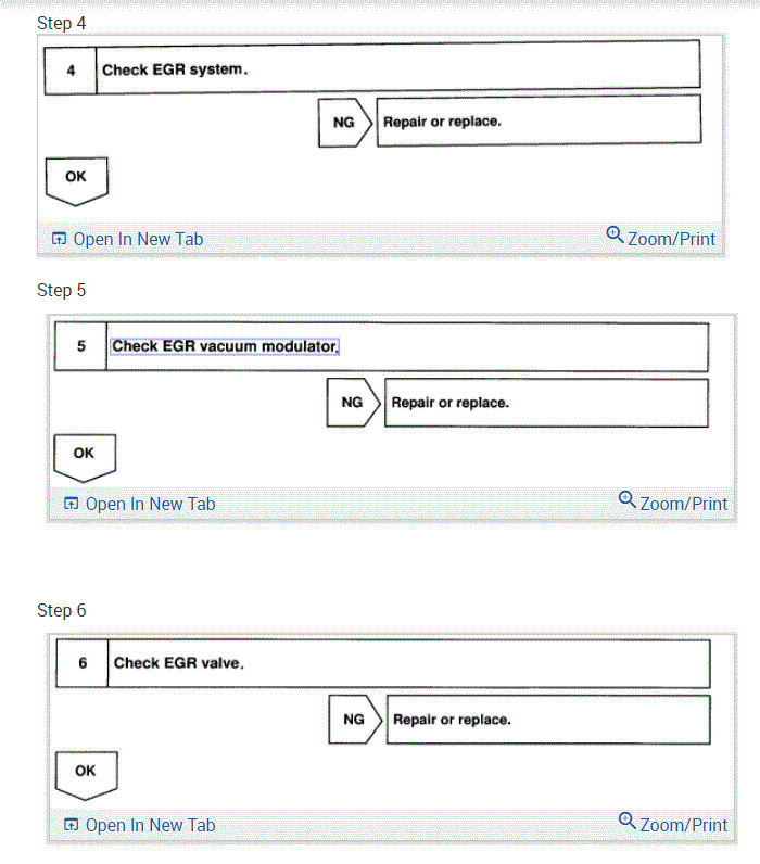

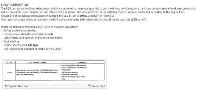

Interesting that the problem stops when the engine is cool. Under cold conditions, the EGR is shut down. So, it doesn't necessarily sound like the EGR is bad or sticking. I honestly suspect a vacuum leak. I could be wrong, but that is my first suspect.

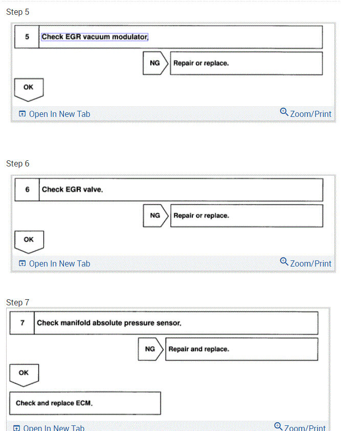

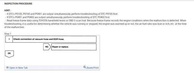

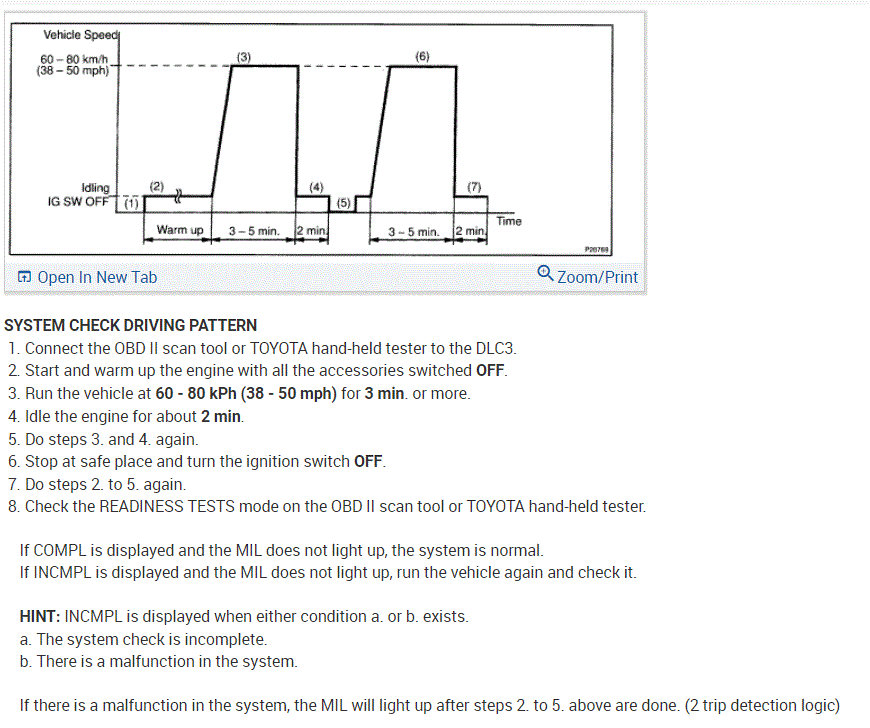

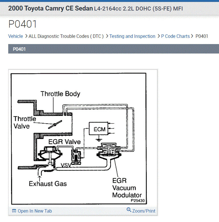

If you look below, I included the diagnostics for a P0401. They are extensive. Take a look through them and let me know if it is something you are comfortable doing.

Thanks once again for your reply and the images you sent, they were super helpful and informative.
Before this last message you sent, I noticed that the vacuum hose connected to the Q port of the EGR modulator was hanging loose, but because I didn't know where to connect it, I left it like that. But after seeing the schematic diagram of the EGR valve connections in one of the pictures you sent, I discovered that the hose was to be plugged into the VSV, so I plugged it back in. Also, I removed the EGR valve to check it's condition, it was still working, but had a lot of carbon deposits, so I cleaned it up and installed it back in.

Remember me? Trust you are doing well today. So sorry I haven't gotten back to you since regarding my car challenges, but I am happy to announce to you that those fixes we did actually fixed the problem. I also replaced the VSV switch. Now, the car runs normal and idles well. Thank you so so much, I really appreciate. You've been a great help. You the man Joe.
