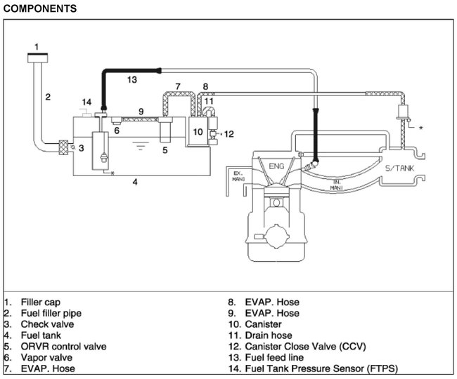

i just filled up my car to the brim. i noticed hesitation right away as i drove and when i stop it will sometimes shut off. when i put the car back in park and can restart it no problem. no check engine light is coming on. i have never had this problem before. did i get bad gas? Thank you, Julie Downs

Hi, Julie. When you say you filled it to the brim, that isn't always a good thing. When the pump first automatically shuts off, that is when you should stop. Since this happened since the fill up, if in fact you did over fill it, there is a chance raw fuel made its way into the evaporative emissions system. I hate to say it, but you need to drive it in a safe place until the gauge starts to drop to see if it takes care of itself.
Did you fill it to the top of the filler tube?

Joe, i did do exactly what you said. I normally do not fill completely as gas has gone back up in price, but i sure did this time. I will follow your advice. I am glad to hear from you as i am a 66 year old senior citizen who knows little about cars. I am relieved that this may correct itself. I will keep you posted. Thank you so much. Julie downs

Actually, I was worried you were going to run out of gas. LOL It seems to be improving. Put maybe a half of tank more in it and drive it out. If that doesn't help, we will need to start checking other things. Tell me, has the check engine light come on and stayed on with the engine running?
If it isn't on and the car continues to run poorly, we need to check what is called the charcoal canister. This canister is made to only have fumes in it. If it has raw fuel in it, that is most likely the problem. The canister is near the gas tank. I attached a picture showing the entire system. Note number 10 in the pic. We will need to disconnect it to see if there is raw fuel in it. But lets give it one more try.

Joe, I must be losing my dang mind. I DIDNOT mean empty, I meant full. I am so sorry to be such a dolt. I noticed this morning, that i am not at the 3/4 full line. No check engine light, thank heavens. Also the smell of gas seems to have dissapated. Julie

LOL!!! You sound like me. Not a problem. Just see if it goes away by the time you need to refuel. I was wondering how you went through so much gas so quickly. LOL I thought something was up when you said you thought it would never come off E. LOL Then you said it's just below E. That is why I was worried you would run out of gas.

Hey, Joe! The hesitating has all but stopped. And the dying out appears to be stopped. I am keeping my fingers crossed and being observant. I am not even at a half tank yet. As you know, the indicator stayed on F (not E) forever. Still no engine light, thank goodness. Most sincerely, Julie Downs

I had a feeling it would clean itself up for you. Next time you fill the tank, as soon as the pump clicks off indicating full, don't add any more.
