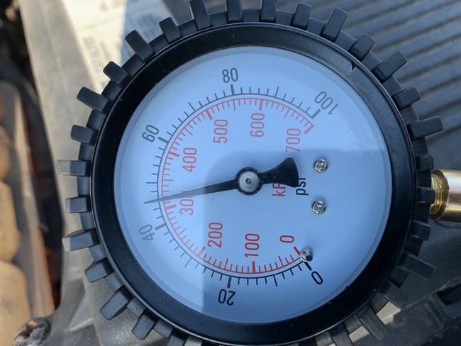

MJWILLIAMS95
46psi. Looks like I’m doing a pump.

Hello again.

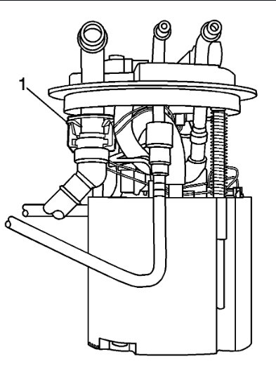

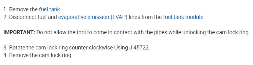

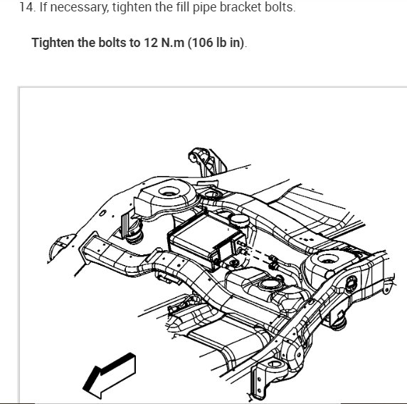

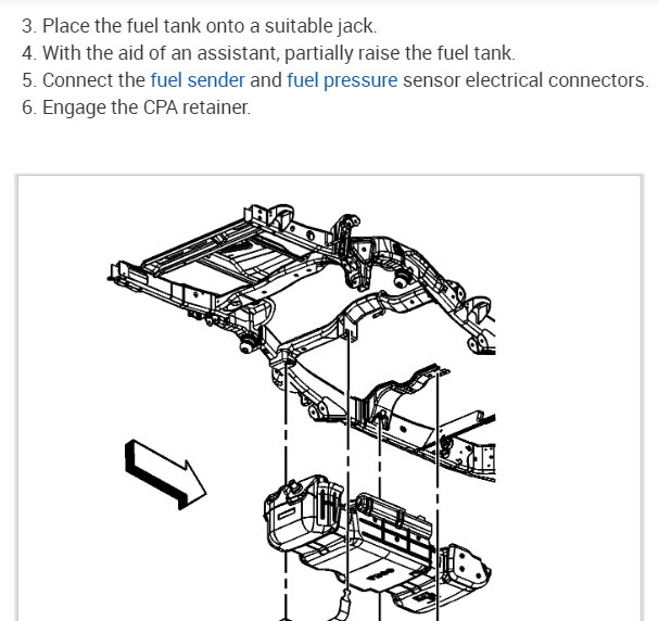

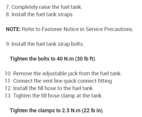

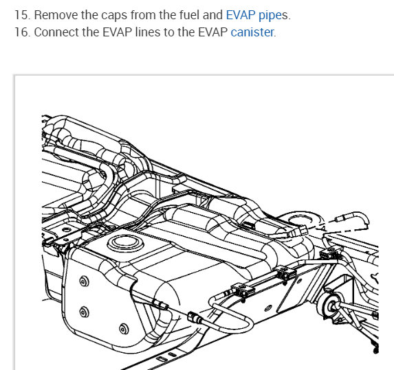

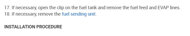

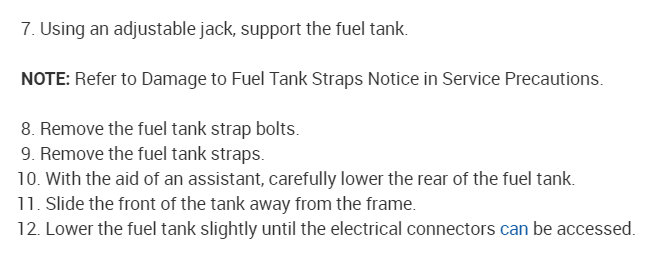

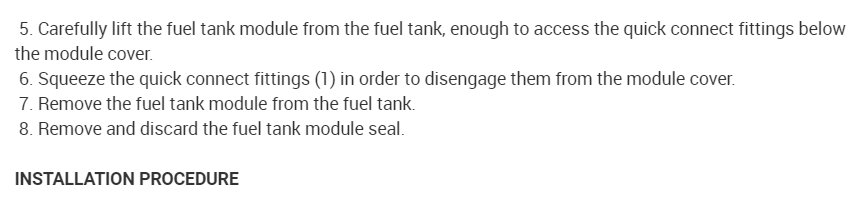

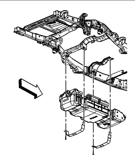

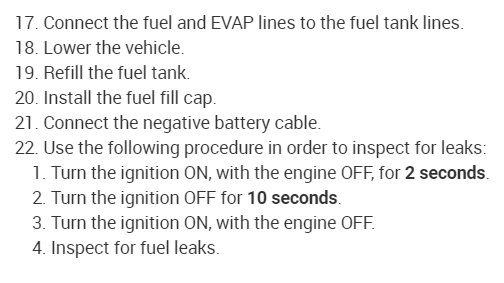

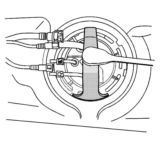

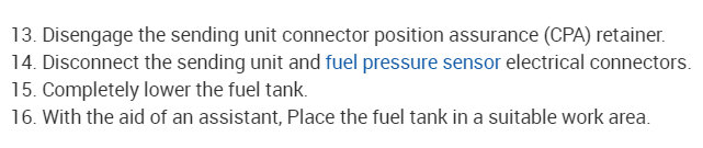

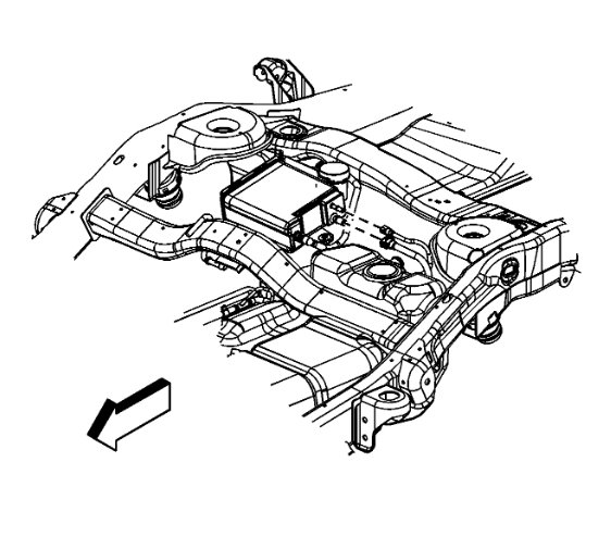

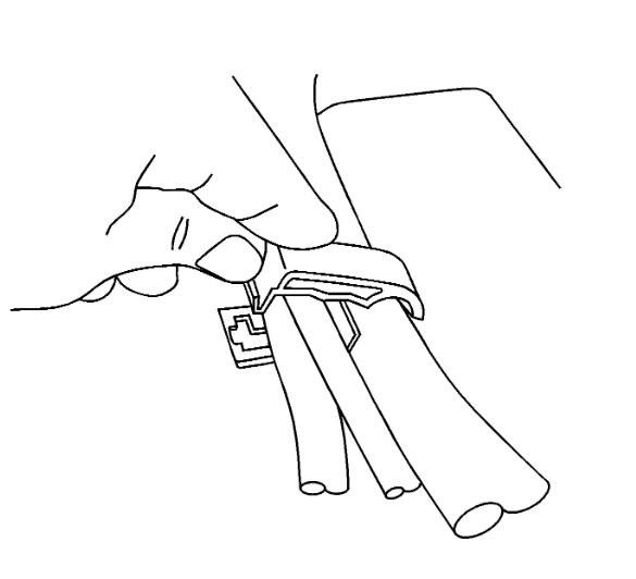

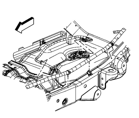

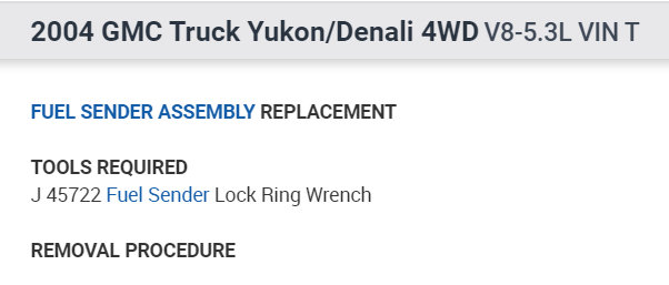

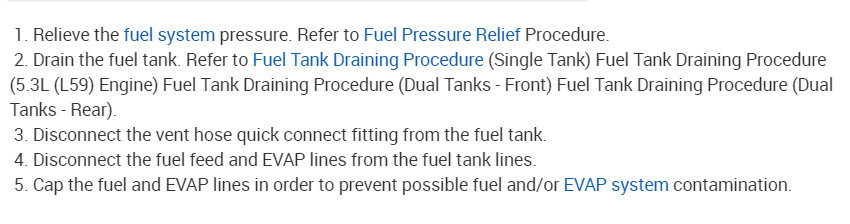

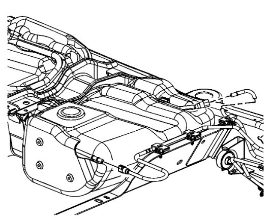

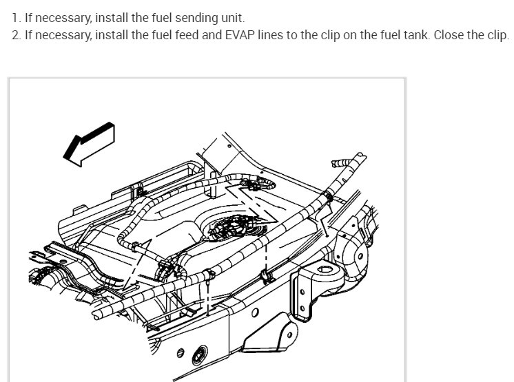

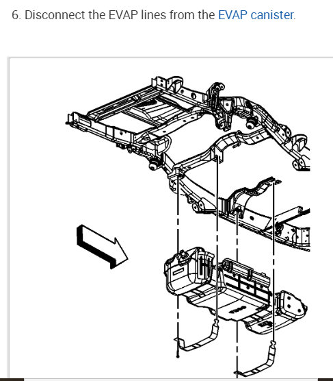

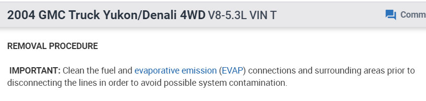

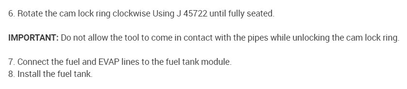

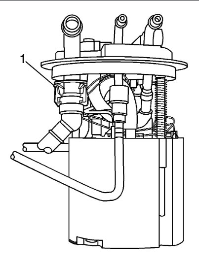

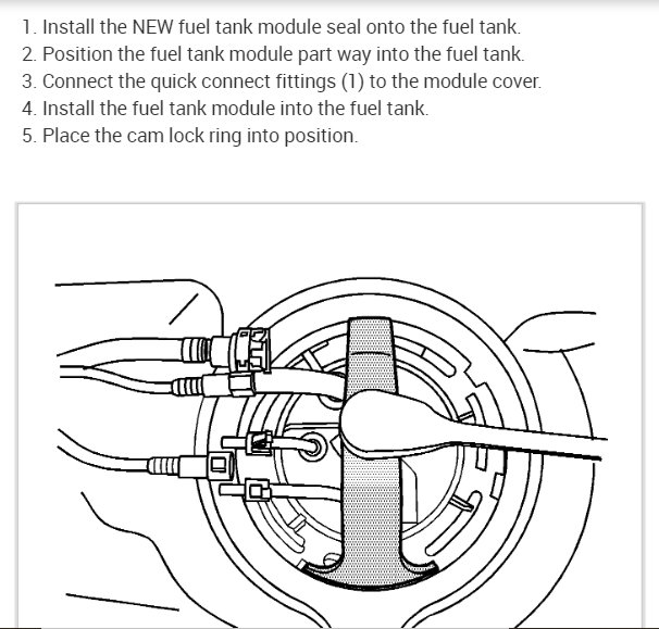

Yes, seems your pressure is below specification.That would definitely cause stalling and hesitation.Here is a tutorial showing what is involved for an in-tank fuel pump replacement:
https://www.2carpros.com/articles/how-to-replace-an-electric-fuel-pump
I've attached picture replacement steps below on removal of fuel tank and the removal of fuel pump for your vehicle.Let me know if you have any further questions on this issue.Hope this helps and thanks again for using 2carPros.
