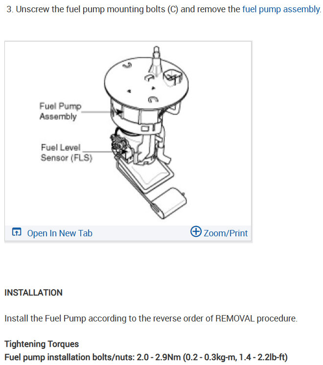

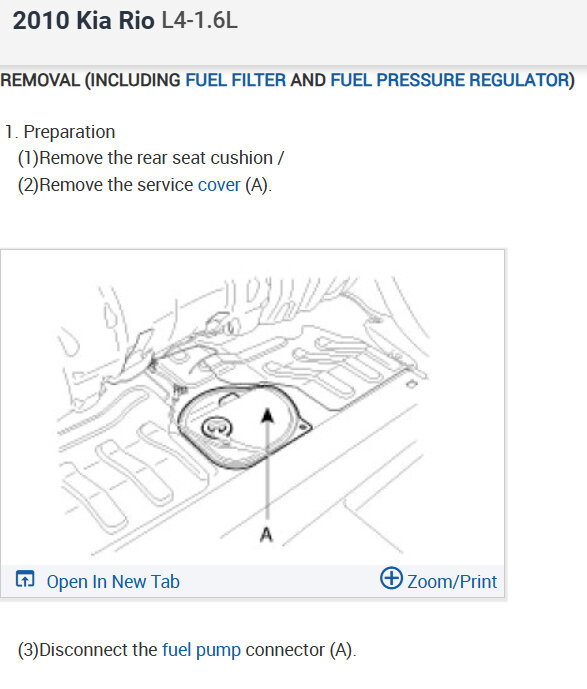

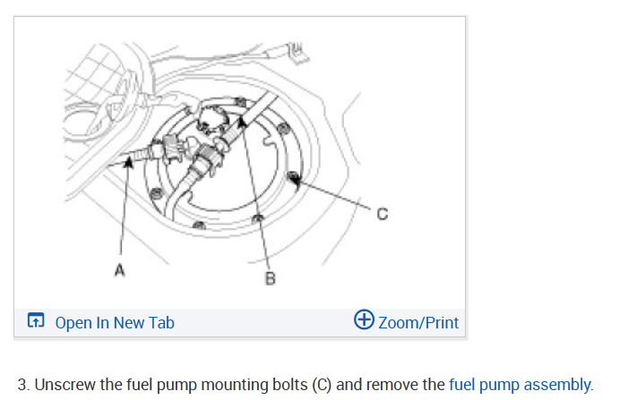

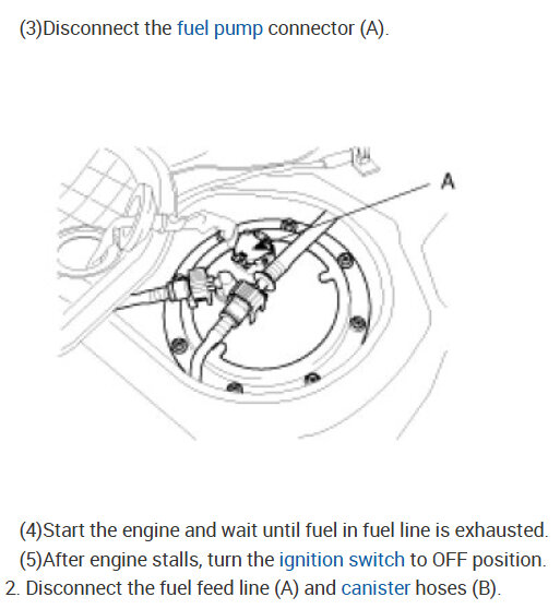

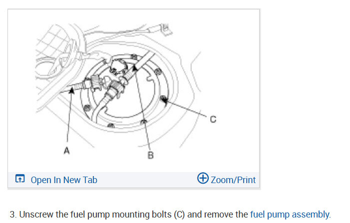

If there are no warning lights, I would check the air filter. If that is okay, I would swap out the fuel pump which I have seen get weak and not allow the engine to get full power. Here is how the job is done. Check out the images (below). Please let us know what happens.
