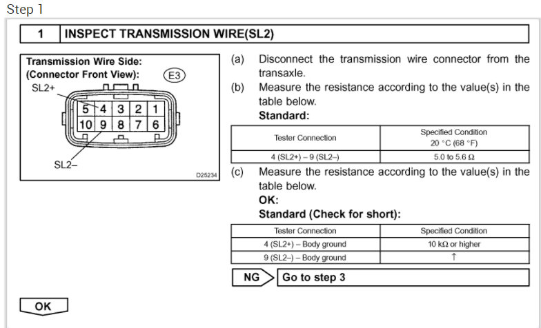

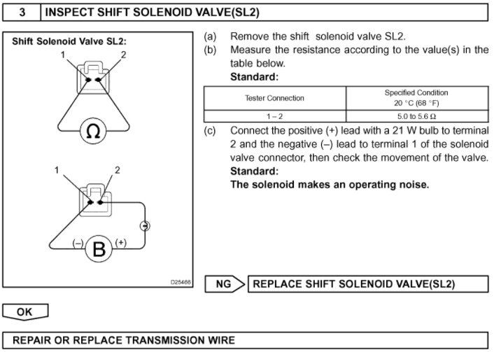

Hi, the vehicle hesitate while accelerating. I scanned the vehicle, the only code found was P0778 (pressure control solenoid B). I drained out the transmission oil and loosen all the necessary bolts for me to access the solenoids. The oil was smelling like burnt oil. I removed the connector to the solenoid and tested each of the solenoid using battery (I don't know the exact solenoid), they seems to function well mechanically (coming in and out). I fasten all the loosen bolts, replaced the transmission oil and test drive the vehicle but there was no improvement, the problem persist, LoL. What else could I do?
The way I tested the solenoid, is it the best way to tested?
Dec 6, 2020 at 10:35 AM
DANNY L
  • 5,648 POSTS
Hello, I'm Danny.

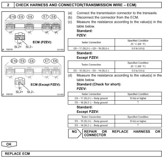

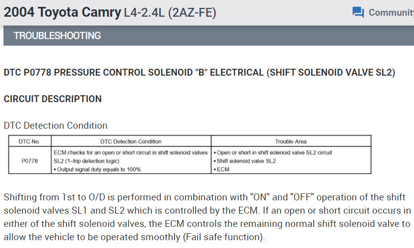

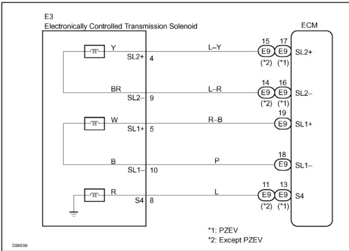

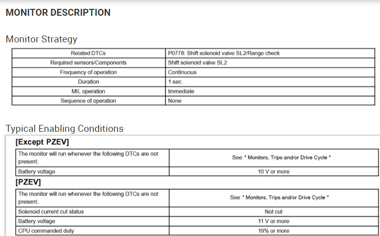

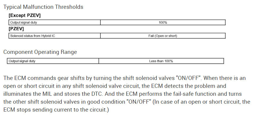

Here are repair guides to properly test the entire system relating to the code P0778. Just applying voltage to the solenoid doesn't ensure that is the problem. Those solenoids are controlled by the ECM- engine control module as well. I've attached the picture diagnostic steps below for your car. Hope this helps and thanks for using 2CarPros.

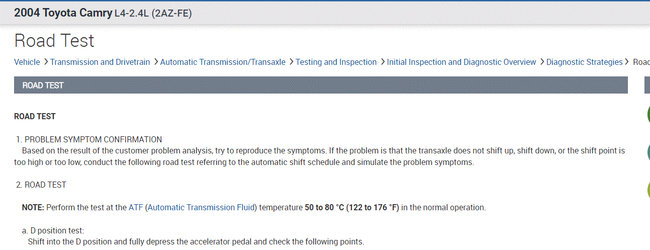

Good morning, sir, please could I get road test parameters.
Sep 28, 2021 at 11:27 AM
  • 110,248 POSTS
I noticed it has been a couple of days since you've been contacted. Let me know what parameters you are looking for and I'll try to get them for you.
Sep 30, 2021 at 12:37 PM
BLESSING EWOBOR
  • 753 POSTS
Good morning, sir. I mean road test rest on the transmission indicating the speed at which the transmission has to shift into different gears.
Oct 1, 2021 at 12:14 PM
  • 110,248 POSTS
I don't ever remember seeing something that provides a speed for an automatic to shift. There are many variables that cause it to shift at different speeds.
I will ask the site owner to see if he has heard of one.
Oct 2, 2021 at 11:24 AM
BLESSING EWOBOR
  • 753 POSTS
Good evening, sir. maybe you don't understand what I asked.
Procedures for road test.
Oct 2, 2021 at 12:34 PM

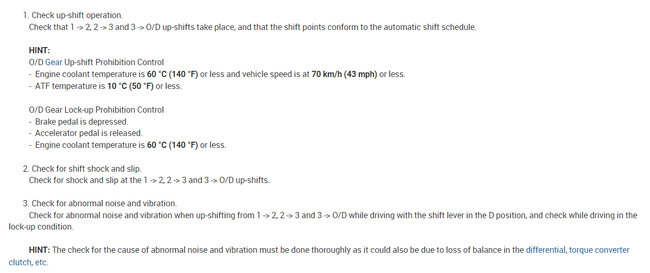

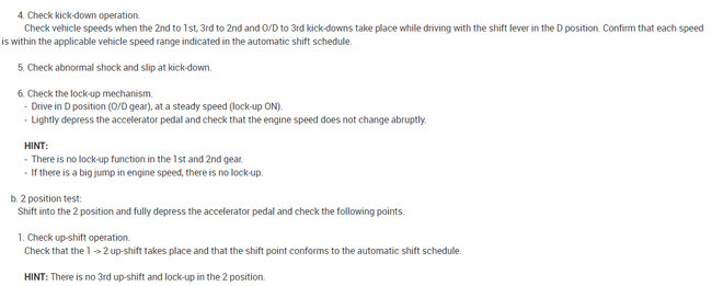

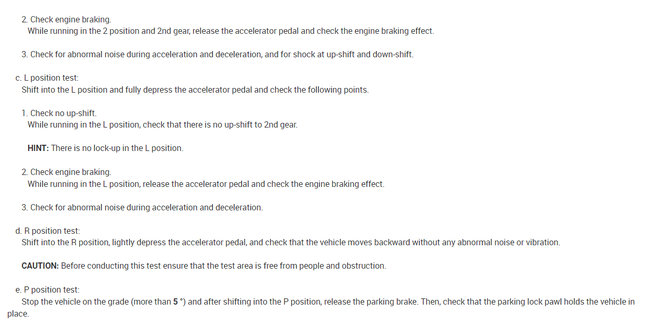

  • 110,248 POSTS
Take a look below and let me know if that is what you needed.
Oct 3, 2021 at 10:09 AM
