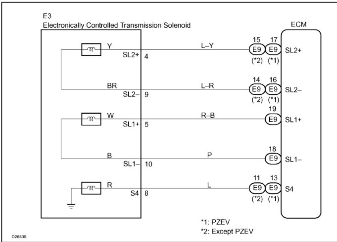

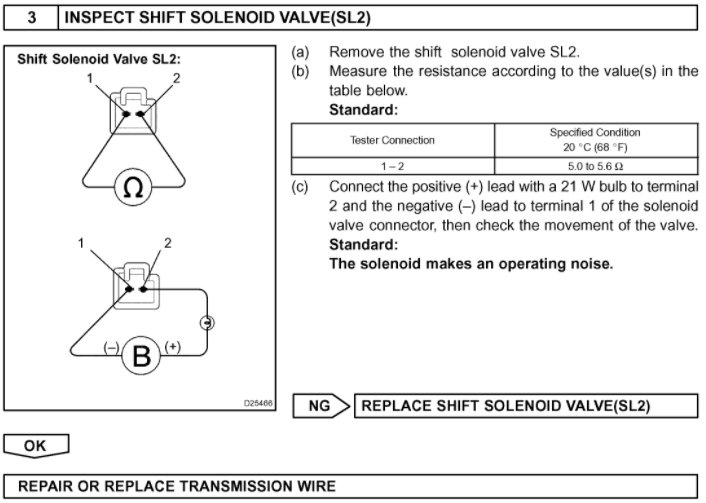

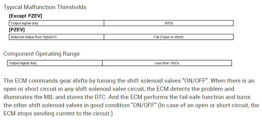

Hi, the vehicle hesitate while accelerating. I scanned the vehicle, the only code found was P0778 (pressure control solenoid B). I drained out the transmission oil and loosen all the necessary bolts for me to access the solenoids. The oil was smelling like burnt oil. I removed the connector to the solenoid and tested each of the solenoid using battery (I don't know the exact solenoid), they seems to function well mechanically (coming in and out). I fasten all the loosen bolts, replaced the transmission oil and test drive the vehicle but there was no improvement, the problem persist, LoL. What else could I do?
The way I tested the solenoid, is it the best way to tested?

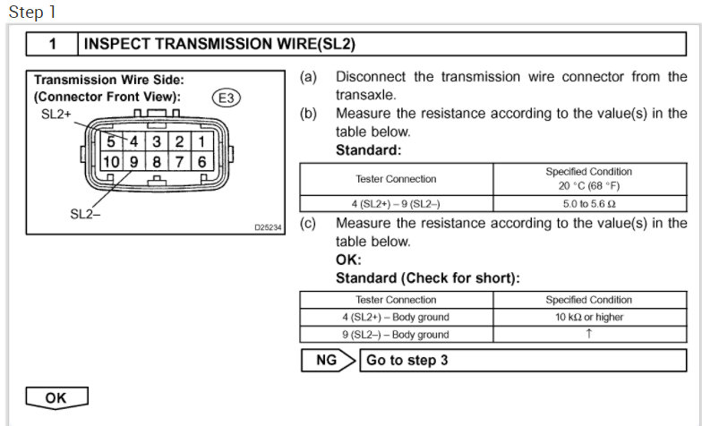

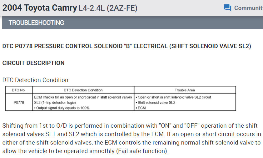

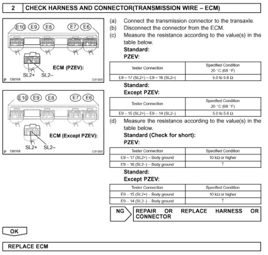

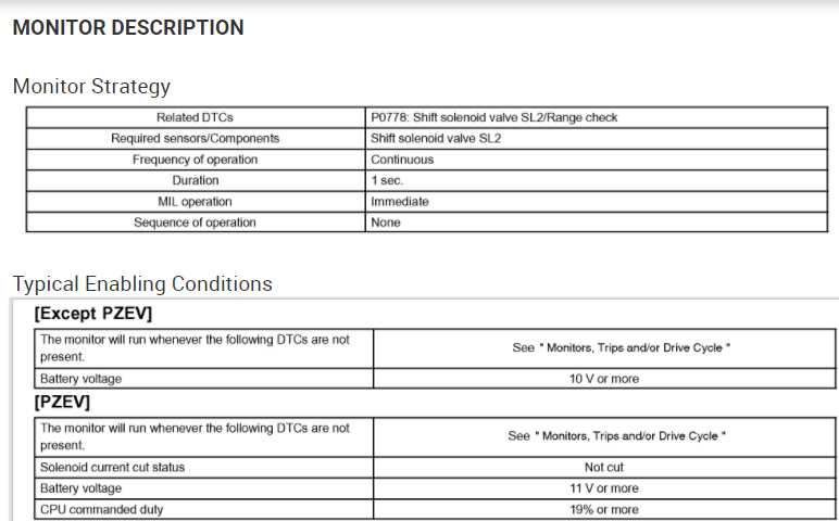

Here are repair guides to properly test the entire system relating to the code P0778. Just applying voltage to the solenoid doesn't ensure that is the problem. Those solenoids are controlled by the ECM- engine control module as well. I've attached the picture diagnostic steps below for your car. Hope this helps and thanks for using 2CarPros.

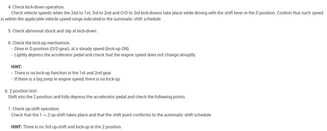

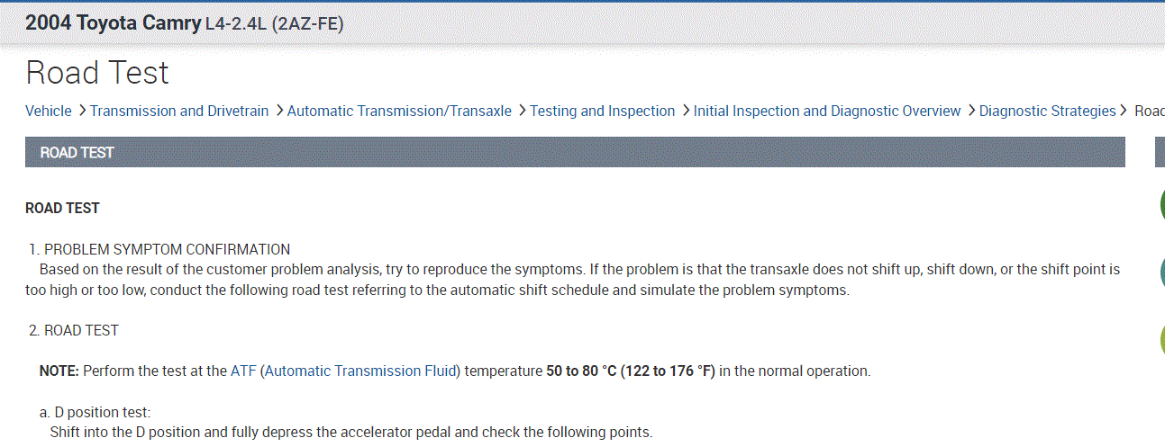

Good morning, sir, please could I get road test parameters.

Good morning, sir. I mean road test rest on the transmission indicating the speed at which the transmission has to shift into different gears.
Oct 1, 2021 at 7:14 PM
  • 110,194 POSTS
I don't ever remember seeing something that provides a speed for an automatic to shift. There are many variables that cause it to shift at different speeds.

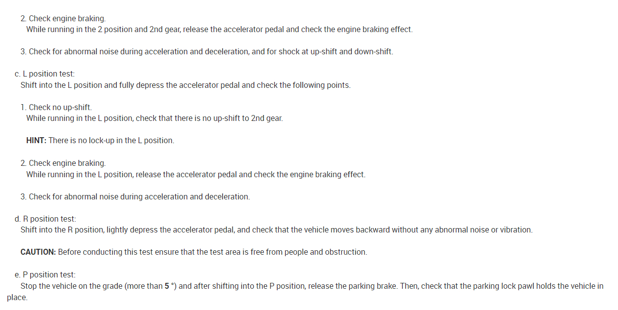

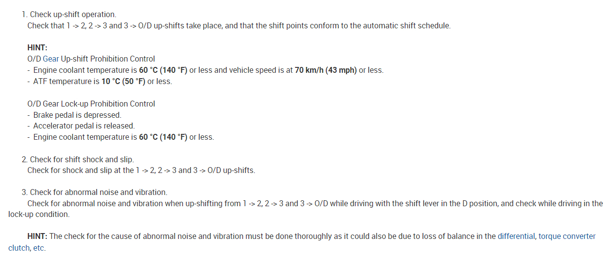

Good evening, sir. maybe you don't understand what I asked.
Procedures for road test.
Oct 2, 2021 at 7:34 PM
  • 110,194 POSTS
Take a look below and let me know if that is what you needed.
Oct 3, 2021 at 5:09 PM

Sir, if you refer to the first diagram it was saying something like automatic shift schedule. I don't know if you have that sir.

  • 110,194 POSTS
I'm sorry. I don't have the shift schedule. I never remember seeing one in the past. As far as the transmission, it is a U241E, a 4-speed automatic transmission.
If you look at the attachment below, that is the only reference I have for shift points/schedules.
See pic below.
