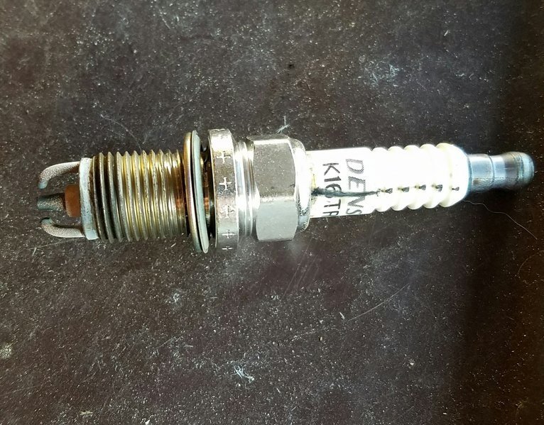

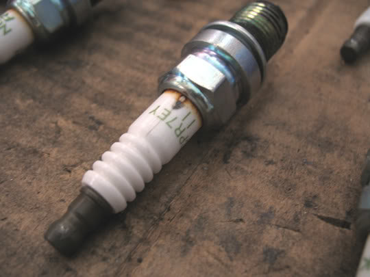

Okay, I'm going to give you the quickest and easiest way to check this. First, pull of each spark plug wire boot at the plug and see what kind of spark you have. It should be loud and at least an inch long spark when you put it over a metal surface. Sometimes these coils get weak and will barely or not even produce a spark. If all of them look the same, while everything is reconnected, spray the plug wires and boots with water and look for any arcing out the side of the wire or boot, you should have someone power brake it also to put a load on the ignition system. If this does not show anything, remove the plugs and inspect the porcelain for cracks. There you have it, easiest to hardest but none of them are that bad! I always find one or more things wrong when I do this testing.
