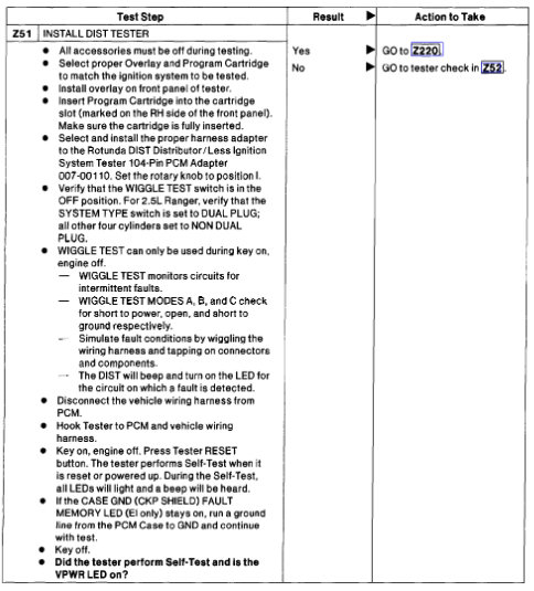

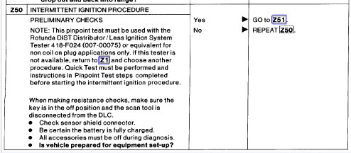

I've attached picture step flow charts below to help with P0303 cylinder 3 misfire. Hope this helps and let us know what you find. Thanks again for using 2CarPros.
