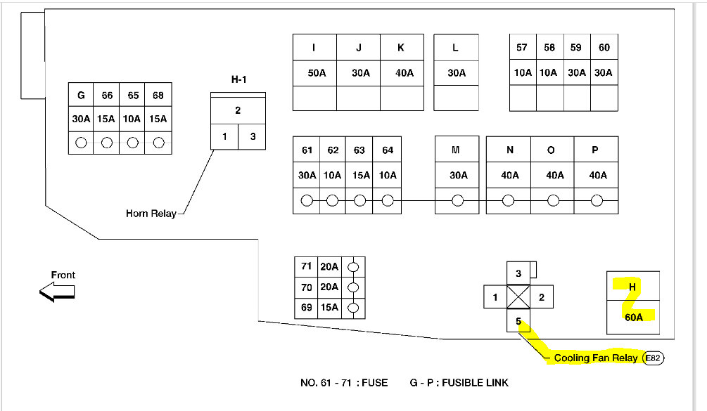

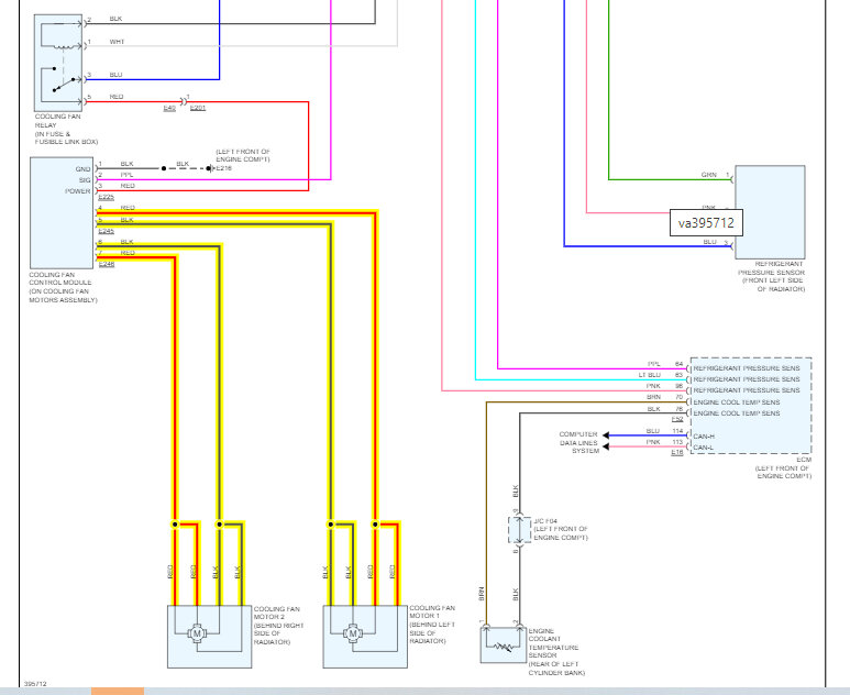

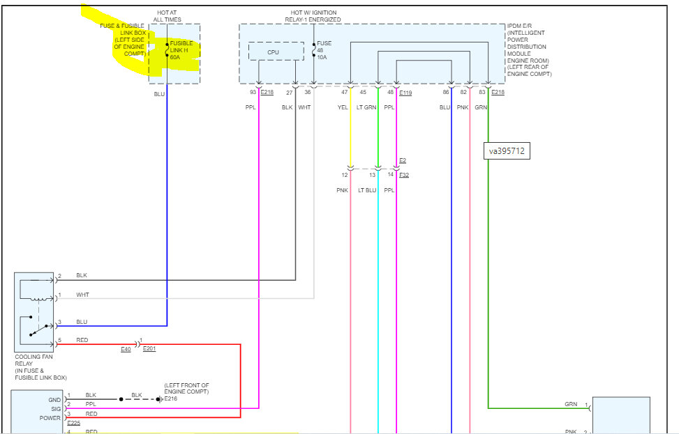

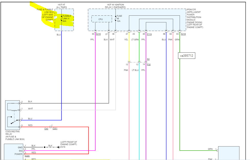

I attached a wiring schematic below for the radiator cooling fans. There is a fan control module that is part of the circuit. (Pics 2 and 3)

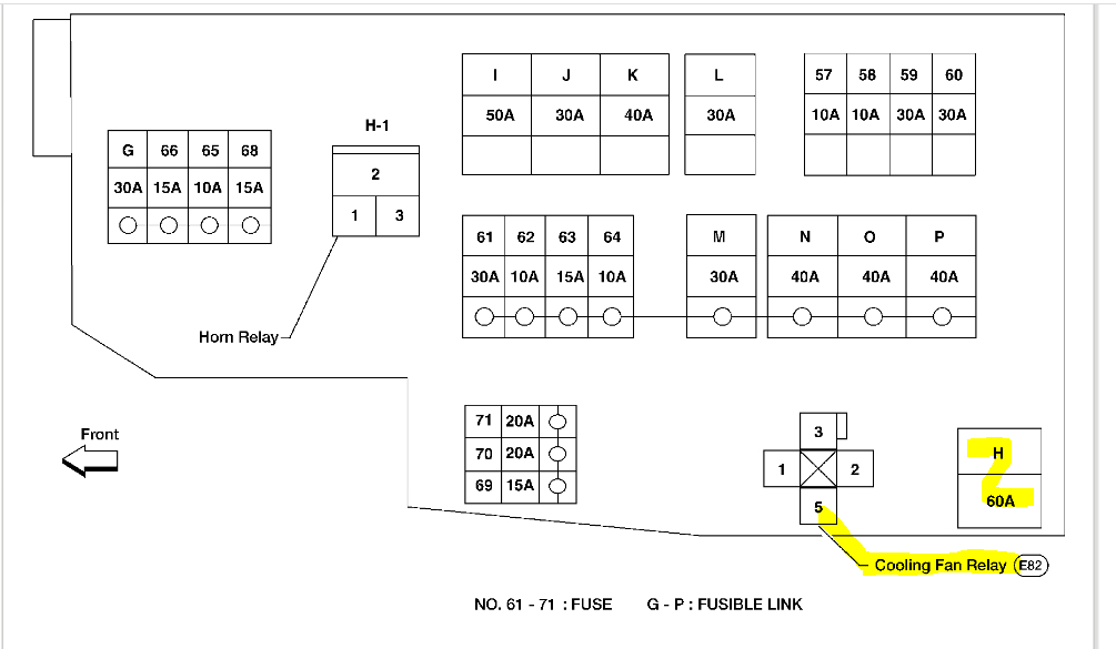

We need to start by checking fusible link H. If you look at pic 3 below, I highlighted its location in the under-hood fuse/relay box. Confirm that is good. Also, make sure there is power both in and out of it.
If that is good, go to the cooling fan relay. See pic 3. Note numbers 1, 2, 3, and 5 are indicated on the relay in the pic. Remove the relay and locate pin 3. That connector should have power at all times. Confirm that for me.
Let me know what you find. Also, let me know if the fans were making any strange sounds prior to the issue.

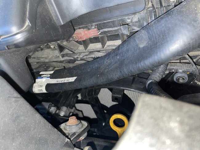

Okay. So, all of these things have been checked. Relays even switched just in case. I resorted to getting a new radiator fan and a new hose. My hose is right now flat. Brand new hose. Still no change? Help!!!!

I see the hose issue. That can be caused by a few things. Obviously, there is a vacuum in the system. The vacuum can be from low coolant, a loose radiator clamp that allows air to be drawn into the system, or even a faulty radiator cap that is preventing pressure from building in the system.

If you have power at the relays and a ground source, then the next thing is to see if power is available at the fan motors. From the relays, it goes to the motors. If there is power and ground, the fans should run. So that is the next check.
If there is no power, then the wiring between the relays and fan motors is open.
