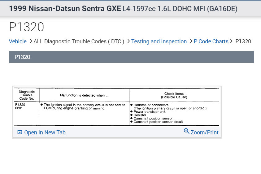

Code P1320
1999 NISSAN SENTRA
240,000 MILES • 1.6L • 4 CYL • 2WD • AUTOMATIC
IGGIE HARM

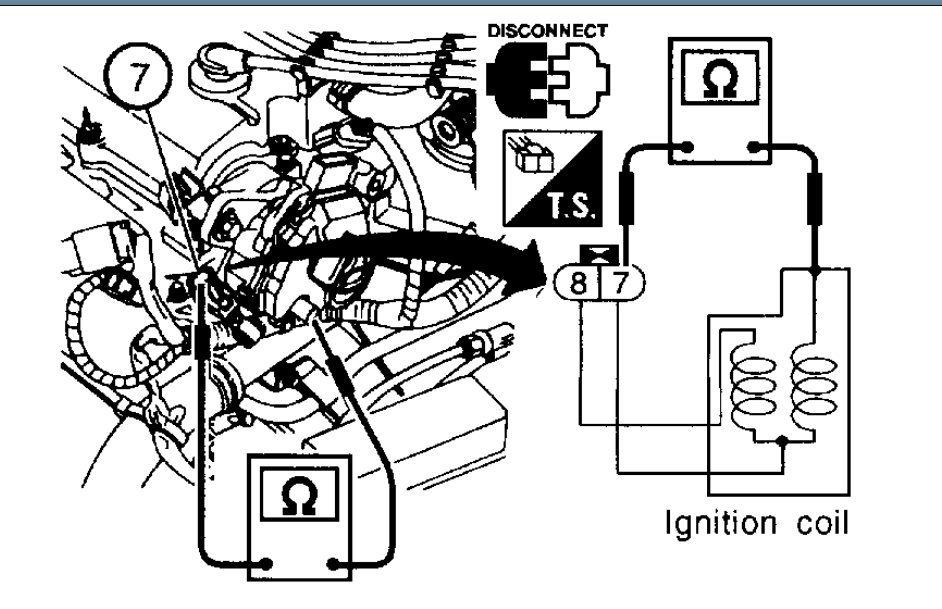

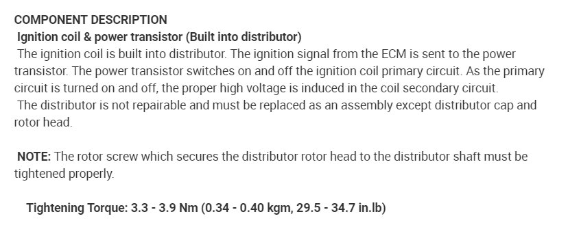

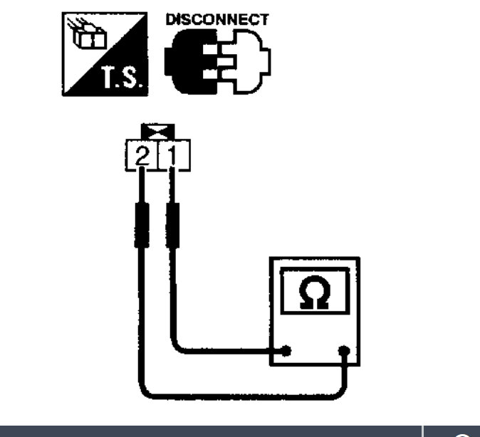

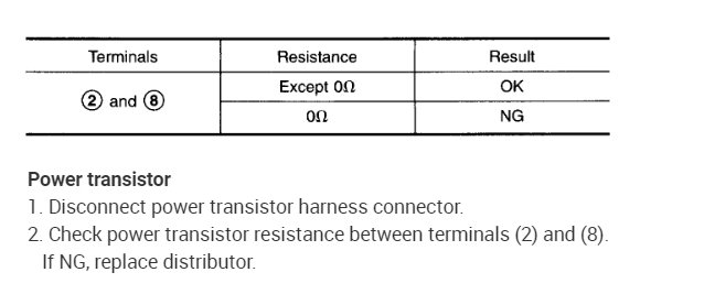

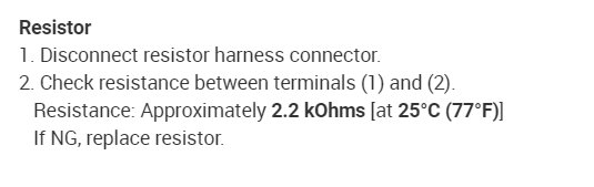

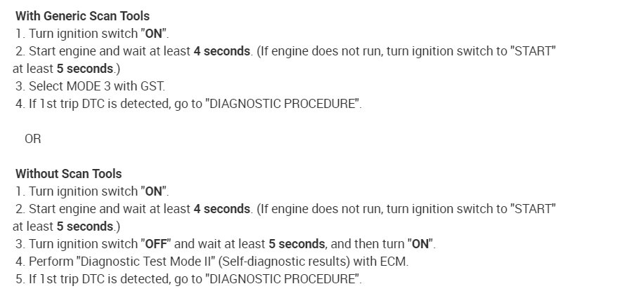

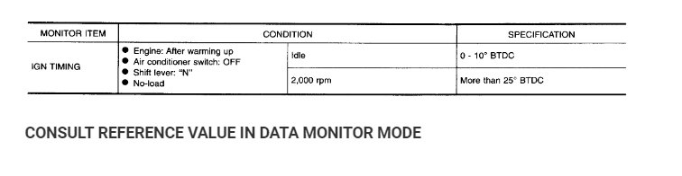

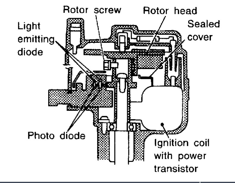

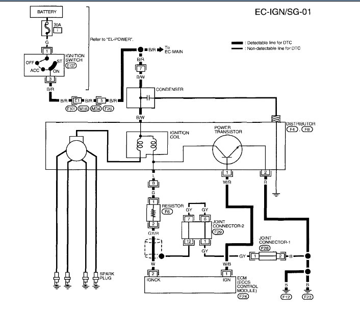

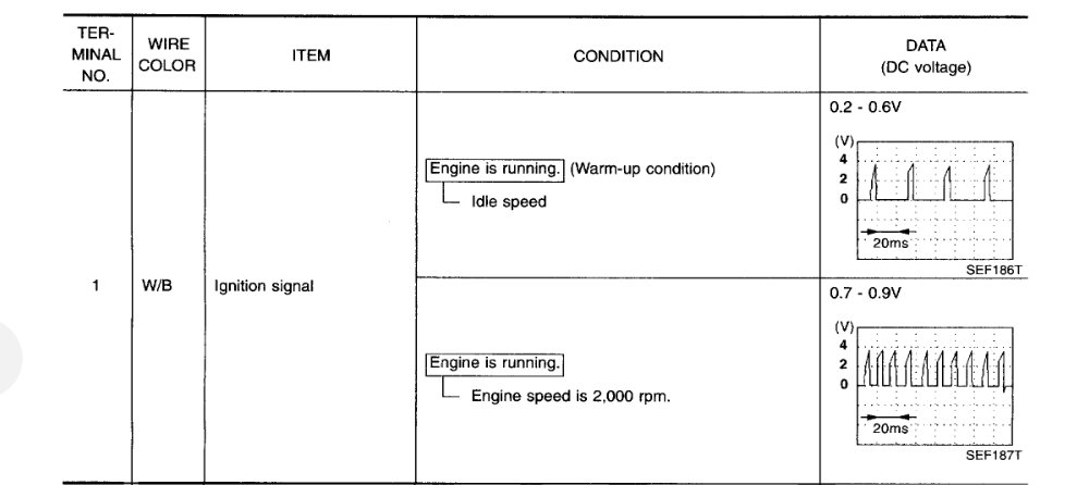

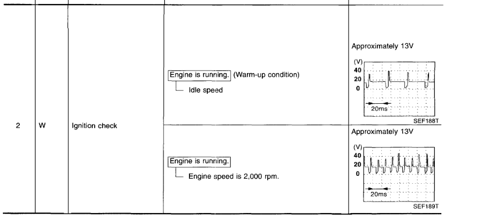

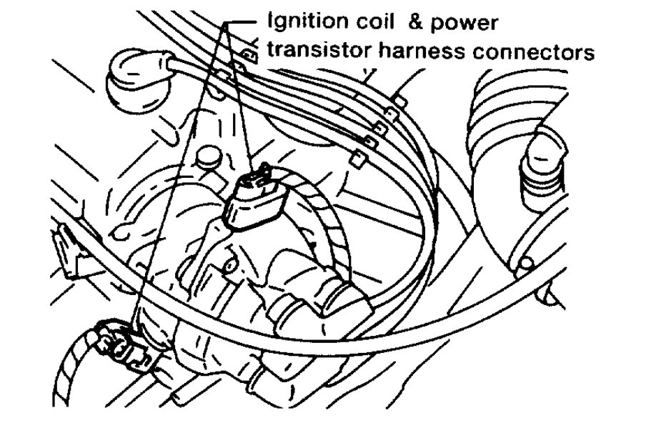

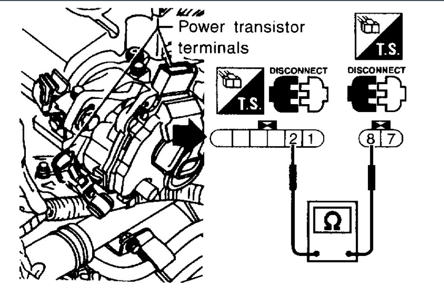

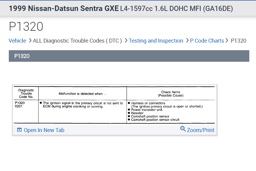

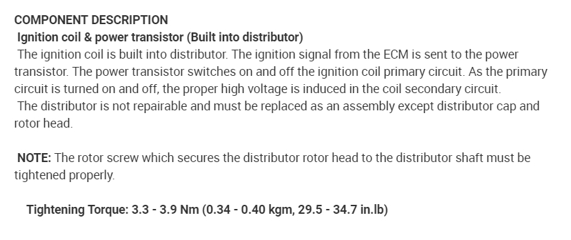

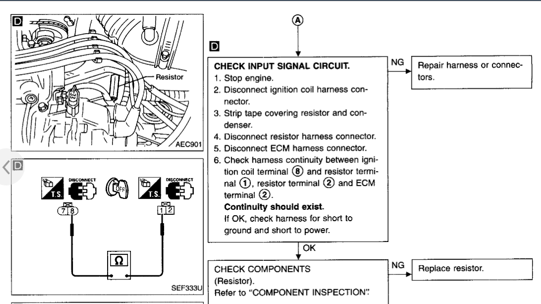

I have the car listed above GXE model. I keep getting the code P1320 and cannot seem to find the problem. I cannot seem to find the ignition condenser. would anyone be able to help me please? Thank you :)
Apr 3, 2019 at 8:59 AM
SCGRANTURISMO
  • 4,897 POSTS

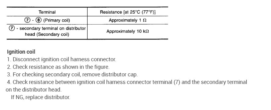

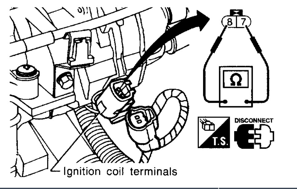

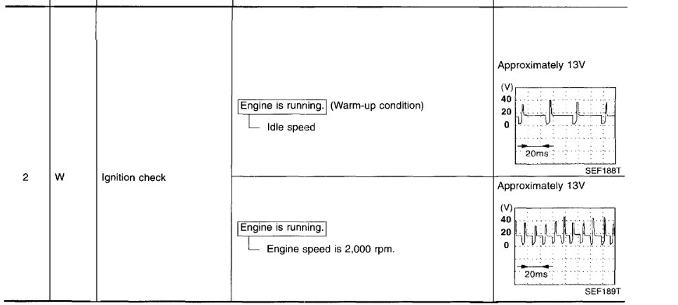

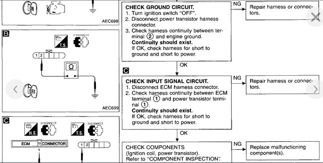

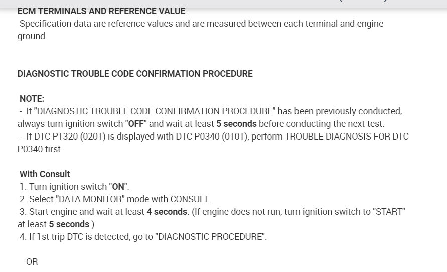

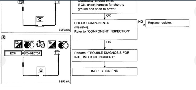

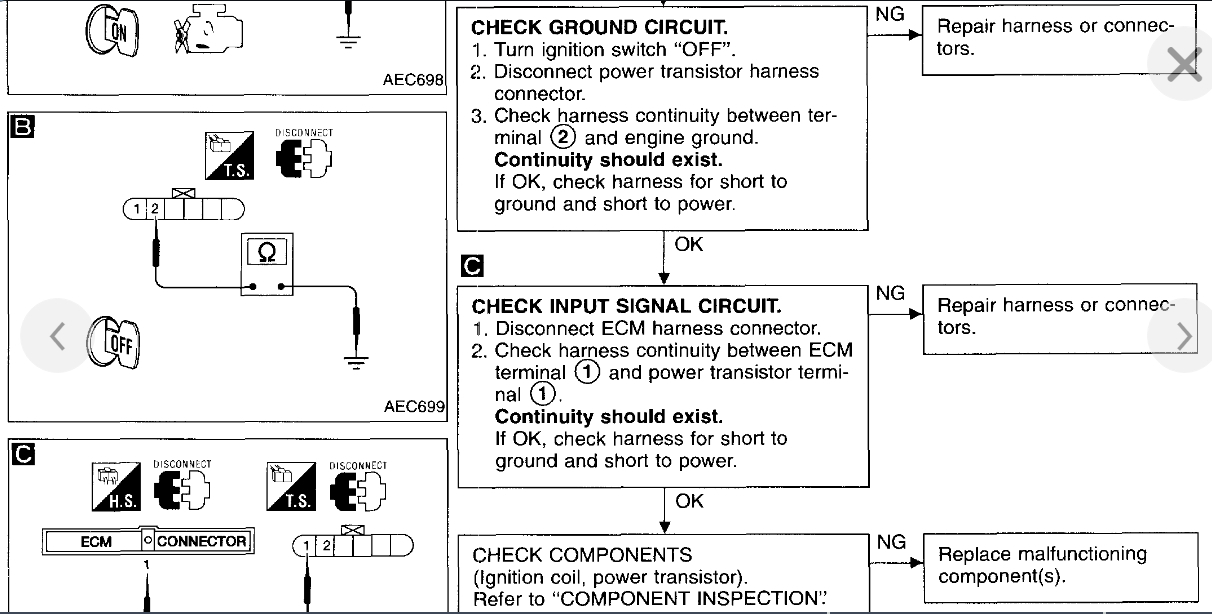

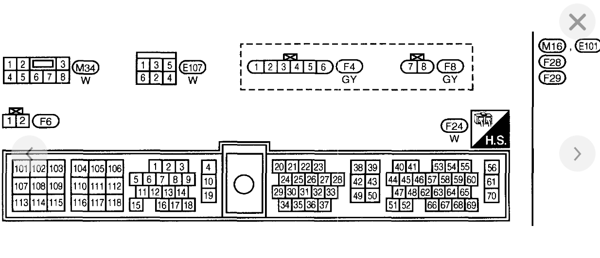

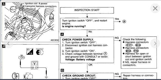

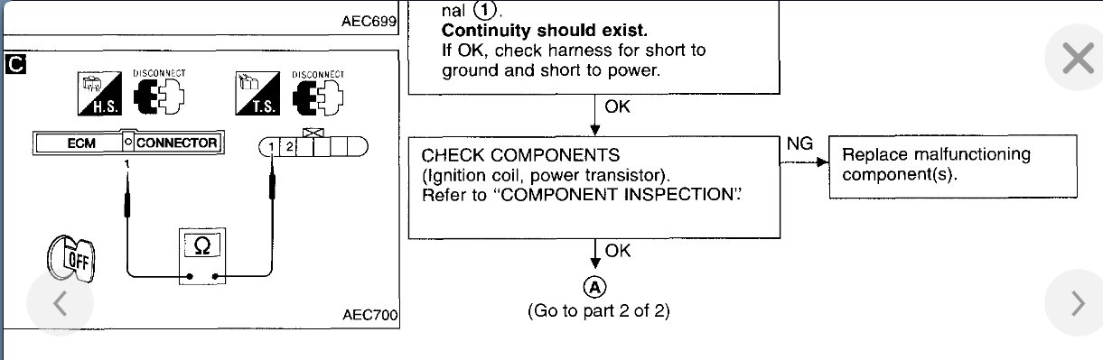

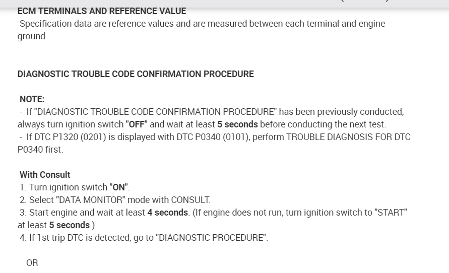

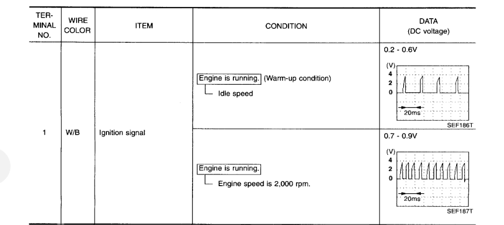

I have included all the information that you have requested in the diagrams down below. Included is a factory diagnostic troubleshooting guide to track down exactly what is going on with your vehicle. You will need to use a scan tool and a multi-meter. If you are unfamiliar with how to use a multi-meter I have included a link below for you to go to:
Please go through these guides and get back to us with what you find out.
