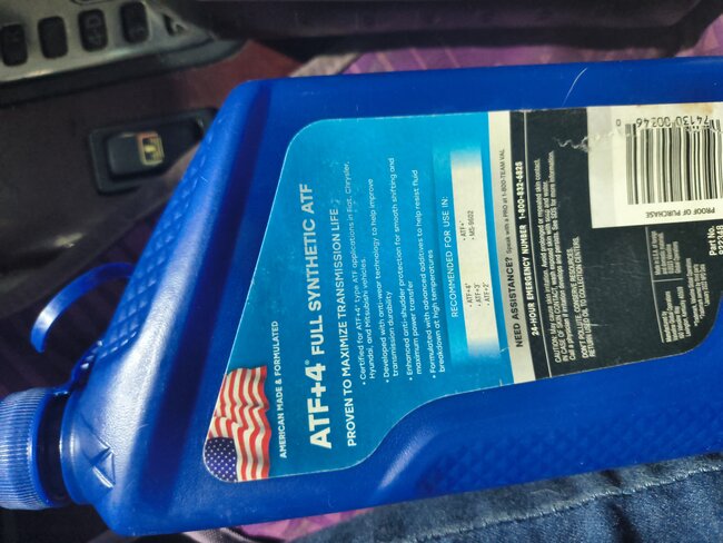

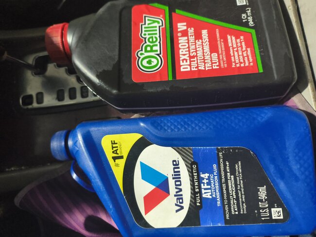

My ex told me transmission fluid was leaking from CVS axle seal and it was low when I checked it.I was in a hurry and remembered it called for Toyota (t4) fluid &I guess I just seen the 4 on Valvoline synthetic ATF+4 and grabbed it. It's shifting super hard and erractic now and I'm not sure what to do. Iv also read you shouldn't drain them with this many miles (220000) so I'm not sure should I just leave it ,try to drain a little refill or try to flush .Iv been driving it like that so pretty sure it's mixed in good it's shifting really hard now so I'm worried I really messed up.like it with buck pretty hard when accelerating from a stop,and you have to let off of the gas to let it catch.Im including pics of both fluids the blue one is the accidental one.let me know what you would do pls. thanks
Feb 13, 2026 at 9:52 AM
  • 55,433 POSTS
Yes, you need to have the correct fluid and it sounds like you need to flush the system and add new fluid that is the correct kind.
Correct fluid spec: Toyota Type T-IV (NOT ATF+4)
ATF+4 and Toyota Type T-IV are not compatible fluids.
The transmission is not damaged, it just needs the correct fluid, remove the pan, this will drain about 4 quarts and then read the correct fluid to see what happens, you might need to do this more than once. FYI. Please let us know what happens.

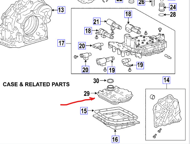

Hi I'm going to the work tonight for sure I know that it has reported there's a couple very inconvenient bolts to reach when dropping the pan so you got to lift up the transmission couple inches I don't know how true that is but from whatever research that's what it says also I've gotten the internal filter the internal main filter and the gasket brand new off of Amazon so I'm planning on replacing those but the last post was the little unclear with the inline post situation it's not an inline filter situation it's definitely an internal if you could clarify I'd really appreciate it thank you so much
Feb 23, 2026 at 8:35 AM
  • 55,433 POSTS
Sure, sorry about that, this car does not have an inline filter, the filter is in the pan, I would try a 1/4 inch drive universal socket to get at the pan bolts, they fit into tight spots better. Here is an image of the filter so there is no confusion of what you are doing. Please upload a short video in your response of the problem, so I can see what's going on. Check out the images (below).

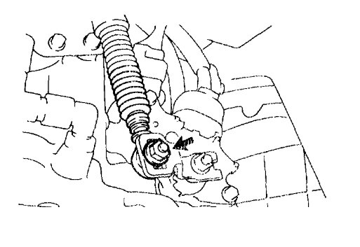

Ok so it will not want to go in drive but will go forward in neutral or reverse also very stiff shifter and even when put in 2nd or low it will only go down to 3rd gear.shifter cable diagram? Iv had trannys go out before but not like this.it unfortunately had a small fire under hood other day I got it out pretty quickly with fire extinguisher and towed home but does probably complicate things.any ideas on what could be up with this
Feb 28, 2026 at 10:57 PM
  • 55,433 POSTS
Yep, you may have found the problem, if the shift cable is locked up it will cause this problem. Set the parking brake or block the tires so the car does not roll. Then remove the shift cable from the transmission and have someone watch as you move the shifter, it should be super easy to move and travel freely, if not the shifter cable is bad. Mark the adjustment of the cable, also make sure the jam nut on the cable is not loose. Thanks for the video, it helps. Check out the images (below). Ken
