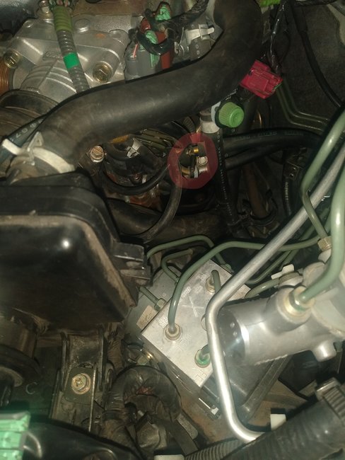

There is a metal tube that is not connected to anything nor covered. It's a y connection from my fuel pump to my air intake, to the engine.
I'm having acceleration issues and was checking for leaks. What is this, where does it connect to and is it supposed to be open?

Here's a photo...

It is little difficult to see the hose from the picture.
It should be vacuum hose.

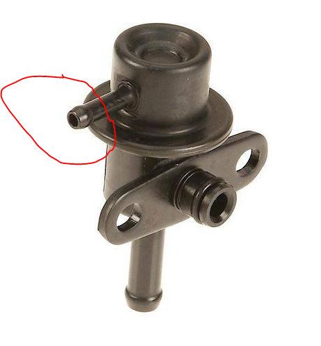

Possibly for the fuel pressure regulator.
Start the engine and see if there is any suction on that hose.
